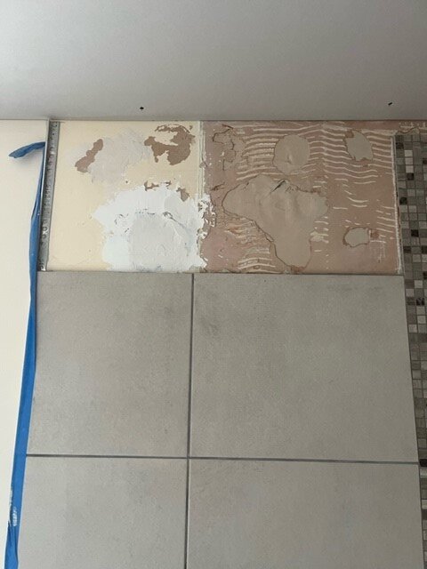

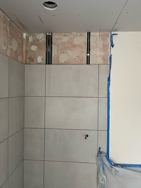

I insisted on overboarding the ceiling due to the slither that I spoke about on a previous post. I have attached some pics. The white patch is a hole that I filled where a fan used to reside. If I had known that the repair method was going to be to tack a tile over the hole, I would have fixed the underlying breeze block properly.
Still, I am alarmed that a tile could be securely tacked onto the wall with a hole in the corner, and that most of the tiles have been laid over emulsion anyway.
I'm not sure if it OK to tile over a gap for the shower pipes (the top being visible in the pic).

Your patched fan hole is now absolutely fine.
Yes you can tile over a pipe chase, but I don’t like to see it so close to the edge of the tile - better away from the edges. If it’s a solid wall it could be filled easily and that is what I would do.
there’s nothing to be worried about ideally where those pipes are showing should be bonded in. Tile adhesive is solid once it goes off just fill it with adhesive and let it go off then tile over it. As long as you’ve given everything a good prime with a decent primer your good to go.
tiling onto painted walls you should either scrap the paint off or give it a good score with a knife as tile adhesive doesn’t stick to paint.
