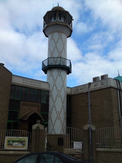

28m room floor to ceiling inc floor in white 50x50 mosaic
Took nearly 4 days to grout haha back in 2005.
2 of us for 2 week solid grouting this beast, grouting in the rain doesn't make me too happy ha ha.
18mm paper faced glass mosaic with inlay gold fishtail weave.
Plenty of tears on that job ha ha
