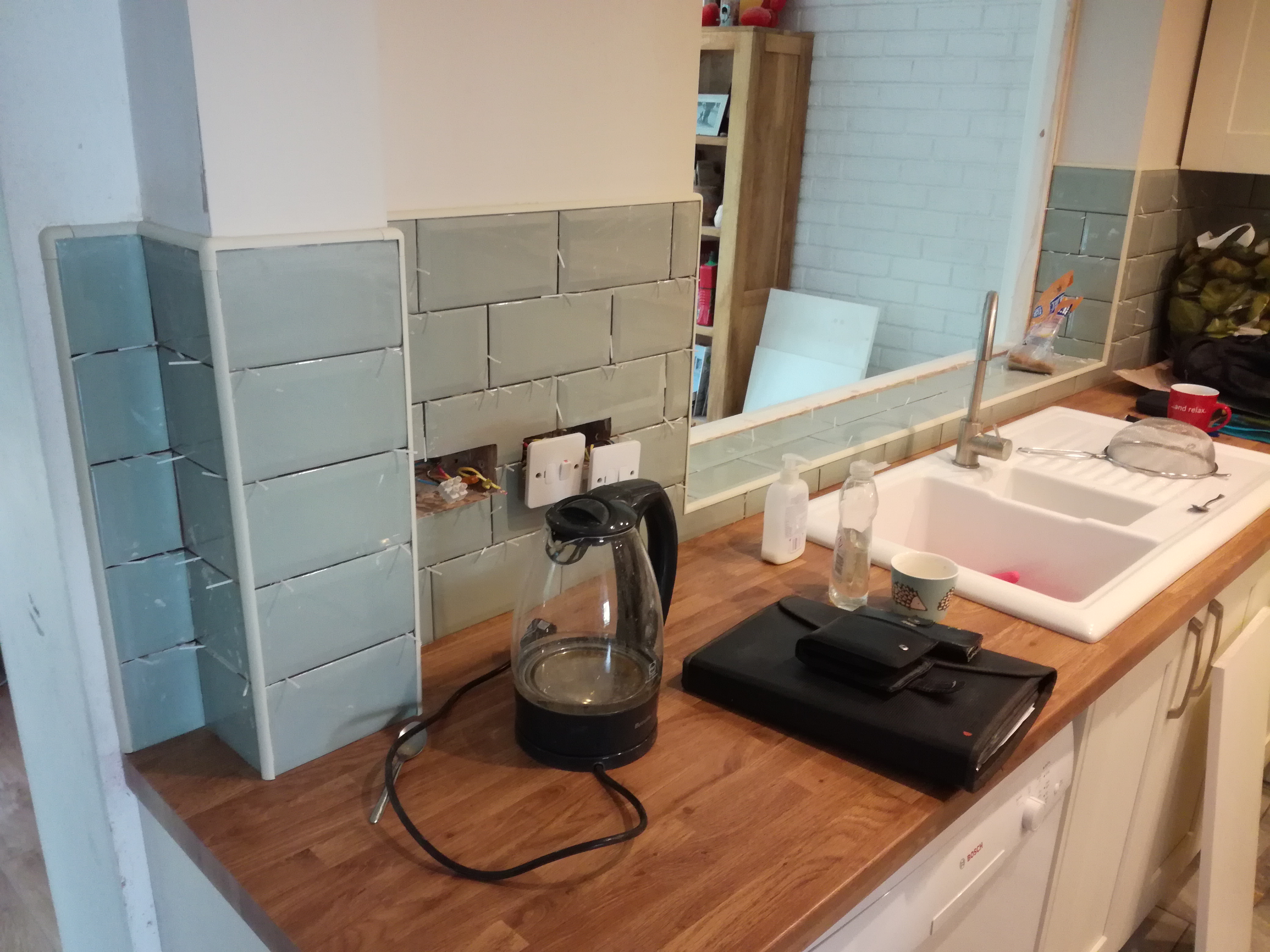

We’re on the home straight of our new kitchen being fitted, and the fitter has been working on the tiles.
He originally said that he’d mitre the tiles (here’s what we’ve got) to provide a clean finish, which sounded great. However, when he tried to mitre them he couldn’t get a good enough finish on the edge.
His next idea was to use a 9mm trim, and file off and grout the corners (i.e. where separate pieces of trim met). That sounded awful to me, but he said it would look good. In short, it didn’t (and he agreed).
His next idea was to use corner pieces (like this, but plastic) to finish off the corners, which I agreed to. However, he then decided to switch to a 9.5mm trim (without first telling me) because he felt the 9mm trim was too small, and took delivery of and fitted l-shaped corner pieces (rather than the style I agreed to). I've attached the end result.
I’m really unhappy with the finish. I think the trim looks too fat and takes over the tiles, and the corner pieces look really budget. Ideally I would’ve loved to have seen a mitred finish (as we were originally promised), but if not that, a much ‘cleaner’ finish with the trim.
My question is this: can we rescue this? Could the tiles be mitred (and our chap just doesn’t have the knowhow to do the job right), or if not, is there another approach (with or without trim) that would look better than what we’ve got?
I’d appreciate your thoughts!
Metros and trim is difficult, cut a tile and it's 8mm in the middle and 6mm on the edge.
I use 8mm trims with metros but tend not to trim the top of the tile.
I always trim the top, it's an exposed edge and you can see the ginger biscuit If not
