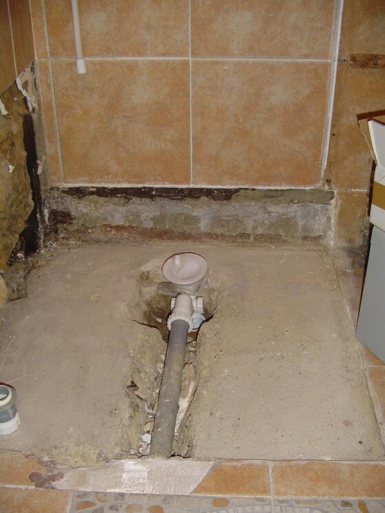

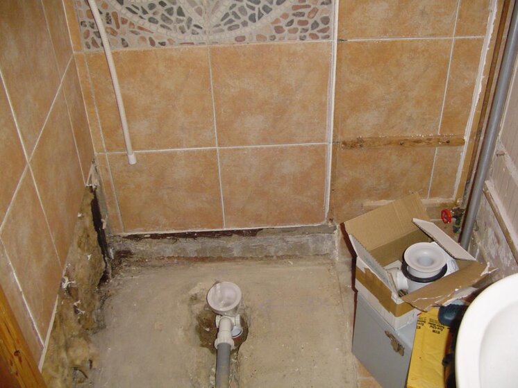

The drains are already in situ, courtesy of the previous incumbents here. There's a gulley in the existing concrete floor over which was the (very) old shower tray. I can post a couple of pics if that will be of any use?
Wish someone had told the builder I've been working for about pre formed trays before his attempt at screeding the shower area:incazzato:
2 x pics herewith. One of them shows the existing width of the room, but that will change when I take down the partition wall and move it back.
