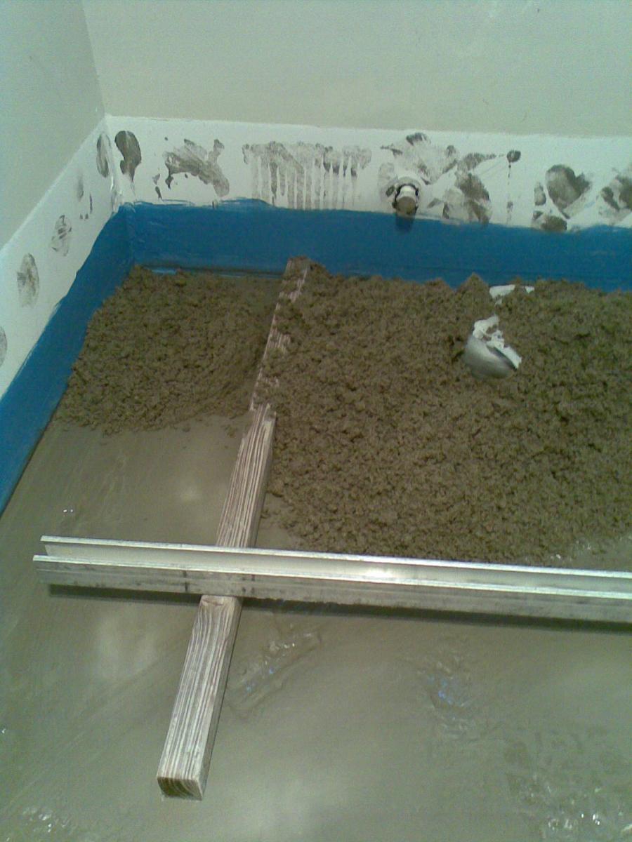

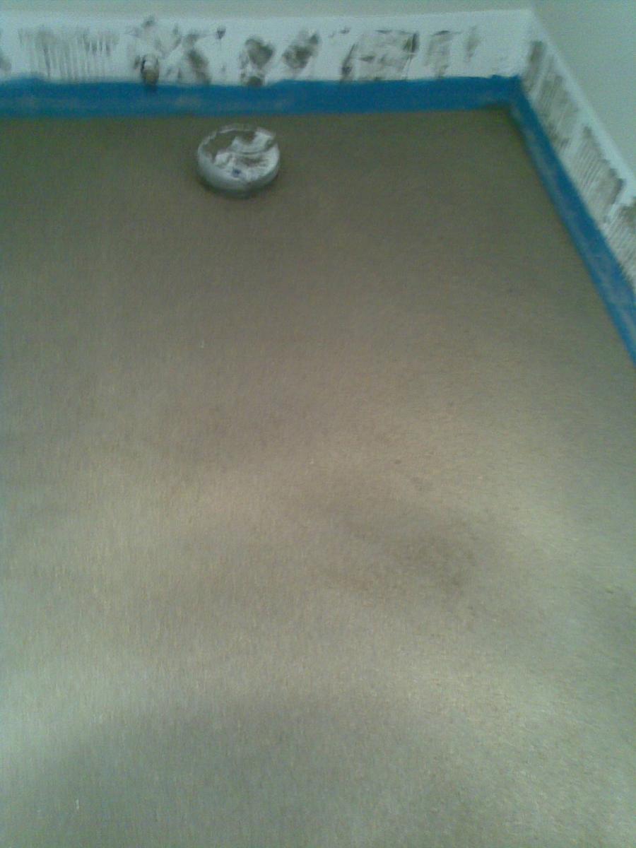

You could go either way, but SLC would be far more expensive it would also give a perfect finish. You could mix your own screed with plasterers sand and cement at a 4:1 ratio and get the levels spot on. I use a pair of screed sticks cut to the height I want then screed the cement mix flat onto the screed sticks then finish with a steel trowell
