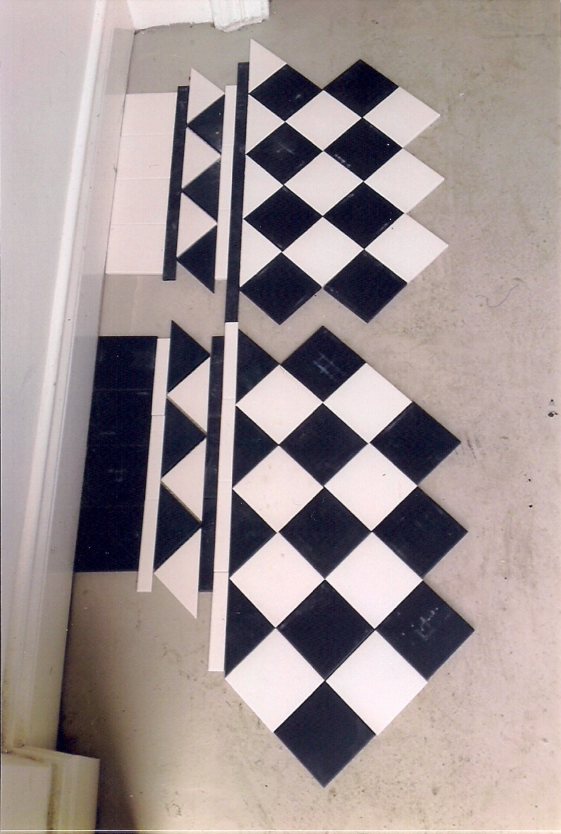

Step 1 - Fix floorboards - fix Hardie Tile backer boards - lay Underfloor Heating.
Step 2 - Lay out alternate design for customer choice.
Step 3 - set out and lay customers own tiles to agreed design

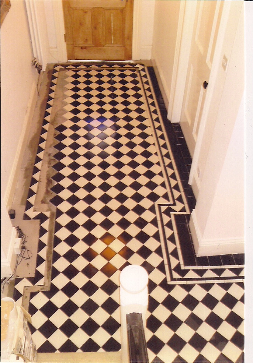

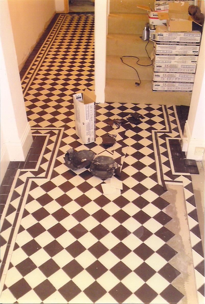

The setting out took over 4 hours with many lines of attack but the difficulty was in having no parallel walls ( being built in a crescent shape the hallway is 600mm wider to the staircase than the front door) However as the customer had many photos /designs of patterns running under the staircase this has helped the eye flow with the tiles IMO.
As this is still a work in progress - I shall update the thread next week.:thumbsup:

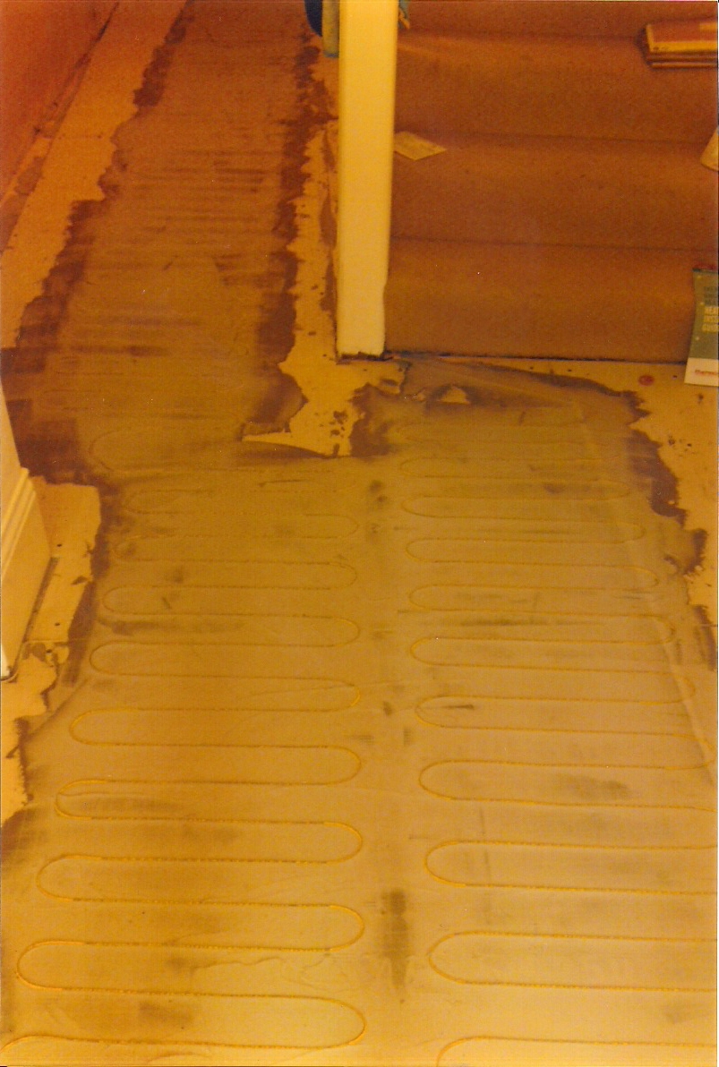

CJ - the joints are 2mm pegged, fixed with Webber grey fast set flexible over Mapei fibreplan SLC over Thermonet UFH over Harie tile backer boards over T&G boards/chipboard flooring. Grout is Ardurit C2 grey!
The setting out - I took a line through the middle of the Entrance Vestibule (still to show in photos) - through the middle of the top hall area - through the middle of the lower hall area (near the staircase) - stepped it over 300mm so the line went from the front door right through to the back kitchen door. A laser line ensured it was straight.
With a bit of tweaking the area towards the rear kitchen area became straight with the wall and then it was just a case of making sure the half black triangle came up against the white strips on all straight edges.

Those tiles look very thin, can I ask why you didn't slc to the edges? surely it makes it harder for you to tile? or is it a Northern money saving thing:lol:

The UFH mat in the picture shown was at stage 1 where I overscreed with a rubber float and fast set flexible adhesive to basically stick the mat down. I find this helps at stage 2 when the Mapei fibreplan goes over the top it doesn't lift the mat!
It also means less fibreplan and that saves my northern money!
The tiles are 8mm unglazed porcelain.:thumbsup:
