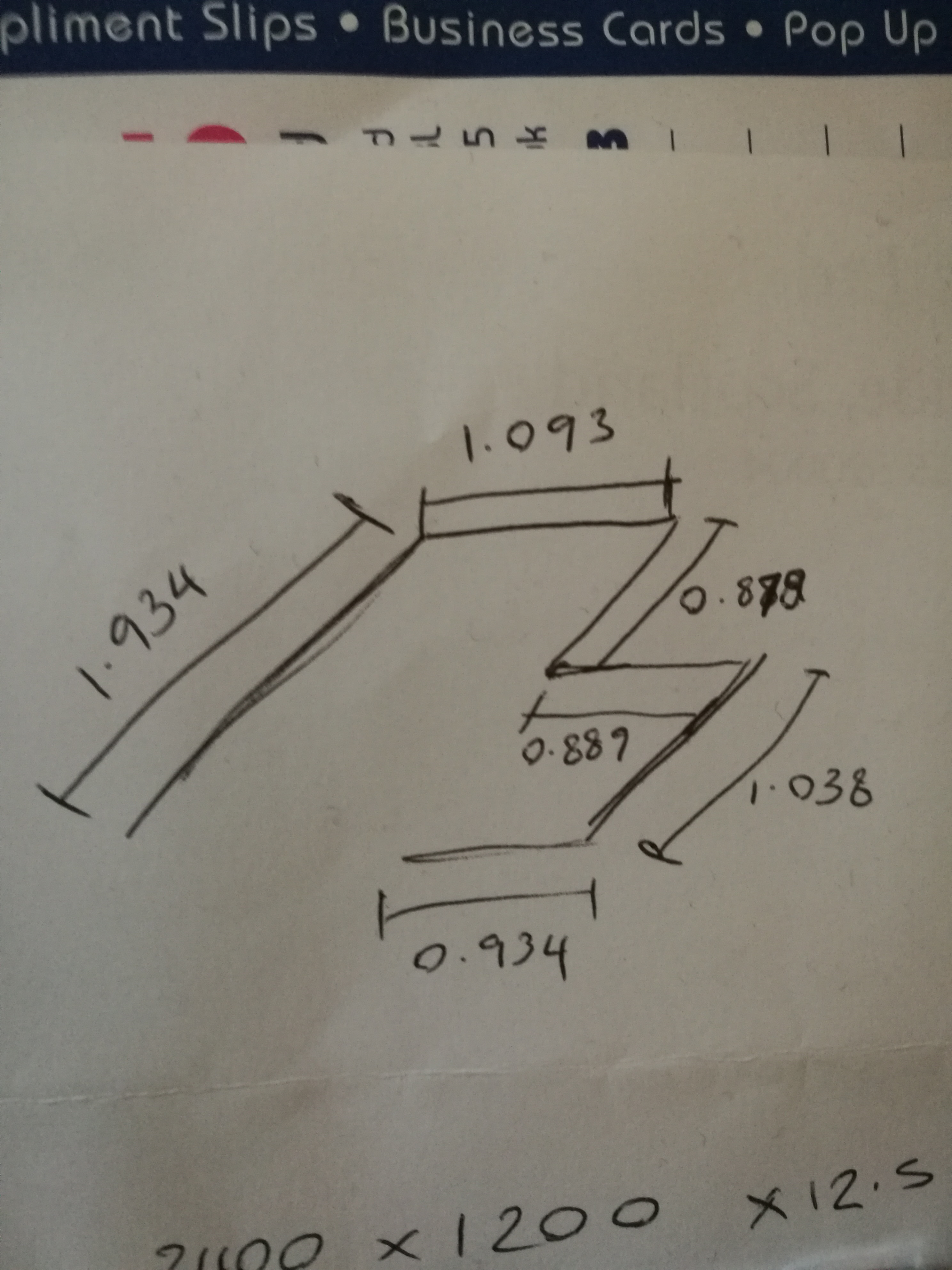

Where is the external corner in your photo?
Centre of a tile to your centre line would be better. Same as the others have said.
It's an L shape toilet, here is a rough pic of wall lengths.
centre back wall 200 cut on each side will wrap round nicely with a 400 cut adjoining it and will centre boxing, if you plan it carefully shouldn't be much waste either..
:thumbsup:
:thumbsup:
Sorry should have said tiles running 300 wide and 600 vertically. So would leave me 100 cut adjoining round the back wall.
