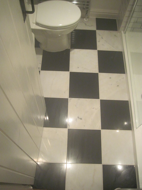

Just click on the picture above, That will move you on the flickr site, Than you can see the picture in the full size 3000x4000px.
9mm ply fixed with 3 inch screws, gap around the perimeter is around 5-10mm, you can see it next to shower tray, the rest is under skirtings.
So true...
Thank for opinions guys,
So I will centre whole floor to get mirrored cuts both sides of the room like whitebeam said
