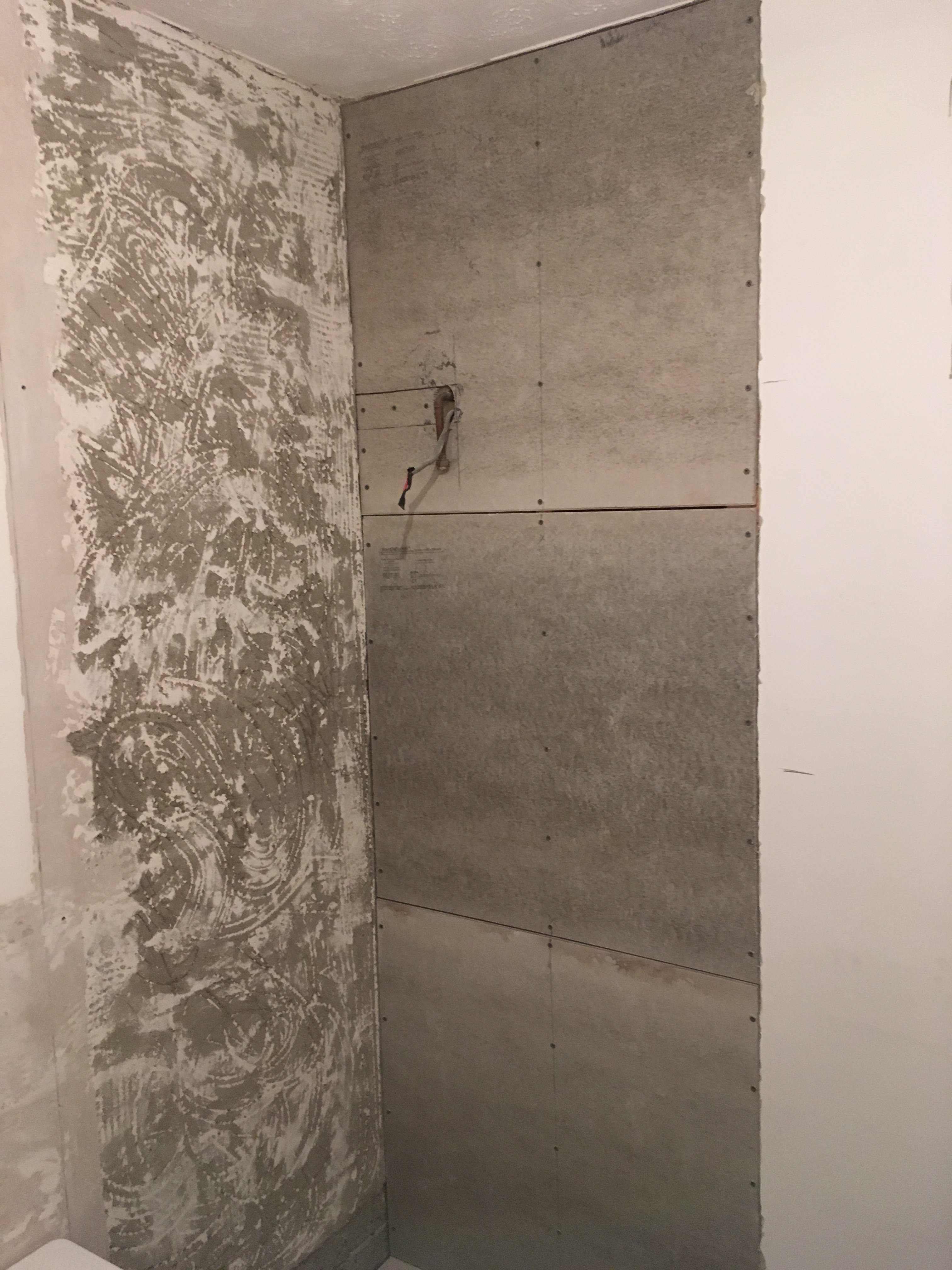

Shower surround substrate
When u say prime before hand whatever u do, I assume u mean the tanking primer?
The tape n addy joints don't need primed? As far as I am aware Hardie backer does not need primed?
Prime everything. Hardiebacker will definitely need priming despite what the instructions say. Let me guess- are you using the Mapei kit?
