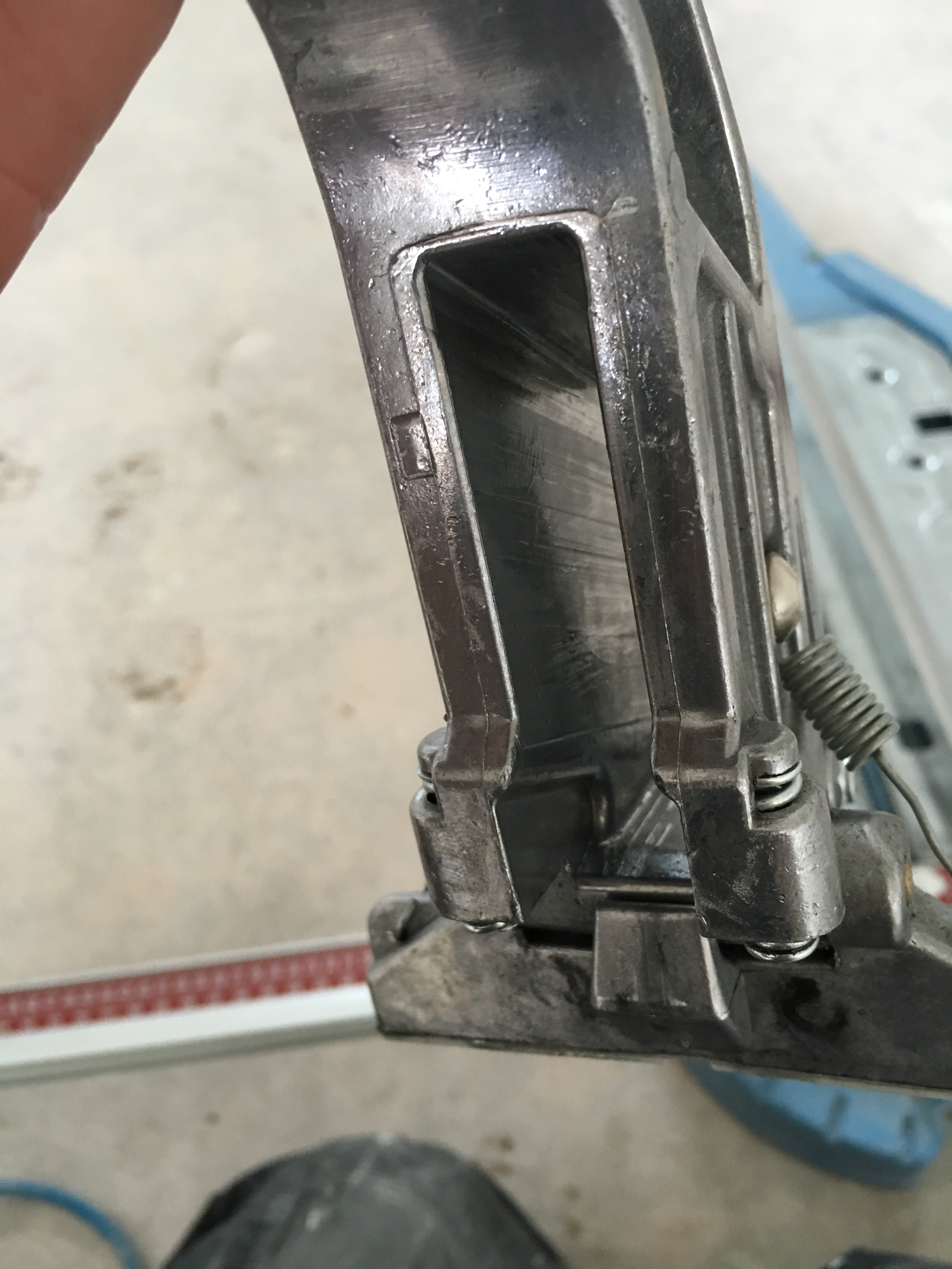

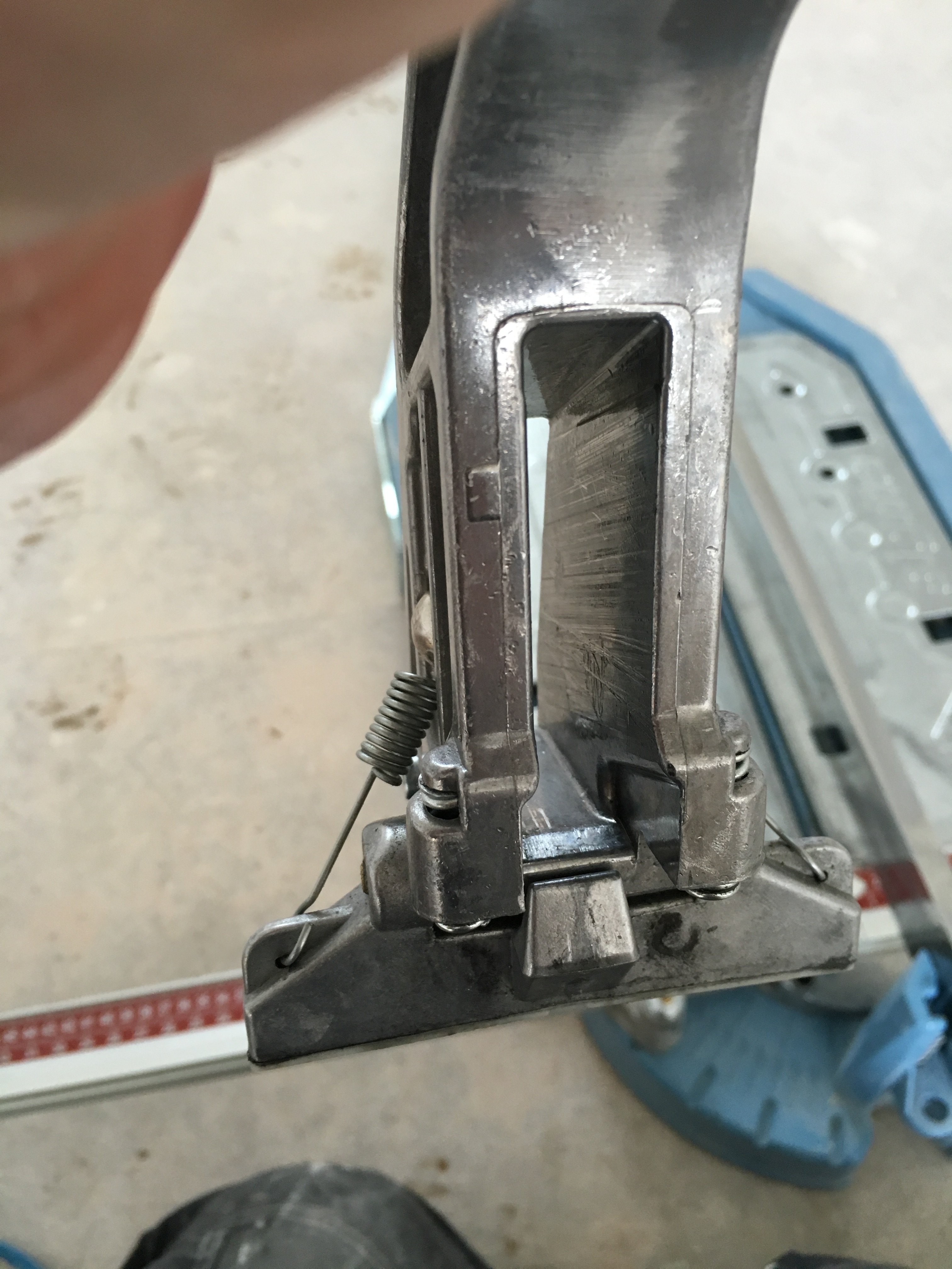

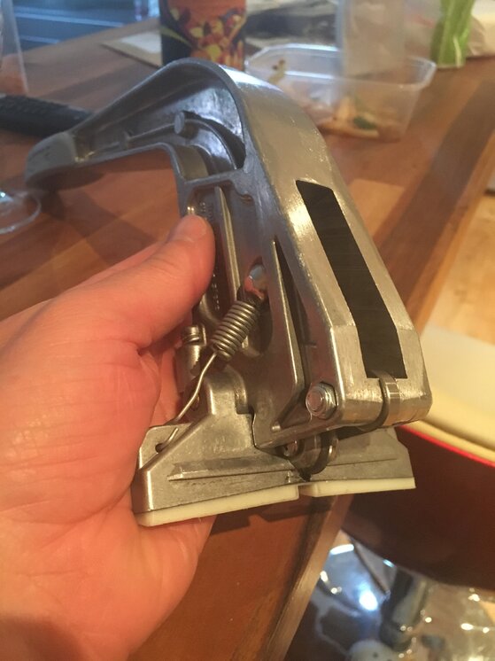

Back onto the job today & someone has moved my cutter, went to use it & the handle doesn't glide like it normally does, was sticking when I pushed or pulled it.
Sprayed it with Silicon spray, it's improved but still not the same, not sure if it's been damaged in any way.
Not a happy camper.
Inside the handle looks like this.
Anyone any ideas.

Stef two things to check, there's a nut and bolt on the handle above where the handle glides over the bar, if it's tightens too much it clamps the handle on the rail and stops a clean glide, another problem I find is a build up of addy dust inside the handle sides and if you pop the handle off and give it a once over with a thin wire brush this removes it. It's hard to see in your picks but it looks like there might be a bit of residue inside the handle

Sorry just realised its a max handle so no nut there, must be dust build up inside the handle, I don't like to oil this area I think it clogs up too much, I feel it's better to wire brush it

I gave the handle a clean today & cleaned the bar.
The nut & bolt on the handle are quite slack but it feels as though the handles too tight on the bar.
I was convinced that the boys had bent the bar but there is no way that you could bend the bar on the cutter.
Will give the handle a thorough clean & try again on Monday.
The reason I was saying about the nut and bolt was mine fell out on a pull handle during the week and when I put it back on I over tightened it slightly causing the same problem, is there a chance someone may have over tightened the nut holding the glide wheel on the underside at the front?
I always use Silicon spray & give my cutters a good clean, they normally always run like new but not sure what's happened today.

I think I know what's wrong with mine.
There's was a mark on the slide bar, as though the edge of a tile had hit it & chipped it & as I pushed my handle by this mark its grooved the inside of my handle.
I might need to take a fine file to the inside of the handle to get rid of any grooves.
