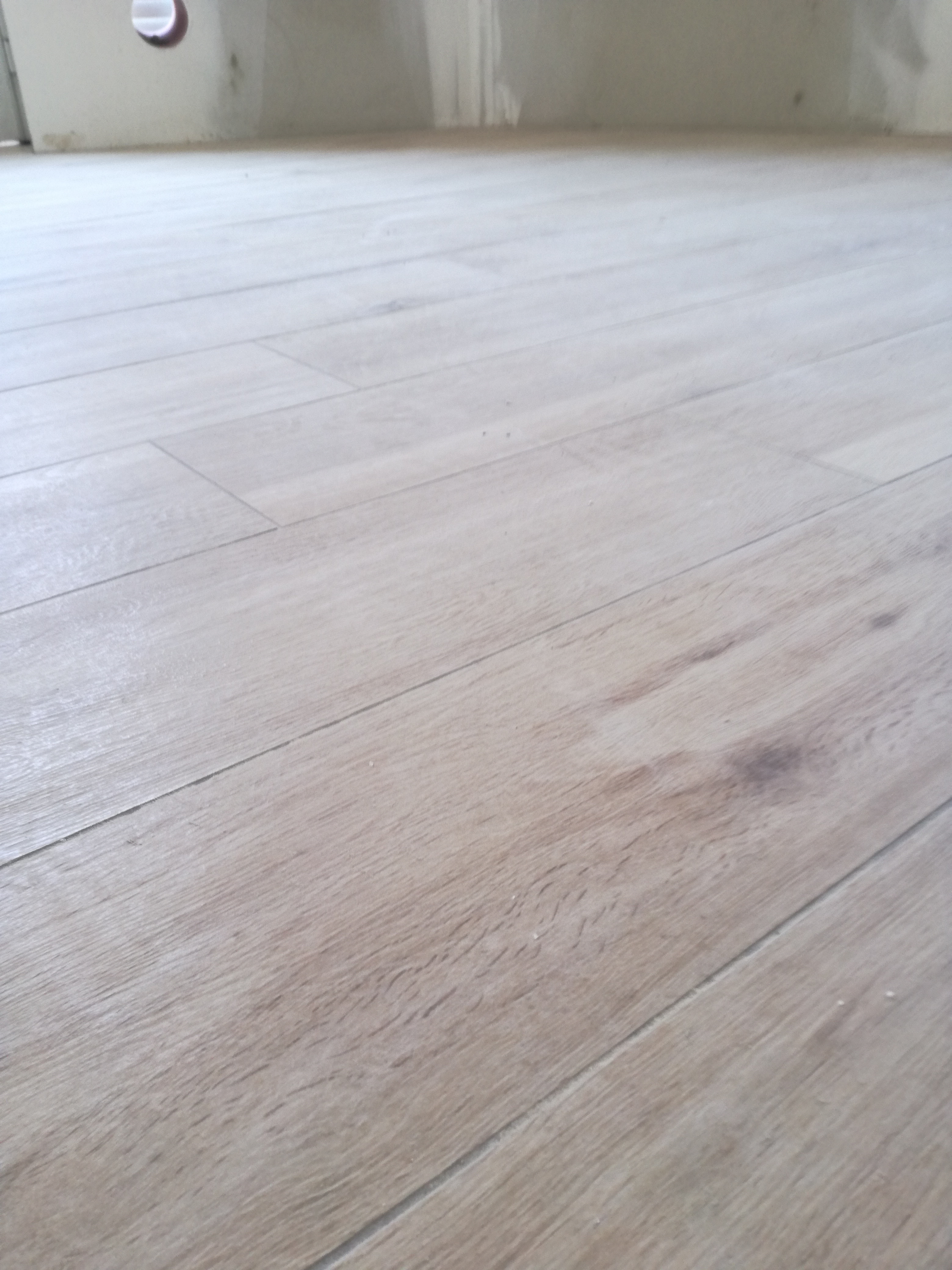

A plank tile?

I did 150x20 with freecut,
no problem.
is the same as cutting a 120 cm.
you should not have any problems with casabella,
it is still florim ...
