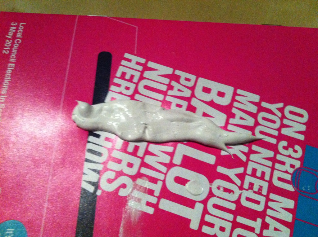

Just something brought up over on the plumbing forum. Seemed to be a mix of opinions on whether or not you could add Silicon over old Silicon, usually to cover cracked sealant etc.
As such I did an experiment to get a did definitive answer.
The first bed was put down and given nearly 48 hours to cure.
After that a new bead was added, firmly pressed to the older Silicon and with a decent bed behind it to simulate filling a gap or what have you.
Again this was allowed to dry fully before testing.

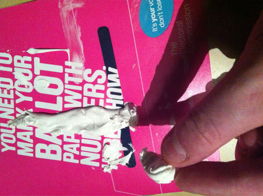

On testing the new bead was pulled at to see how easily it came off. Remember that these were new beads and clean unlike Silicon that might have been down for years!
And the result?
It came away effortlessly.
So obviously without teaching how to suck eggs, hopefully this will help someone or anyone in the future with either DIY or indeed professional jobs.

The only problem I see with your experiment is that how often do you not force the first or second Silicon in a joint with your finger or tool. From what I can see in your experiment you only laid the second one on top wth no smoothing to force it together.
Either way I think the biggest danger of not removing old Silicon is that the old may not be adhered to the surface well anymore and to put new on top may not fix the old failure. Plus often there are science experiments growing on the old Silicon which make the old stuff look like butt.
Leaving excess Silicon behind only makes Silicon fail. I always remove as much excess Silicon as I can with a razor - the excess peels later causing the joint to fail.

The bit of Silicon attached to the other was pushed hard into it then given some bulk afterwards to try simulate it being pushed into joint. But seems that once its cured nothing is going to stick. And yeah your right for old Silicon there's other worlds living on it!!! :)
