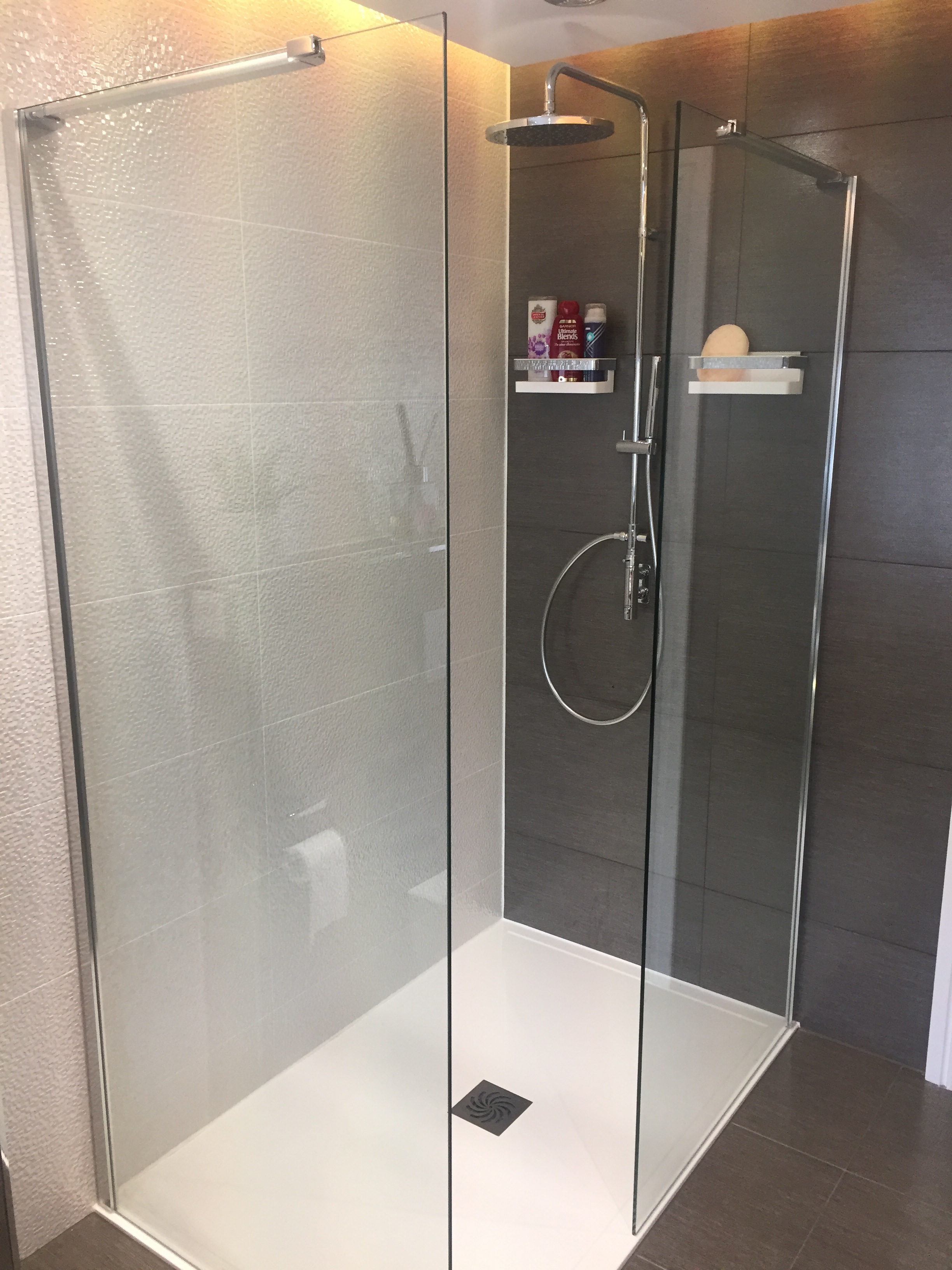

I've just completed a re-tile of the en-suite using Porecelanosa Cubica. the shower area is 3 wall, 2 white on black. I'm struggling to get a decent 'line' of Silicon seal on the vertical black to white tile joint using white Silicon (dow 785). The white to white doesn't look too bad at all but had to resort to the finger, the fugi tools dont like the tile contours.
I'm thinking of 'trying' to mask the black side with tape
Advice please

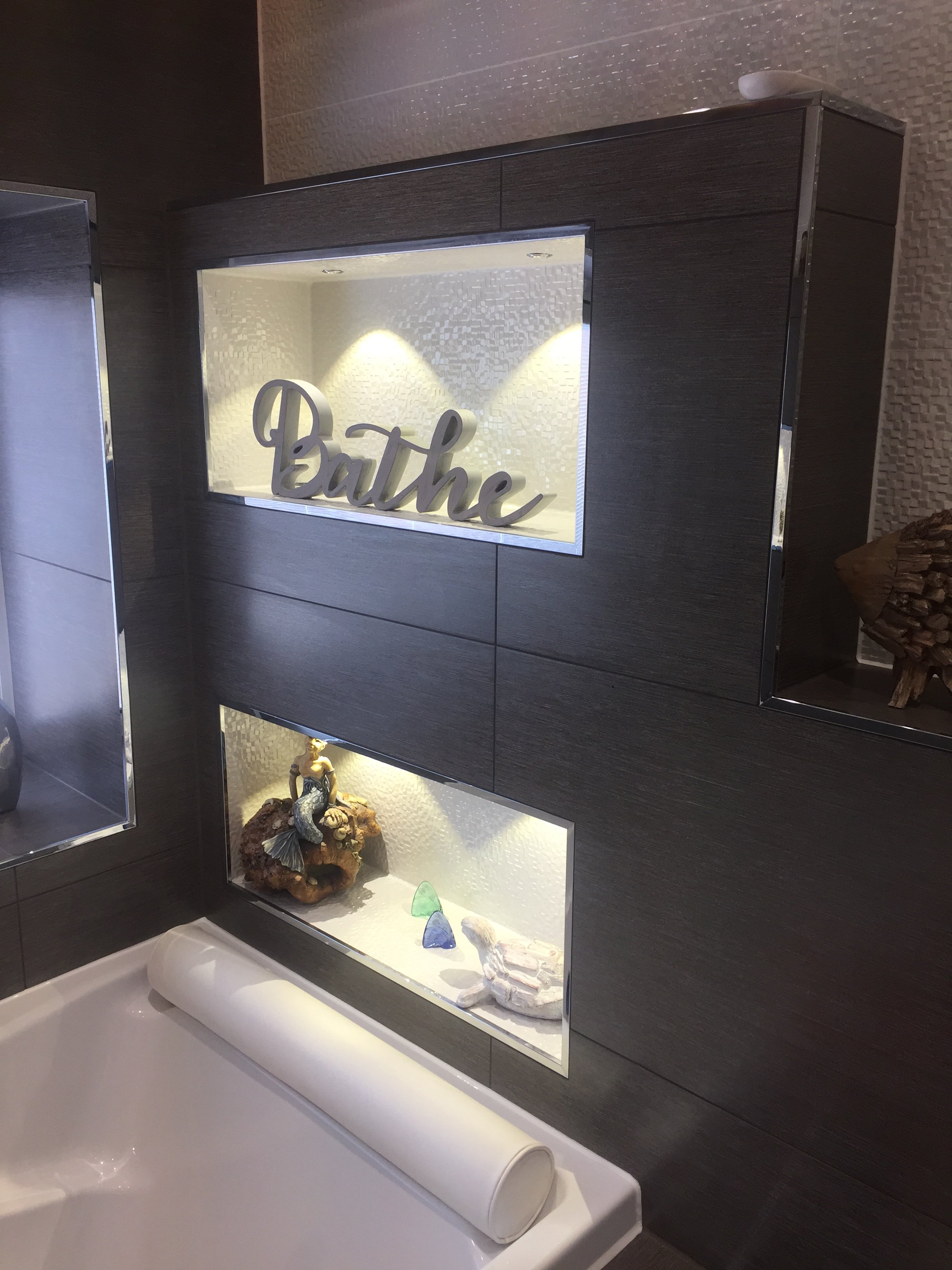

I've recently done a bathroom with same tile, although the Cubica was only jointed within the niches. Rest of bathroom was split with a darker tile. However, I don't use white on Cubica I use a 'Snow White' by Ottoseal which matches the shading perfectly. I used masking tape and found it was fine.

Very nice job there, I would say my white to white joints are very similar.
