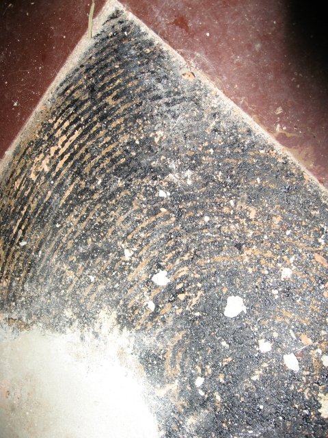

Washed the vinyl tile part of the floor tonight in prep for the bal bond sbr. After letting it dry I took a closed look at how clean it was. I noticed a fair few tiles have come away at the corners, no doubt from the water used in cleaning. Started to lift out the parts that wanted to come away by hand. Moving on to using a screw driver to make sure I was getting the parts not stuck down I can pretty much (sometimes with the aid of a hammer) get most of the tiles up. Not stuck down as well as I thought?
Is it best to lift all of them and use self leveling compound to level to the other half of the room (concrete)? If so, what is best practice for prep of the floor for the self leveling compound? Under the vinyl times is black...I assume adhesive for the tiles?
Help!

I called BAL today to ask them if I could use multibase on bitumen (I think that is what the black stuff is!?). They said absolutely no! Only on floor grade asphalt. Am now looking at scabbling the black stuff off. That way I could roughly level the other half of the room...prime...tile straight onto the concrete!
What do you recon??
SteUK
I have managed to scrape small parts away, it is only a thin layer. Looks like concrete under it! As you can kinda see in this pic...not the large area at the back of the pic, the small spots in the foreground. are bits scraped away.

I am still unsure! After what the guy at Bal tech said today...
Also, if I self level to the existing concrete (see pic below) will that cause issues with the slate? Is it not best to have one type of substrate? i.e. would it not be better to be taking the back concrete part down to the same level as the now 3mm lower old vinyl tile level?
