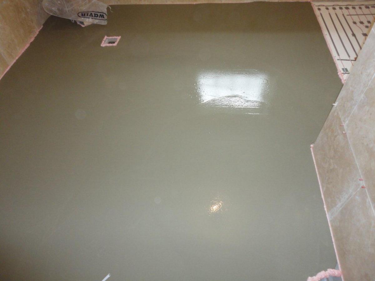

If you have to fit it though. like above, dam off the shower area snd self level floor. Then rapid set over the tray to protect he wires.
Like this:
Then adhesive (in this case FastFlex) direct to tray and cables.
I dam of my tray area with batons stuck down with decorators caulkas it never dries but does stick then SLC upto the edge of the tray and then use RSF in the tray.
