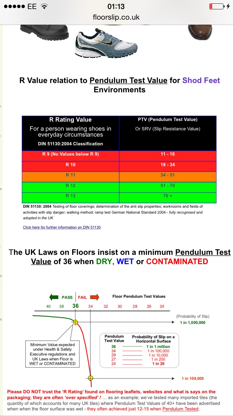

Sorry I got those the wrong way round didn't I!ptv 36 1 in a million . to bring things into balance friday night out of a million people 10% get drunk spend the rest of the night falling over thats 100 thousand people .
polished porc will get on avarage ptv 60 70 dry 16 20 wetOr perhaps bathrooms / wet areas?
How much does a PTV change when a tile is wet?

They'll use tiles that meet the PTV even for wet areas, else they'd not get insured to open the shop when it's raining. I'd assume. And they have various other risk assessments going on that stipulate wet floor signs when wet and whatnot.The PTV should be considered in relation to the area the tile is placed in. In many instances the PTV in wet conditions should be checked and recommended by the tiler.
