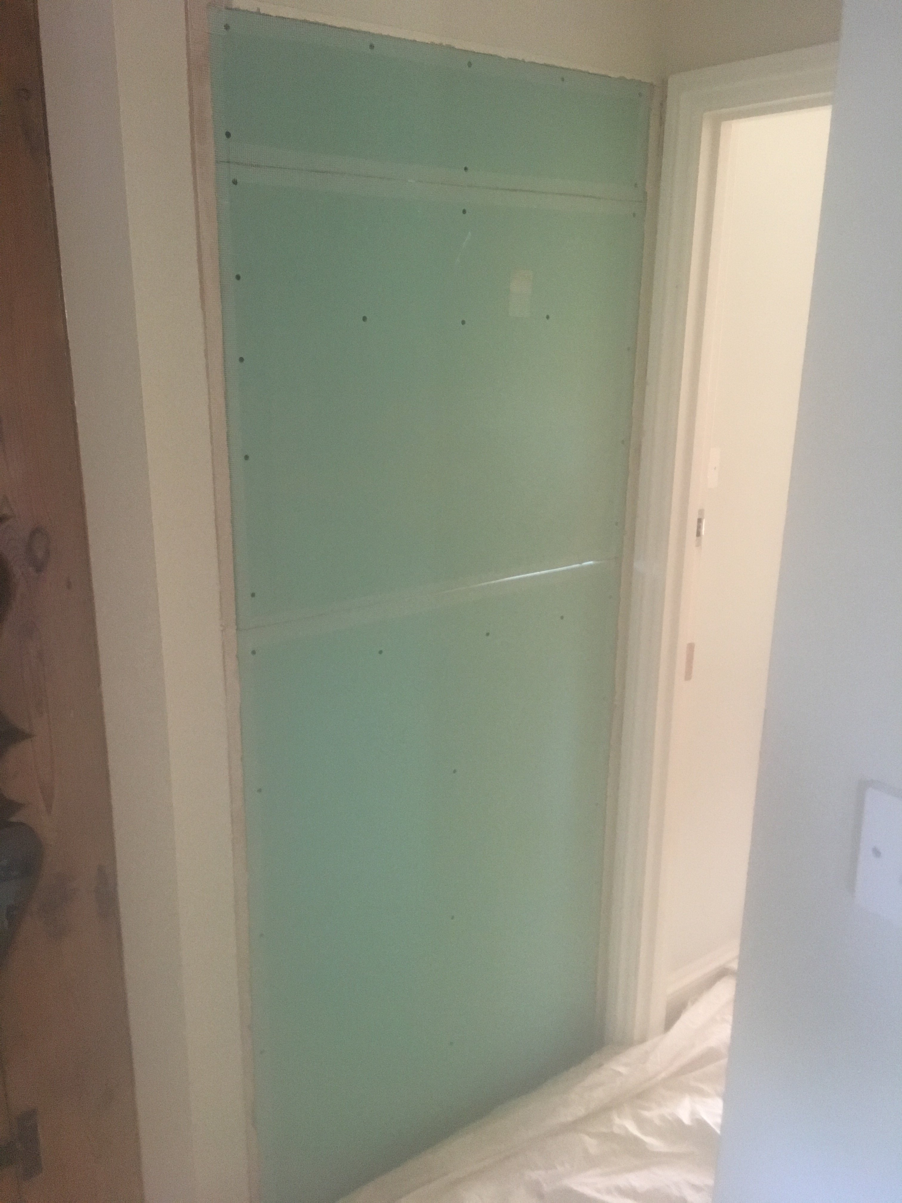

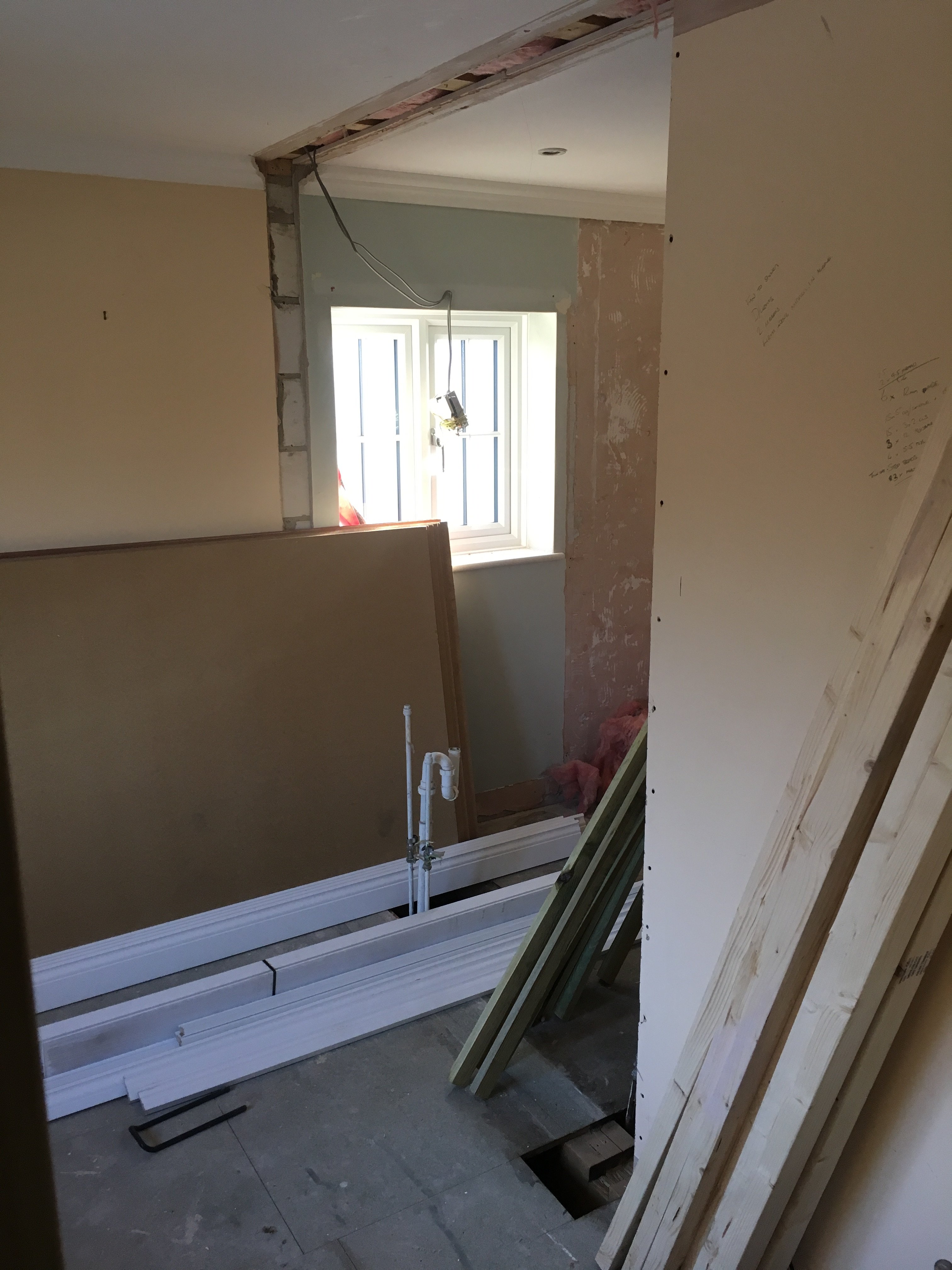

Ripped out middle wall to make one large room.
D7A75E6B-DB62-48A6-927B-1290814702C3.jpeg 7D35AF71-BF2F-43E2-87A2-949EC2CC66D9.jpeg 7E9EBEF6-D814-4672-826E-1D55BEBB1D73.jpeg
Bedroom doorway removed and walls built to take a niche for the shower.

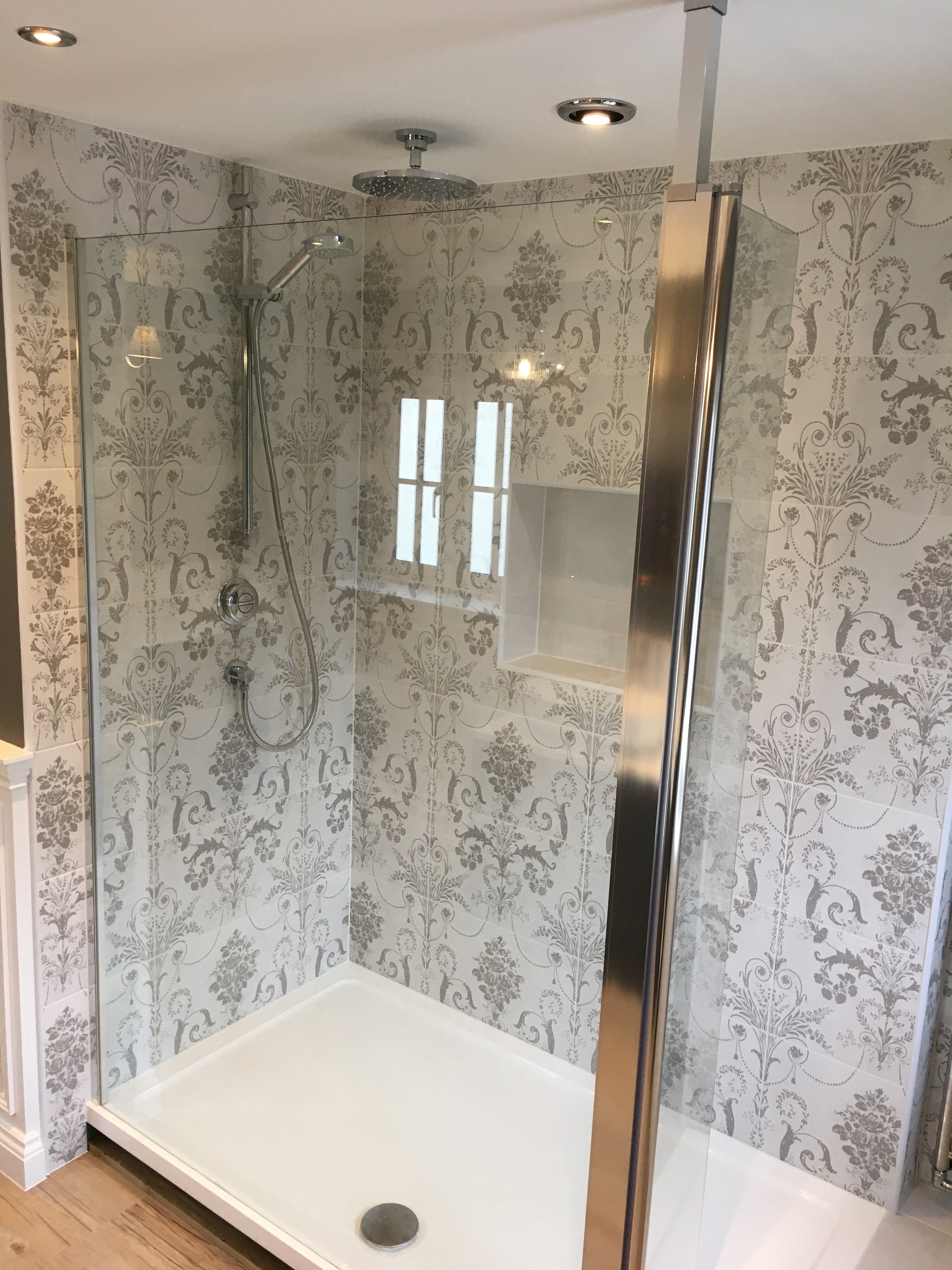

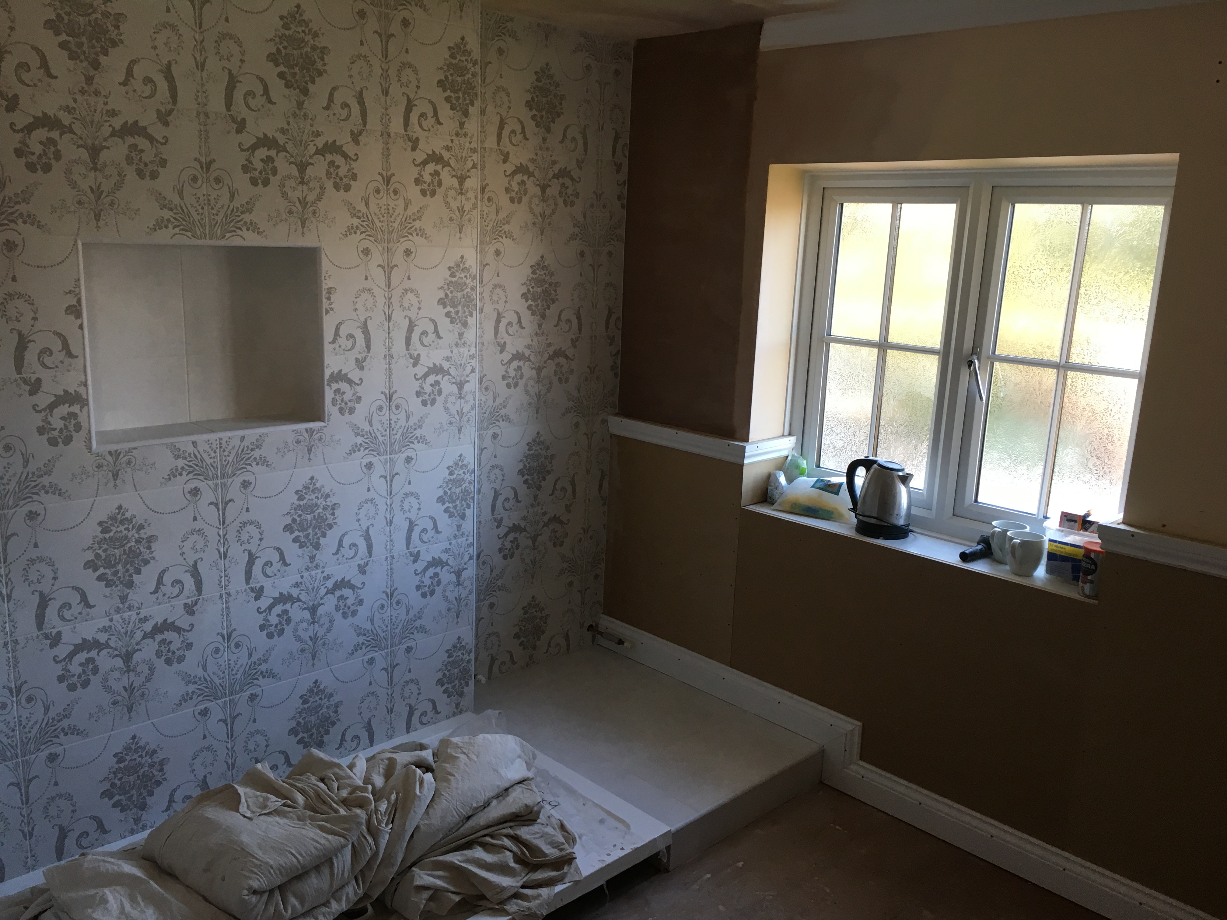

Shower area tanked ready for tiling, and timber panelling being built.
BCT Laura Ashley Josette tiles, not too bad all lined up nicely.
78A50440-933B-4528-B489-AC6C832129E7.jpeg 1F9D51BA-2EA6-4EFD-AE65-464DF6A0272A.jpeg

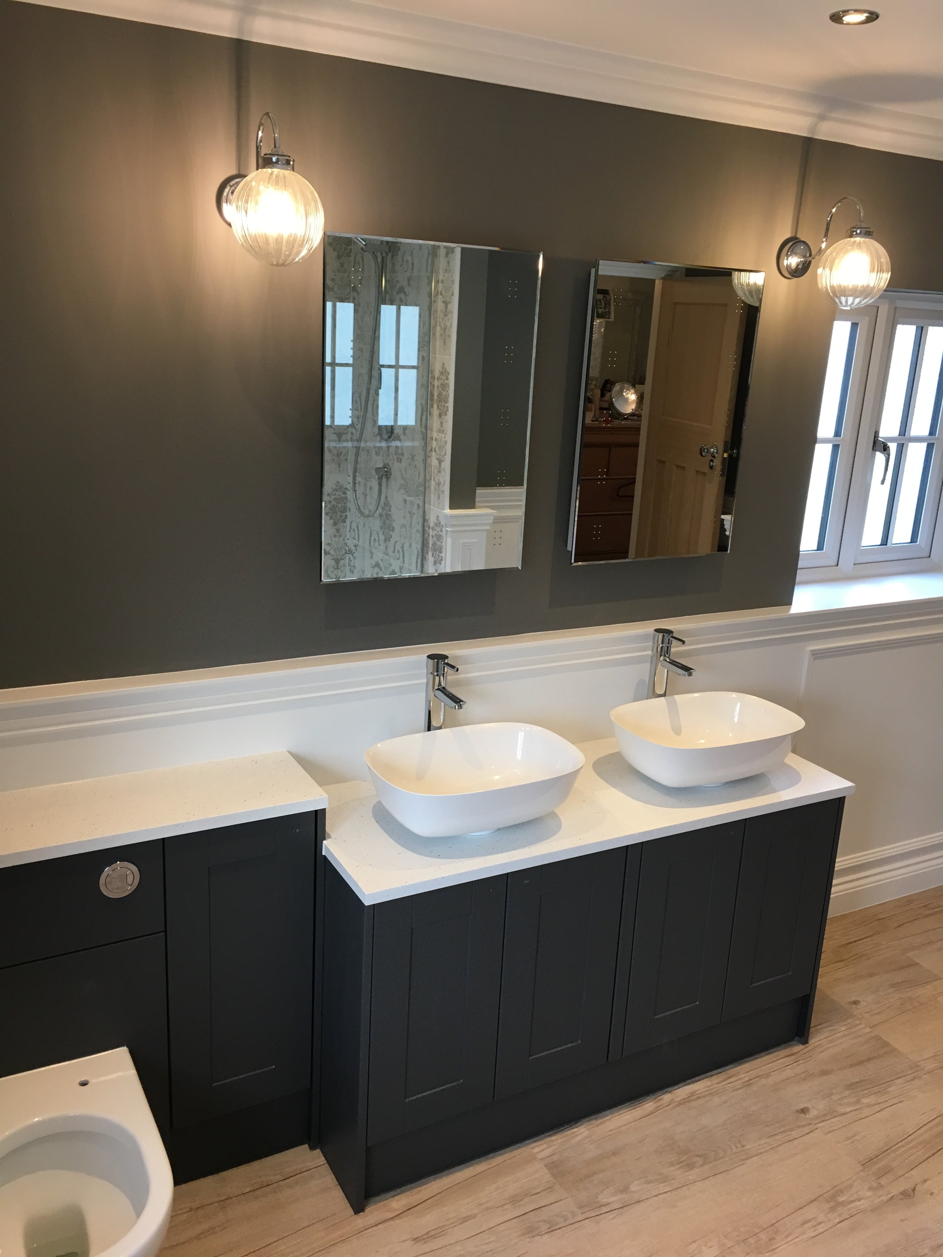

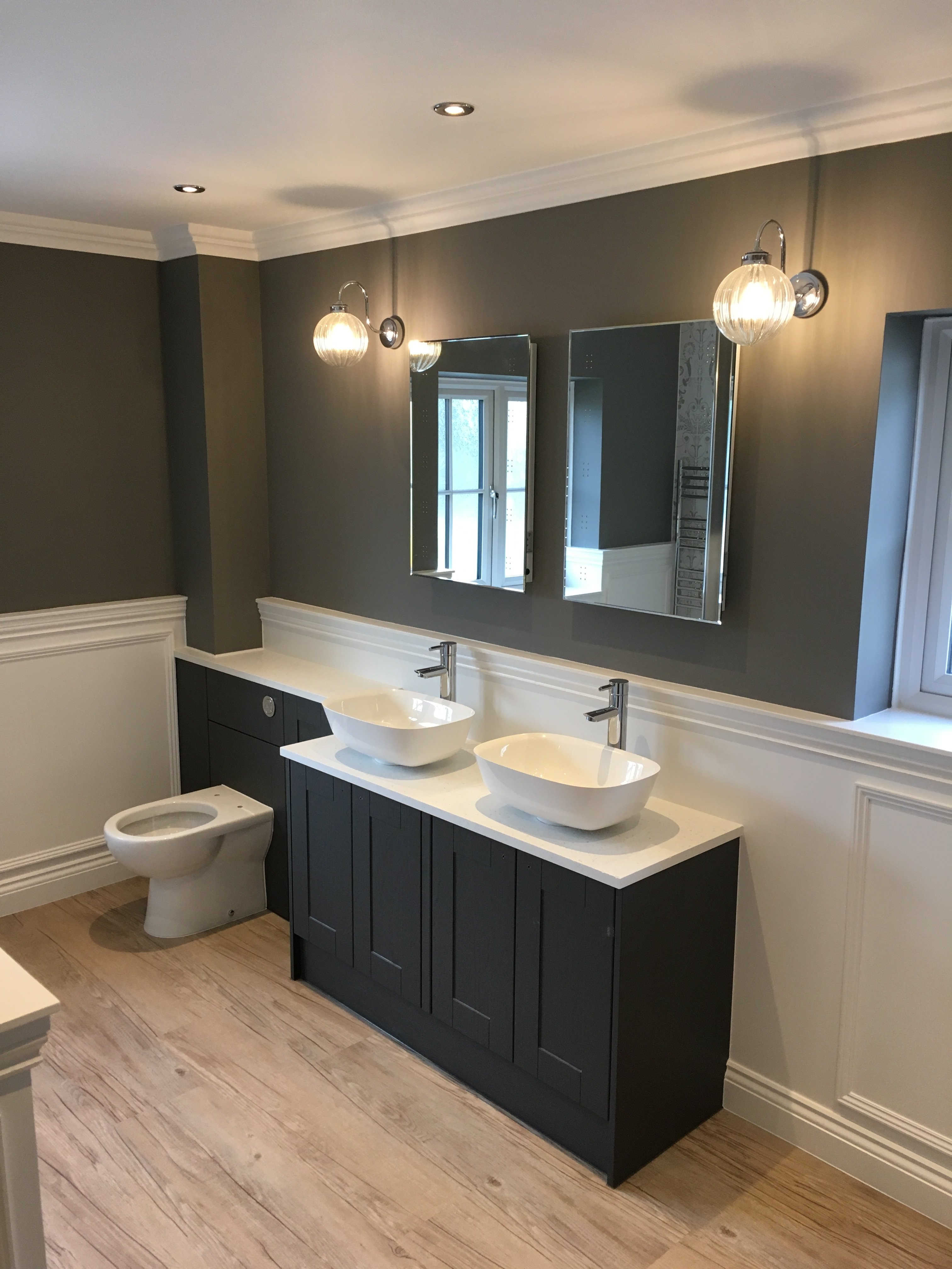

Nearly there, all painted everything working just a bit of touching up, handles etc on Monday.
C662C11B-F372-46A8-8C8A-93B654BA91EB.jpeg 889A1B07-D4C9-4358-A1B0-C002667597B2.jpeg 500B7A01-BD87-477A-AED1-B199122217F8.jpeg A81B398C-9DD9-4DBC-B723-95F30ACCF4D7.jpeg 263FC1B0-955E-40A9-87A3-F0F0D4D037EB.jpeg
Really enjoyed doing this one, nice to do something a bit different.

What a lovely job. I used to do this type of fit. I found it far more interesting than constantly tiling.
I'm not sure the floor colour works though with the dark/light grey theme.
Yeah, it looks a bit like that cheap laminate everyone used to use in the photos but it is actually much greyer.
Boggs
4,726
1,118
Uk
That makes more sense. It photo's like lime washed oak. Funny how stuff can appear so different in images.
I think it might be the yellow/orange glow from the lights.

Excellent, did you do the wall panels Boggs?
Stop using BCT!
Yeah, treated 2x1 frame packed out level and square, moisture resistant mdf, mitred at joints and corners, better than having cover strips, and beading added on top.
Top shelf made from mdf with slight bullnose added.

The dark wall and the units colour clash IMO. Too many colours, my poor eyes can’t cope :D
What’s on the floor?
Karndean Looselay, not layed loosely.
