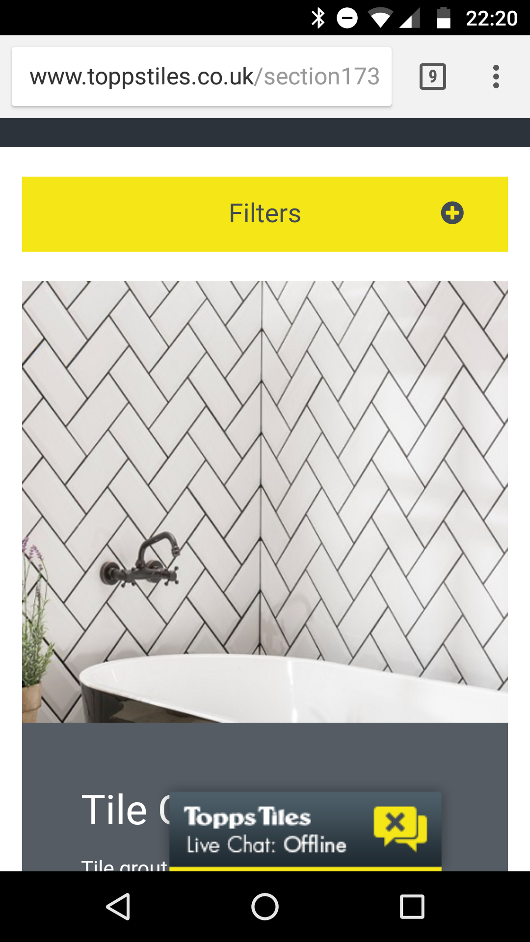

Hi, I'm planning to tile our bathroom with white metro tiles/black grout but I don't know what size spacer to use. 2 or 3 mm. I like the look of this - does anyone know what the spacing is?
Tile Grout | Coloured and White | Topps Tiles - http://www.toppstiles.co.uk/section173/page1/tile-grout

You really sure about the black grout?
I've been tiling a long time and I would refuse to install metros with black grout.
You're fixing will have to be absolutely perfect so as not to highlight any joint variations which the black grout will enhance, and the Micromax2 which Topps will sell you is notorious for leaking dye into the tiles, so if the tiles are not very very high quality, they will stain.
