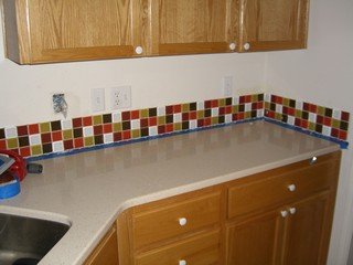

This one comes up a fair bit. The only nice looking solution is either sockets above the tile. Or sockets within the tile.
At least in this photo above they had the right thinking to go above the tile. I guess you have to cut out the tile to the shape of the socket and Silicon round it.
