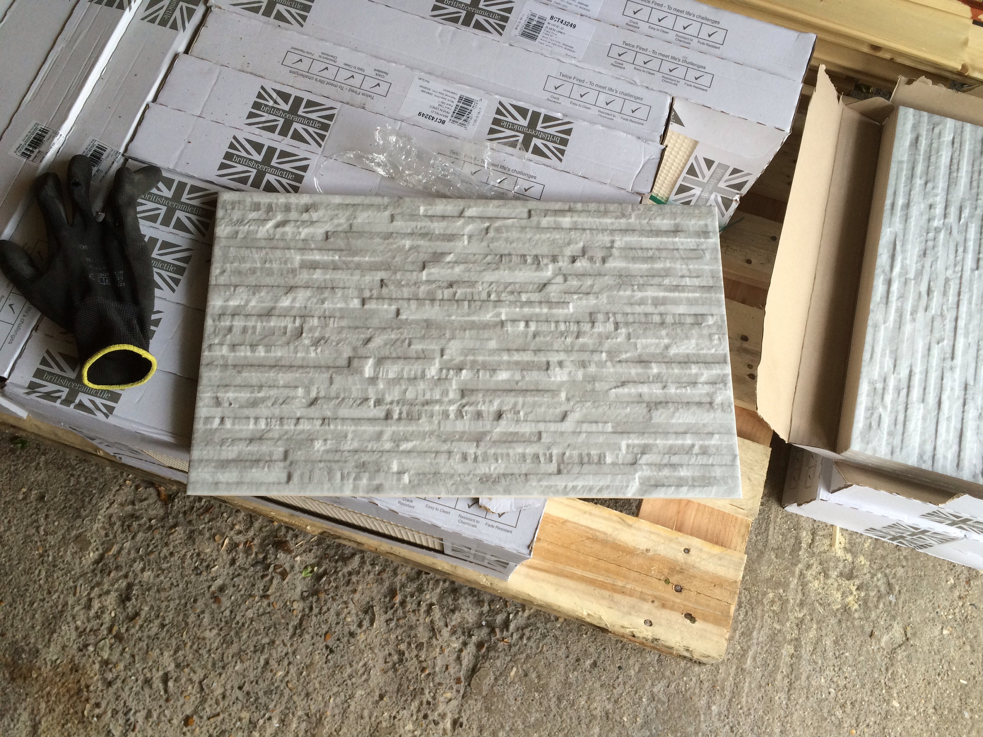

Good morning. Just a quick question regarding the tiles in the picture. I've fixed split face stone tiles before (not in wet area) and haven't grouted them. The tiles in the picture are a ceramic split face style tile from wickes. They will require grouting I assume due to them being a ceramic tile with the split face within the tile itself. Have you got any advice with regards grouting them, are they a pain to clean etc. Would you have a minimum grout line as well.
Many thanks.

We were on about this tile the other month, Laga Natural ( by the look of it ) it was after it took another fixer 8 ( eight ) hours to clean off after grouting normally, I went out and bought a grout gun for this reason, and went down the joints only, still a royal pain, you WILL need lots of sponges as the rough surface eats them.

When fixing these before I have grouted as normal with a float, but point it in the joint almost, using the end of the float. Wipe and clean as usual but go over it when fully set with an epoxy sponge or emulsifying pad using some grout stain remover and it comes up a treat! Not the quickest of jobs, but makes the job a bit easier ;)
