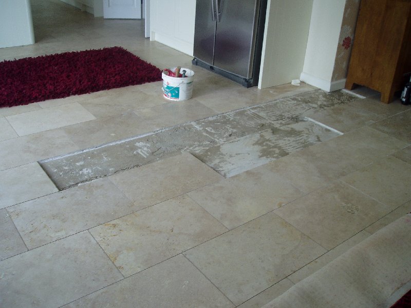

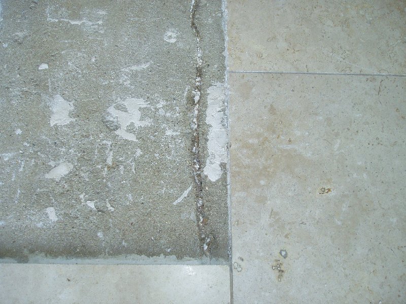

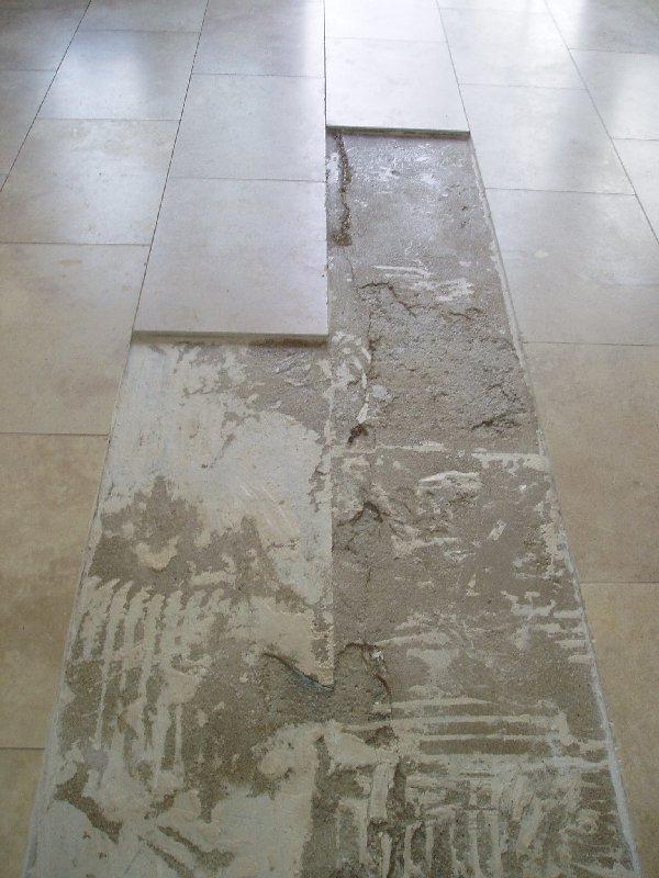

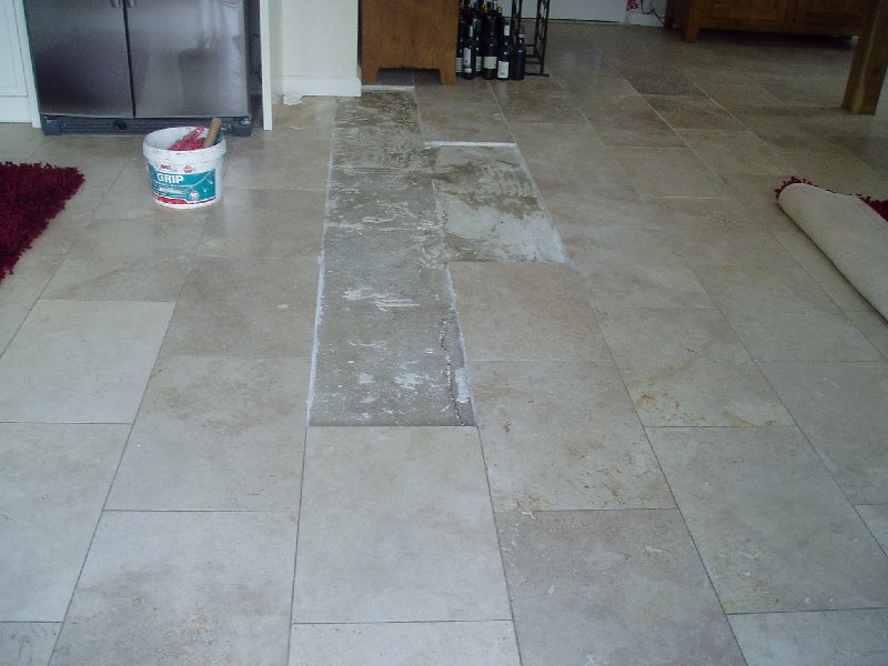

Got a job to sort out for a builder on a Natural stone floor that has cracked due to screed cracking, i didn't lay this floor just been asked repair this area. So if your thinking about having under floor heating, on a new screed floor, i would advise using a uncoupling membrane. I know it puts extra cost on the job!! If you don't check out my web site and give me a ring in 6 months and i will come and repair it!! :lol:
