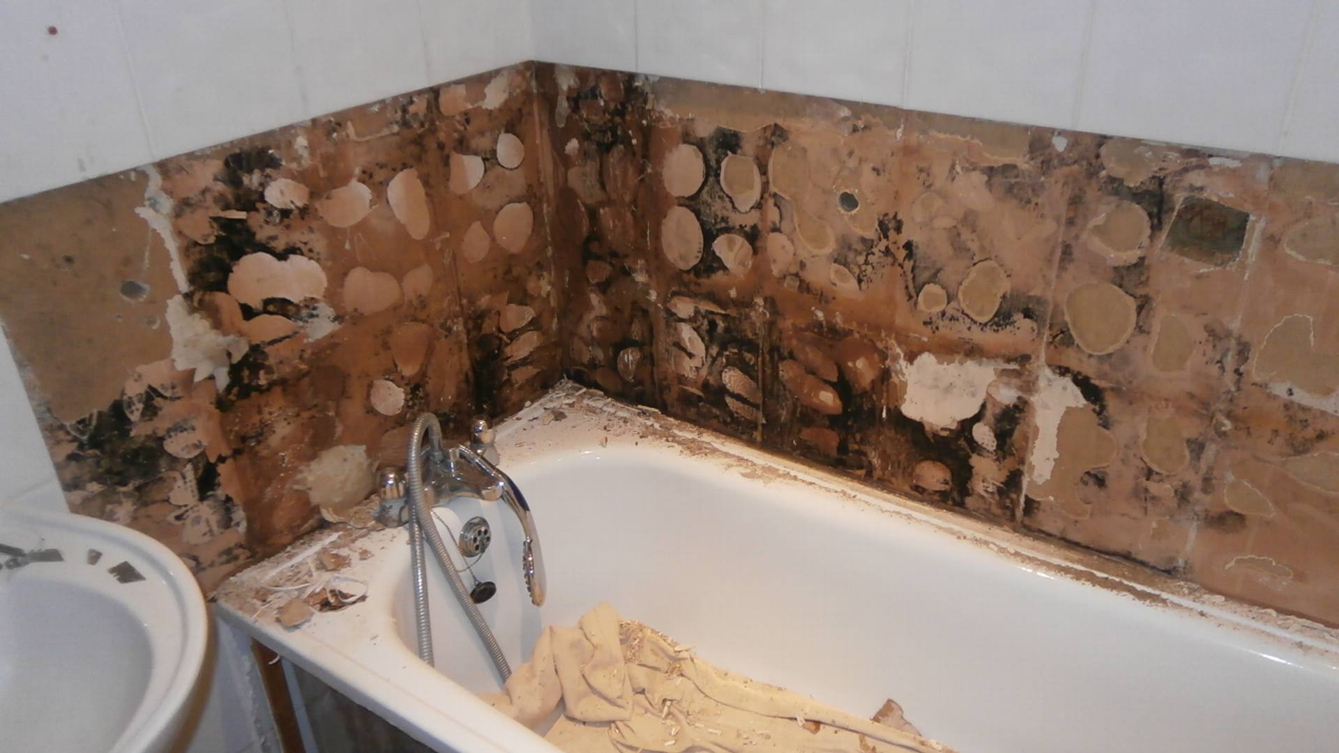

Romans used to waterproof their baths 2000 years ago. It's a fact!
Tiberiu
113
Suffolk
Countless times I've come across bathrooms wrecked by water ingress behind the tiles through the cracked grout or failed silicone. For your peace of mind waterproof the wet areas or if you're boarding up new use tile backer boards which are totally waterproof
