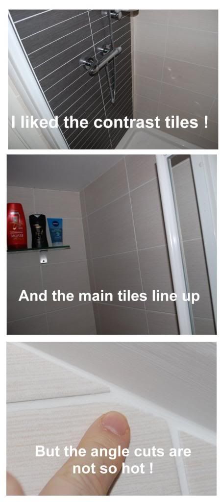

Worlds smallest mistake in a tiling project!
Still annoying tho.
Would have been 100% perfect too...
[video=youtube;MqNP1wTY2JU]http://www.youtube.com/watch?v=MqNP1wTY2JU[/video]
Never mind!
Deleted member 1779
To help the tiler I showed him this picture... I did it to show the tiler the picture of the feature tile and how I wanted it
(See below shop image)
But he said it was not possible... At the time the tiler said the shower tray at 900mm was too wide for this look so he needed to put a sliver in to pack it out.
I Wish he had tiled the feature tiles right into the wall like the photo above.
When the tiler had finished the wall DID look cemetrical because there was a sliver either side.
But.... And here comes the but.... Once the shower frame was installed the sliver on one side was obliterated and so now it does look wrong!
If he had tiled into the corner then there would not have been a problem. It would have looked like photo above !
Maybe I should have been more insistant !!
