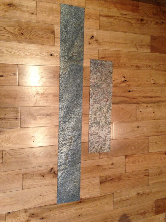

In CTD Glasgow & was talking to a couple of reps,
They showed me a new product, thineer slate tiles.
1.5/2mm thick mounted on a fiberglass backing.
Anybody saw this or had any experience of this yet.
ImageUploadedByTapatalk1374768500.385391.jpgImageUploadedByTapatalk1374768634.402185.jpgImageUploadedByTapatalk1374768658.568173.jpg
These are only samples (off cuts)
The sheets come in 1200x600 roughly
The Bal rep had tiled the circular shower cubicle on top of glass mosaics to show what you can do with them.
oh dear i hope this is not the same stuff from india i was offered over a year a go .i sent it to ceram for testing and got a 200 page report back .a will give you a sample of these .
the sample combusted readily to produce carbon dioxide with some aliphatic and aromatic compounds also present matches were found for dioxanes and dioxolanes which are heterocyclic compounds. the main aromatic species found were benzene.toluene. styrene. and naphthalene some derivatives of these compounds were also seen a match for fluorene was seen at 20.9 minutes
hazards identification
potential acute health effects
hazardouse in case of skin contact (irritant permeator ) of eye contact (irritant)of ingestion of inhalation (lung irritant)
potential chronic health effects
carcinogenic effects not avaiiable mutagenic effects mutagenic for bacteriar and or yeast/teratogenic effects classifield possible for human developmental toxicty not available the substance may be toxic to gastrointestinal tract upper respiratory tract skin eyes central nervous system cns repeated or prolononged exsposure to the substance can produce target organ damage
this is only a small part of that report and the other other compounds found are carcinogenic .they give me a report when they where trying to sell me this but when my pa touch it she was getting rashes so i sent it off for a full report told them this product need to be made with a high fire retardent and needed to be fully sealed and there report did not match mine .have not herd back since hope this is not the same one and they have had this tested indepedley

So what your saying is Ray it's bad :yikes:
the one i had not good for the fixer not good for the client loaded with carinogenic compounds thats cancer if you come across this use a lighter on the courner and watch to see how much black smoke it gives off very quicky
We will wait & see Ray, they are going to be rolled out through all CTD branches in the next 6 weeks or so.
These were the 1st fixed in the UK.
no these have been fixed before well over a year ago
I saw this stuff at Rays place a good while back........and IMO it looked ropey from the outset........
