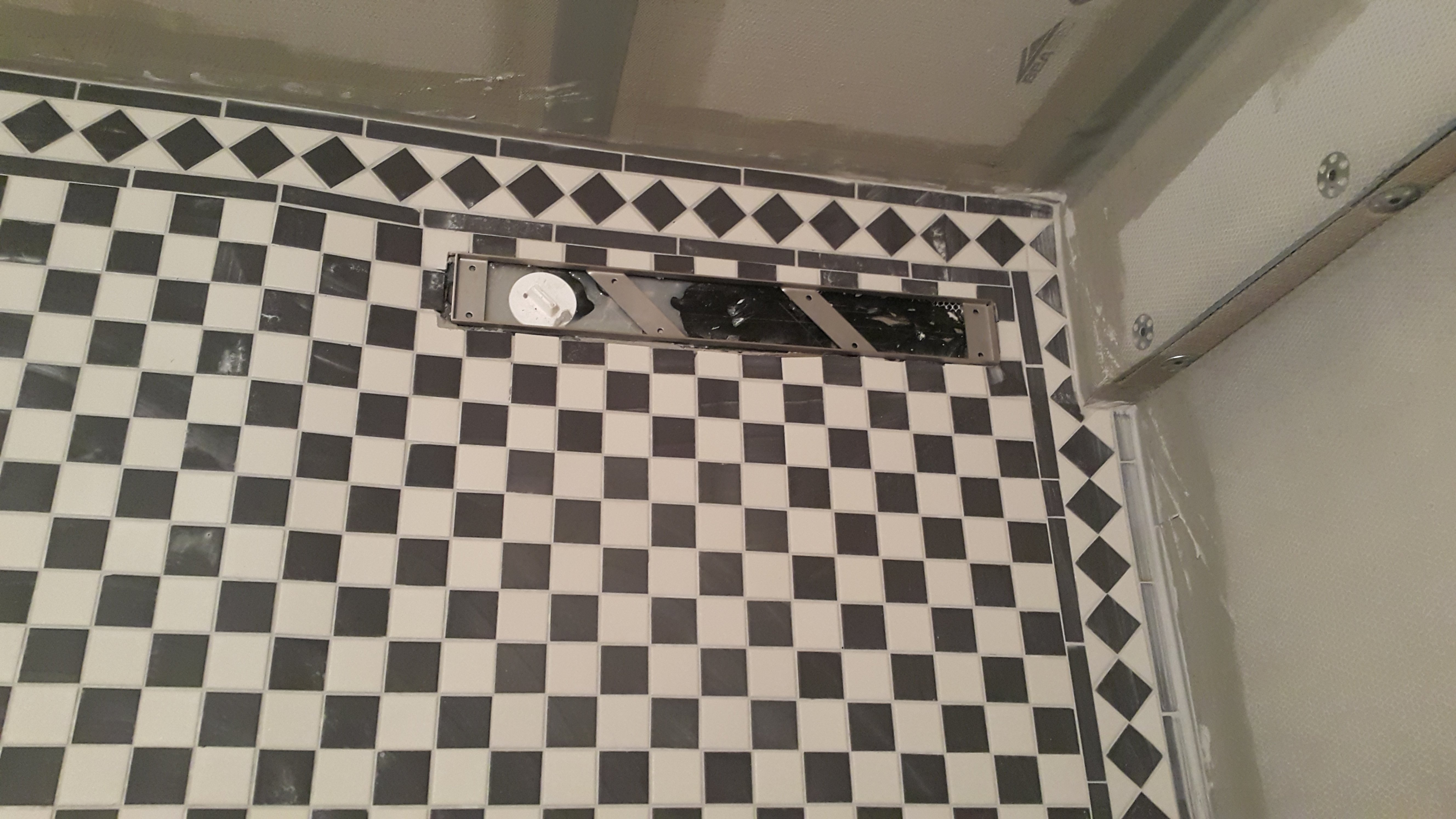

I got a professional top tile my wetroom because I was scared of making a mistake.

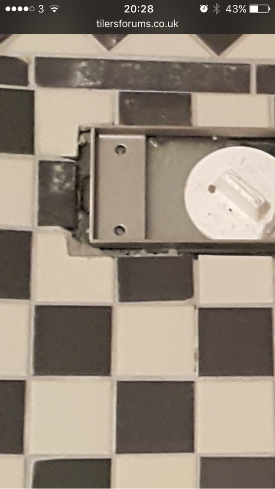

After he left it occurred to me that he never fit the frame for the drain cover.
The shower tray has a linear drain with a stainless frame that should have been screwed in place and tiled up to. Now some tiles are too far back and some are obstructing the installation of the frame.
I need to remove the tiles surrounding the drain, install the frame and retile up to it.
My fear is that the floor has been tanked and the drain portion of the tray is plastic.
Is it possible to remove these tiles without damaging the tray or am I looking at taking up the entire floor and starting again?
Attatched is a photo.

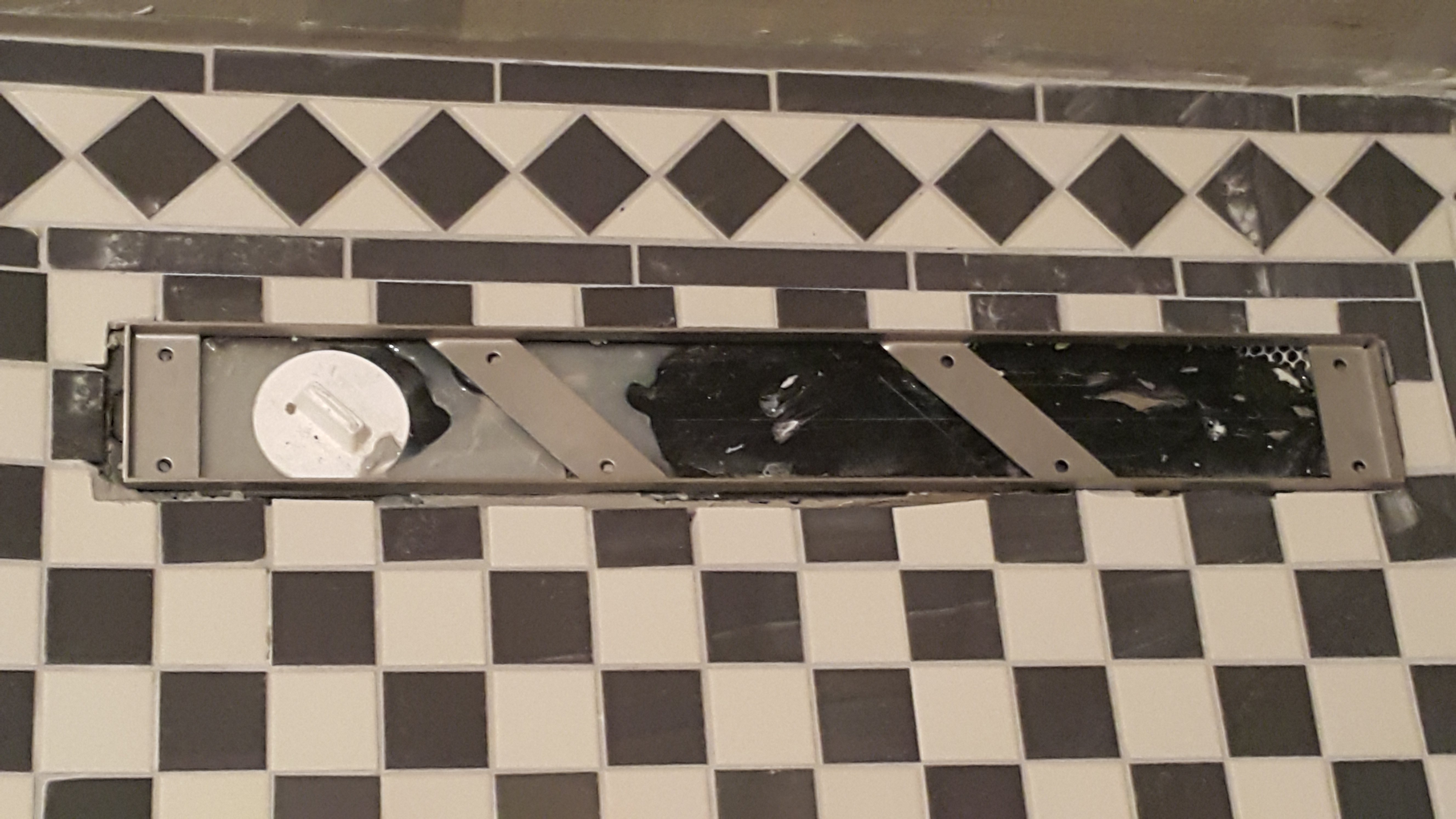

SpItal_Jeff
Slightly bigger photo.
My question isn't if I should get him back. ...of course I should. However as he has been paid for the floor before I noticed the mistake, time will tell if he returns.
My question is CAN IT BE FIXED? Can the tiles stuttering the drain be lifted without damaging the tray or the plastic drain? Obviously if the integrity of the tray is compromised the only solution I can see is to lift the floor replace the tray and start again. I'd obviously like to avoid this

First time I've seen a Victorian floor in a wet room by the way, any photos of the bigger picture ?
It's a small 1.1mx2.4m room with an odd shape shower area. So to avoid cuTring a tray I tanked the room and used a wet room shower tray. It's a 200 year old house hence the victorian tiles.

What is needed it to lift all of the tiles surrounding the drain.
How would you do that?
Take out the insert and carefully chisel then up.
To be frank, the job is so terrible I imagine they'll come up easily and that there is no effective waterproofing underneath anyway.
I did the waterproofing so I know it's there.
The stainless insert is just sitting on top. The plastic drain is an integral part of the shower tray and can't be removed or damaged.
