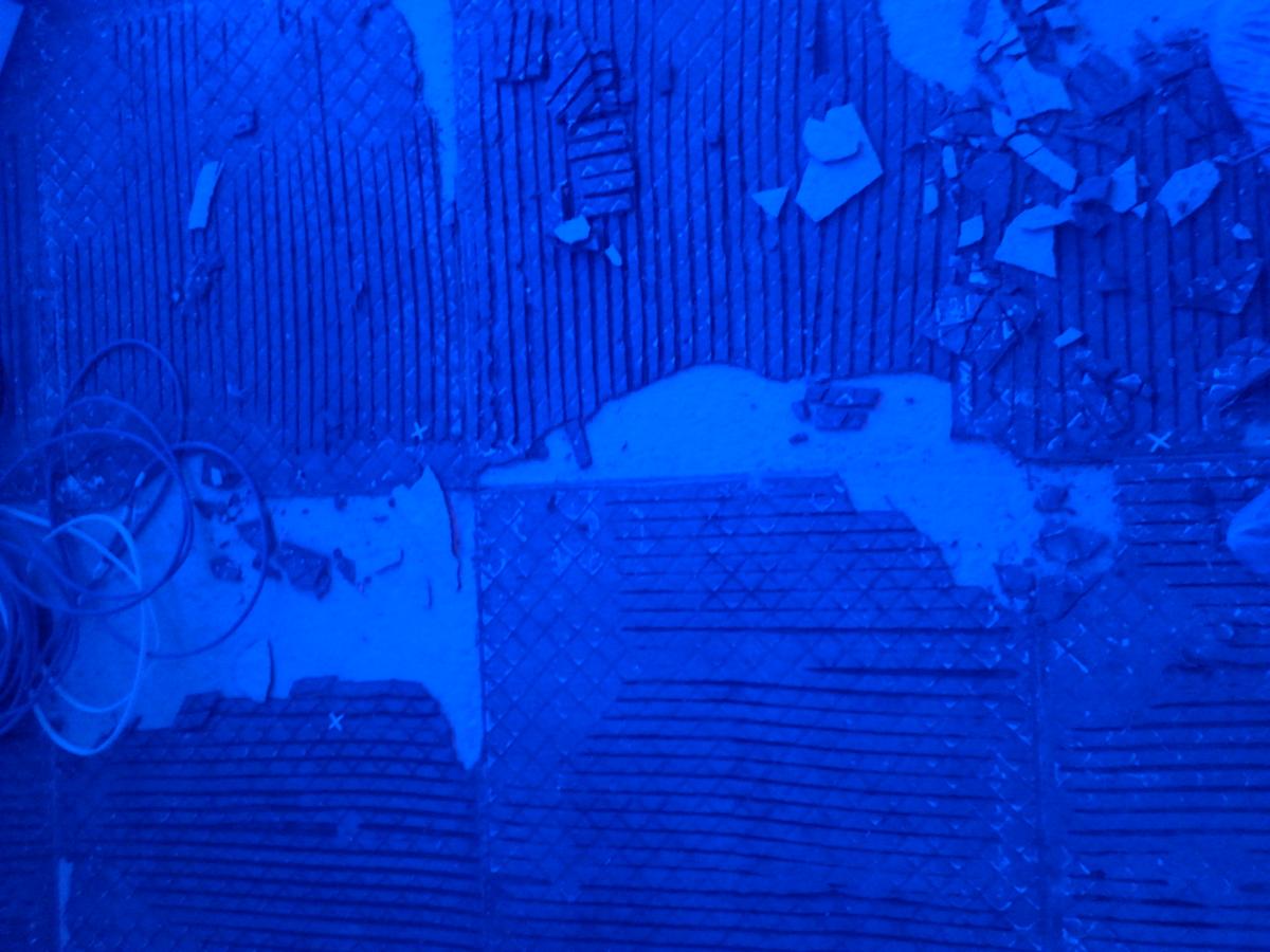

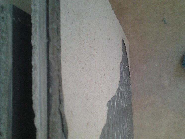

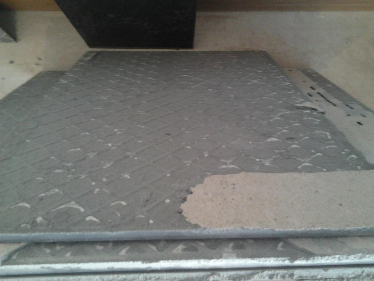

update, tiles where lifted by labourer on site ready for me to go back and tile. Retiled area today free of charge and guess what happened.... tiles failed again!! ... well not yet but i can tell they are failing. i managed to lift one by hand 5 hrs after setting! I think it must be dodgy adhesive

all materials where butech... uploading pics shortly. Floor seems to ok however i suspect its going to fail again!! Informed customer of my concerns but they where happy with me to carry on and see what happens. :-s

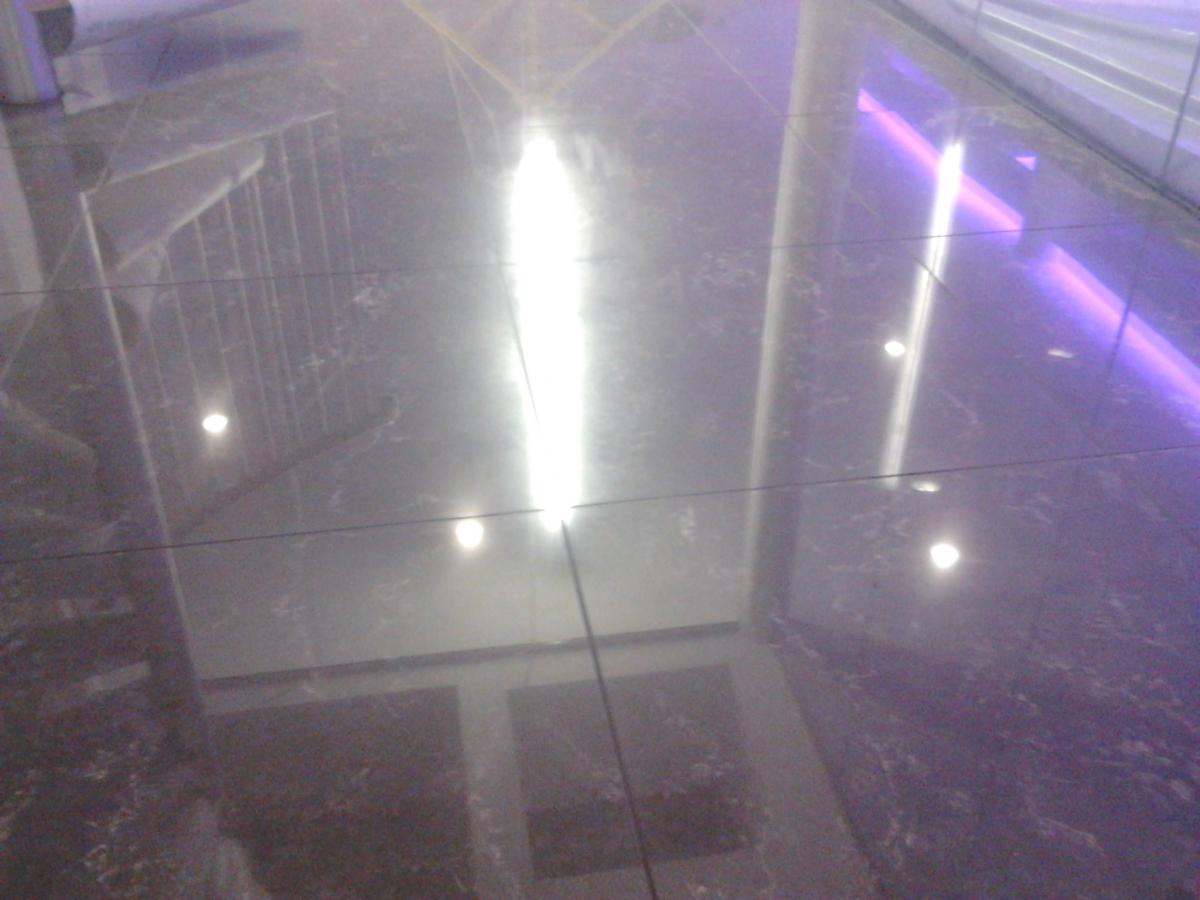

last pic is the tiles relayed, 5 hours after laying, they adhesive was nowhere near setting (butech rapid set), could pull tile up with hand and all sounded hollow. Seemed more solid on monday so grouted.... I wait and see now!
I stopped using butech 3 years ago, had it supplied for some site work and wasn't impressed.
Customer maybe happy for you to carry on and see what happens, but will you be happy lifting, cleaning and relaying a 3rd time?
