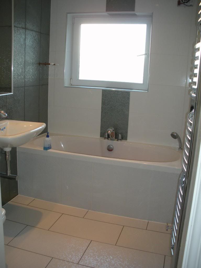

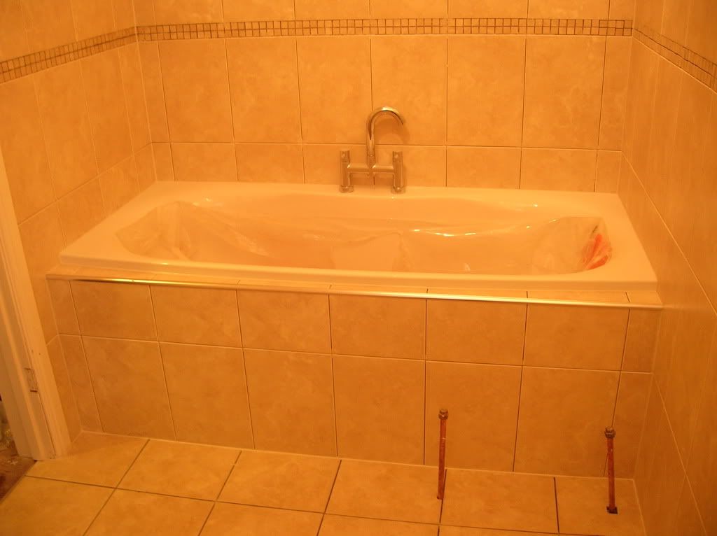

simhopper
If you've got a CTD near you, they sell Wedi which is my favourite for forming bath panels :thumbsup:.
Broken Link Removed
4x the price of hardibacker and wont do the job aswell,Will need to be braced and well fixed otherwise will move and flex
Daz
I've not experienced anywhere near that difference in price. I agree that the frame requires sufficient batons, but when you have formed an access panel it doesn't take much more effort to add a couple more batons to eliminate flex.
Hardi, Wedi, Kerdi or any other tile backer board will be better than ply as long as the frame is structured well.
