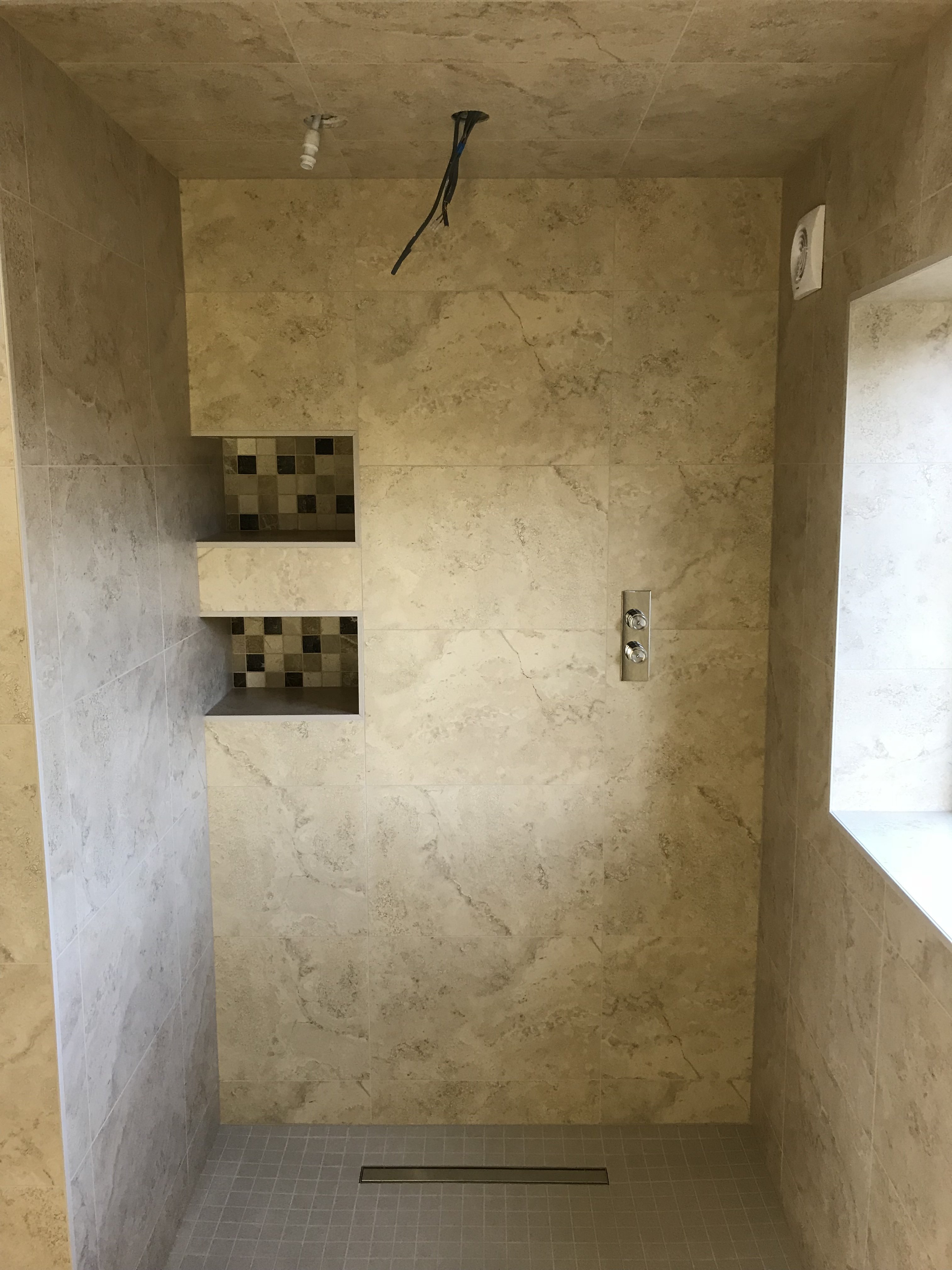

Frazer, here's one I did last year using the methods and materials mentioned above. There will be so much humidity up there using an XPS board is a must. Also use a good quality anti mould grout. If there's a good local independent tile shop near by go and see them, alternatively topps tiles although expensive, they sell all that you need
