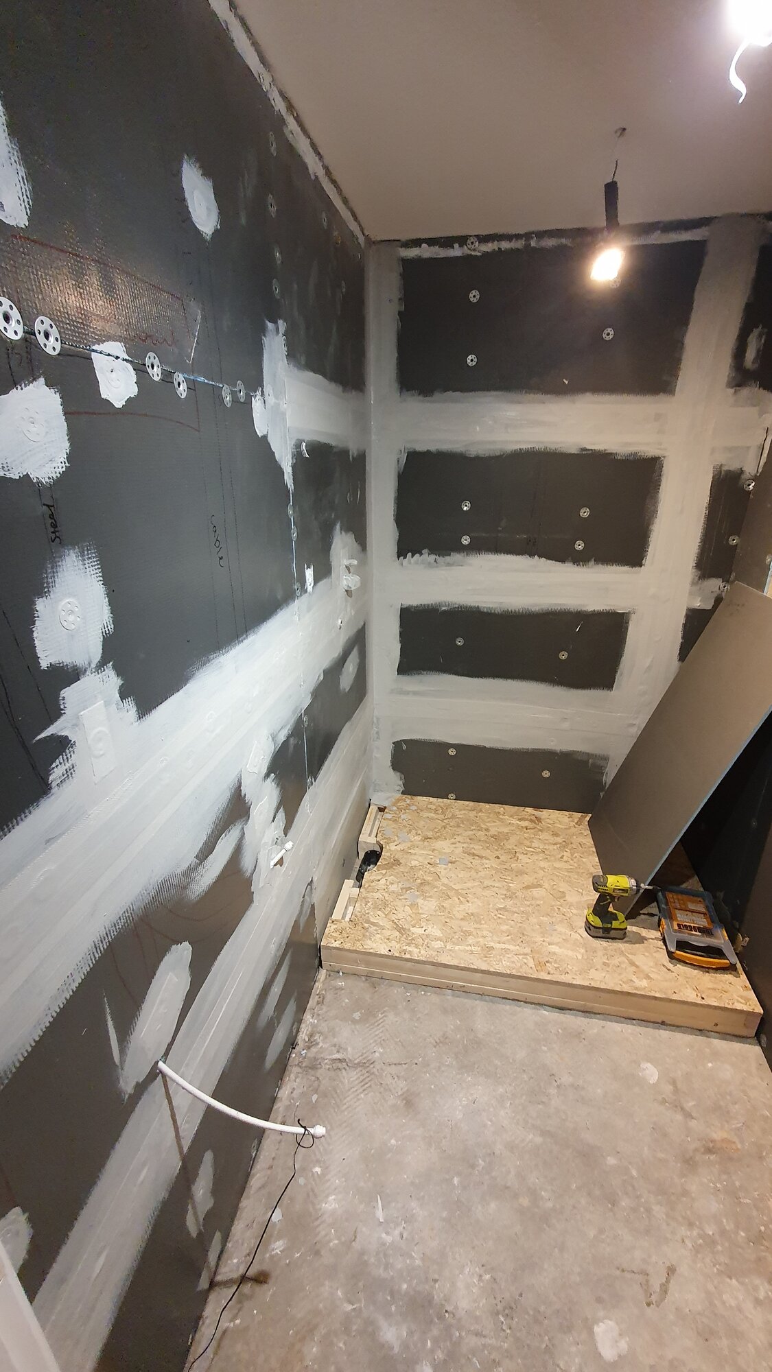

I recently installed a new ensuite walk in shower using Abacus Single Fall tray former. I had to build a timber raised platform to sit on the concrete floor (in a flat).
I topped with 18mm chipboard and then bedded it down (sorta) using flexible adhesive. The tray former got bedded down ontop (30mm thick former). I added backerboard to the side of the tray.

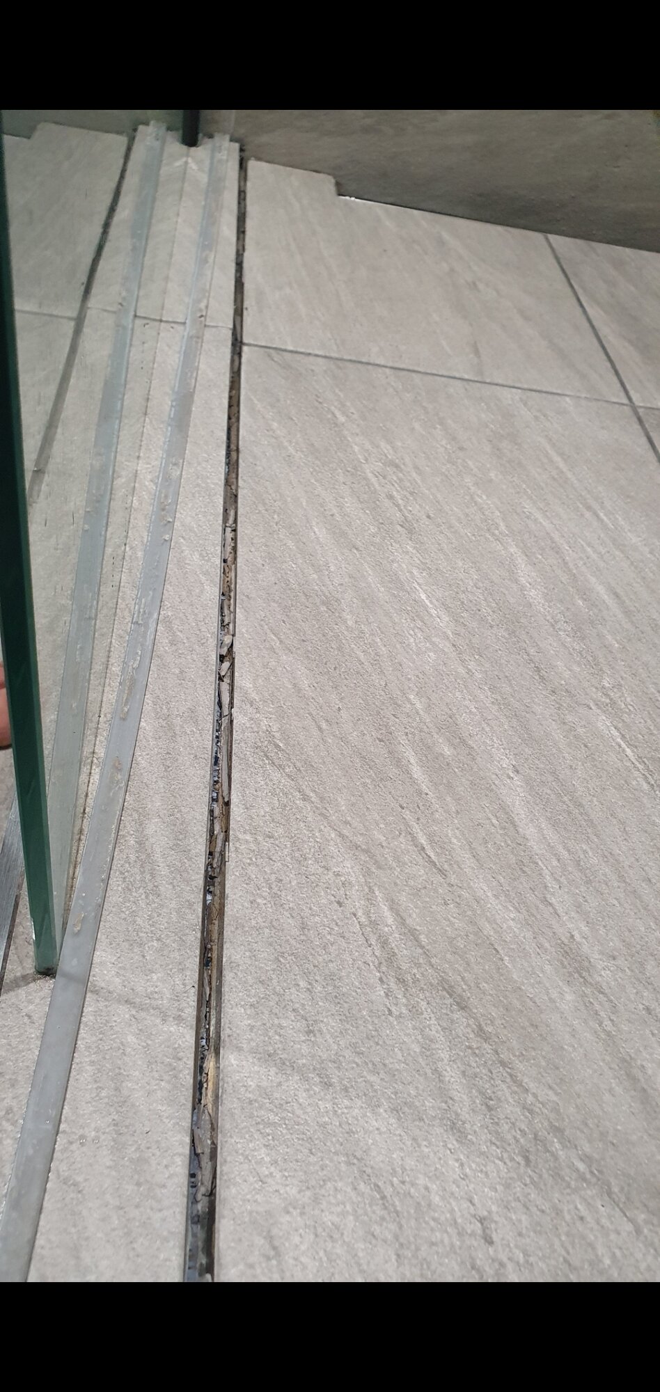

The tiler fitted tiles and it looked great for a month until I noticed a slight leak to the baseboard in the same wall on the other side.
It looks like the side ledge to the tray has pulled away from the tray and caused a long line where water can and has seeped through when the shower is on (photo attached).
I think where the tile sits on the former ledge it's levering the side away (as the raised platform has 10mm backer board attached to the side) - I can only assume over time stepping on it the tile has acted as a lever and pulled ledge away.
I have ripped the tray tiles up and plan to refit. I will not use the Baker board on the side this time to reduce chance of pulling away. Whilst re doing it is there anything I should change regarding the platform ie chipboard to hardibacker or ply - what thickness?

Get a good tanking kit, jacko do a good one with the primer, tape
internal corners and the solution to paint on. then a good flex
addy Bal or ardex and a good flexie grout again bal or ardex
but before all that make sure the base is realy stable

Would you suggest i remove the chipboard and replace with 18mm ply or hardie? before tanking
