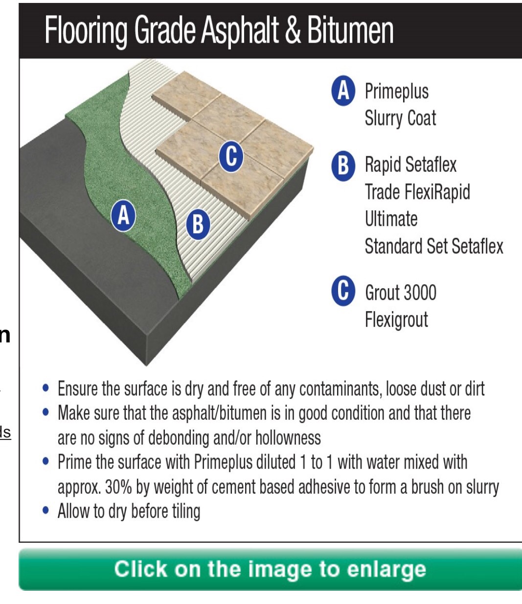

Prime with tilemaster primeplus slurry and tilemaster ultimate adhesive.

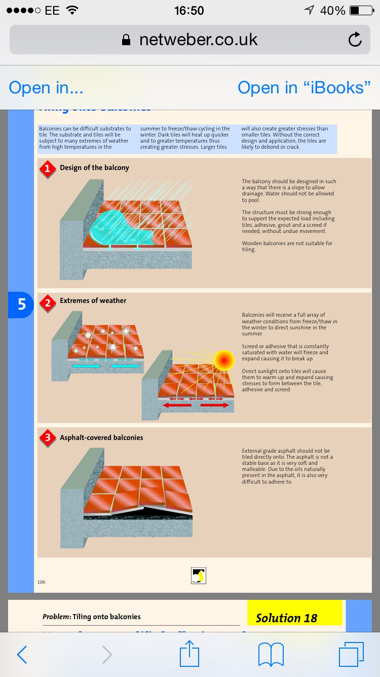

Is the asphalt exterior though? The oils in it are an issue.
I'm with @3_fall on this one.....
http://www.tilemasteradhesives.co.uk/docs/uploads/PrimePlus_TDS_2014.pdf
Could be worth a call to the tech guys but I've never known it to be an issue. If anything, new asphalt will be better than old as no or little oils leached out
Not a problem you with 3_fall but if it is exterior grade beware warranty. Webber won't guarantee it.
