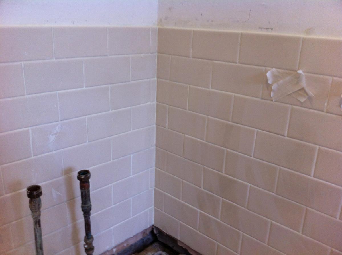

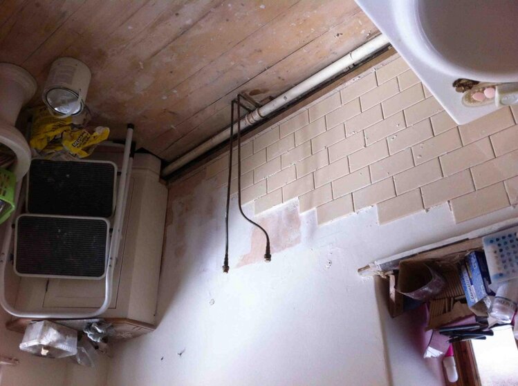

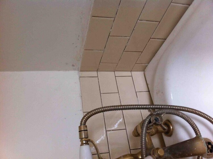

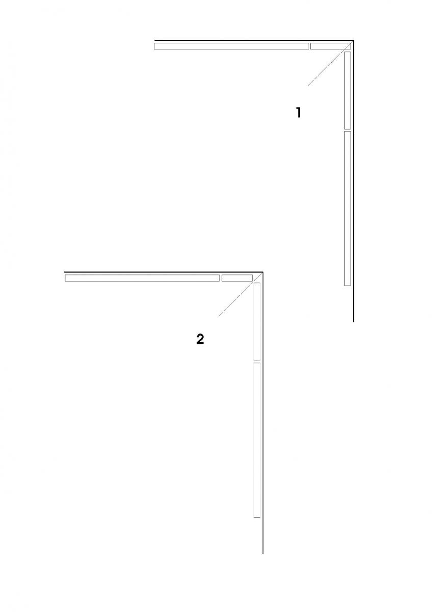

Would someone please try and settle a difference in opinion between my wife & myself re tiling into a corner. Photos attached, she says it would look better with two full tiles abutting in the corner then two half tiles below. Q: Who is right, either or both! Pics attached, sorry but I couldn't see how to rotate a couple of them.

You started with a full brick and half brick on the left and followed the cut around the corner, which has continued the brick bond pattern onto the next wall - it's ok but aesthetically a full brick and half brick in the corner may have had more appeal! Mind you in bricklaying terms a full brick into the corner will produce a half brick out in order bond the course.
Who is right - Errol Flynn.
AJH
Are you tiling any higher than that? The danger of starting with a full tile in the corner is if the walls are out you may end up with a gap developing
Not going any higher but that is a very good point as it's a cottage and I've had to compensate already by adjusting those corner cut so 3-1 to me so far
