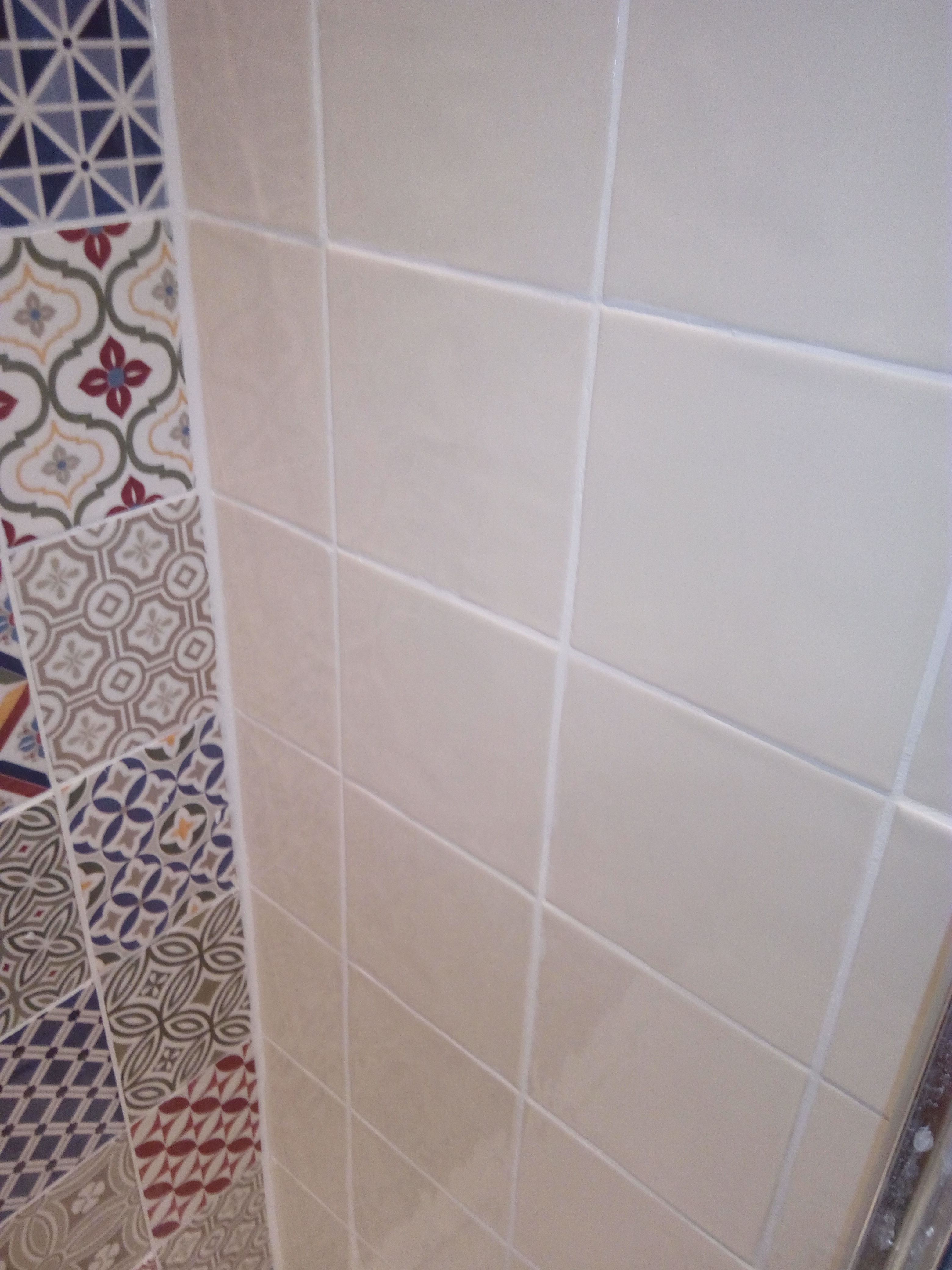

We recently had our shower refitted however have had some problems with cracked grout near the base of the shower. We believe this is because the 'plumber' didn't level the shower tray initially and had to pull it up possibly wrecking the tiling. Unfortunately we didn't notice until after we had paid for the job.
The plumber is offering to regrout (but not remove) the bottom row of tiles but we have had an opinion from a tiler that suggests that the job is lousy and needs to be redone from scratch.
Can anyone suggest whether this is the case from the pictures or offer advice what needs to be done to make this job good.
Would appreciate any advice.
I assume that the 'plumber' did the tiling.
The Tilers opinion on the standard of tiling seems correct.
Apart from your loose tiles, there are uneven joints, poor grouting and the feature back wall has not been set out from the centre - therefore you have unequal cuts to the corners.
As far as the plumbing side looks, there are no cover plates around the shower inlet pipes, if he levelled the tray after it was tiled he's most likely either not sealed the tray behind the tiles or he's broken the seal.
In general it looks a messy job which is only going to get worse. IMHO I'd strip the lot out and start again - but at what cost!

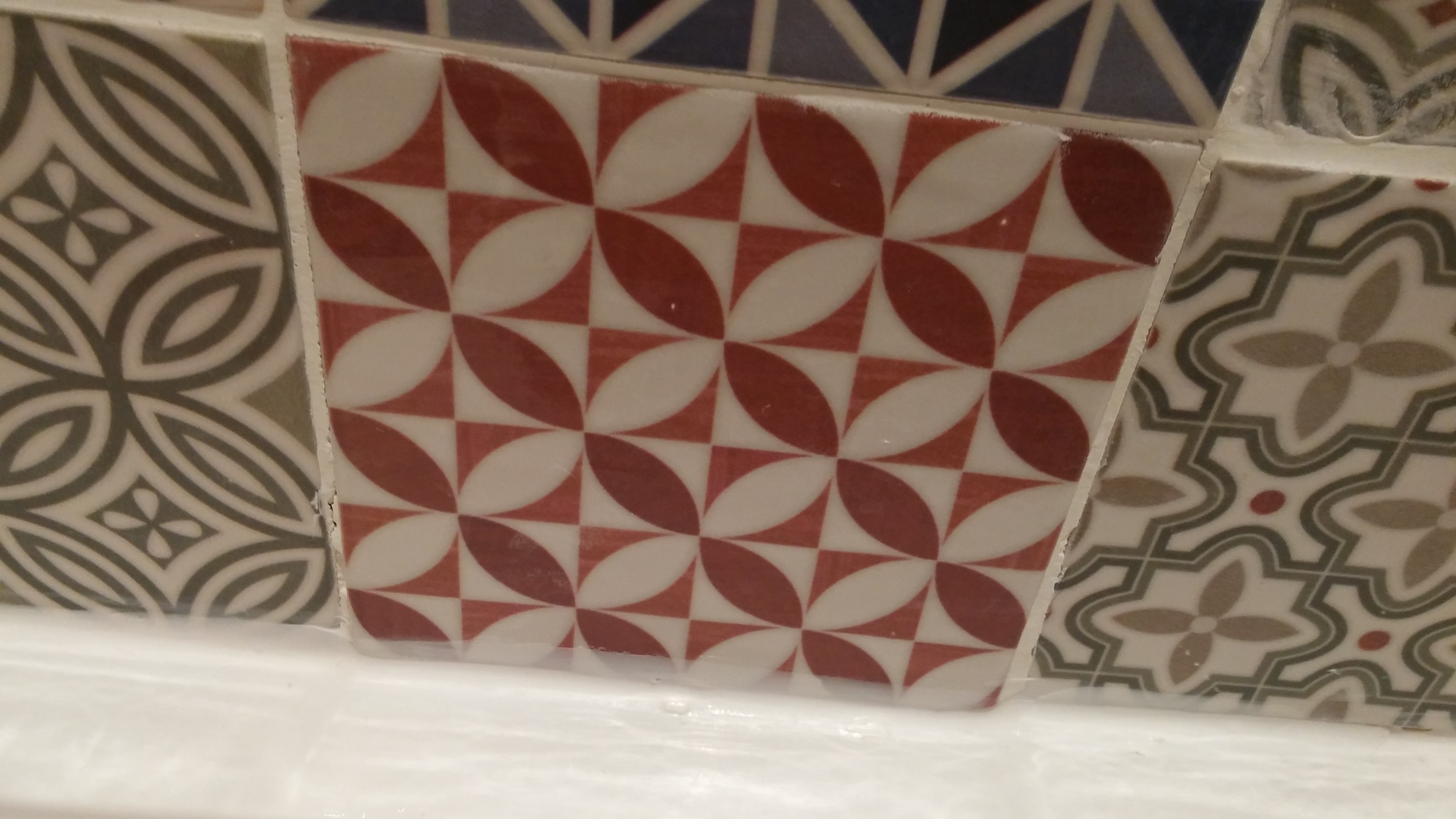

Those cracks certainly appear to be caused by movement.
All the tiles with cracked grout, do they sound hollow if you tap them, or even just sound different to those around them?
Can u feel any movement in the tray, or can you see cracks opening up when you stand in the tray?
The job around the mixer is not very good at all and needs attention cracked tile replacing and sealing, were there no cowls to go around the pipe?
Apart from the tile with cracked grout around mixer, are they all at tray level?

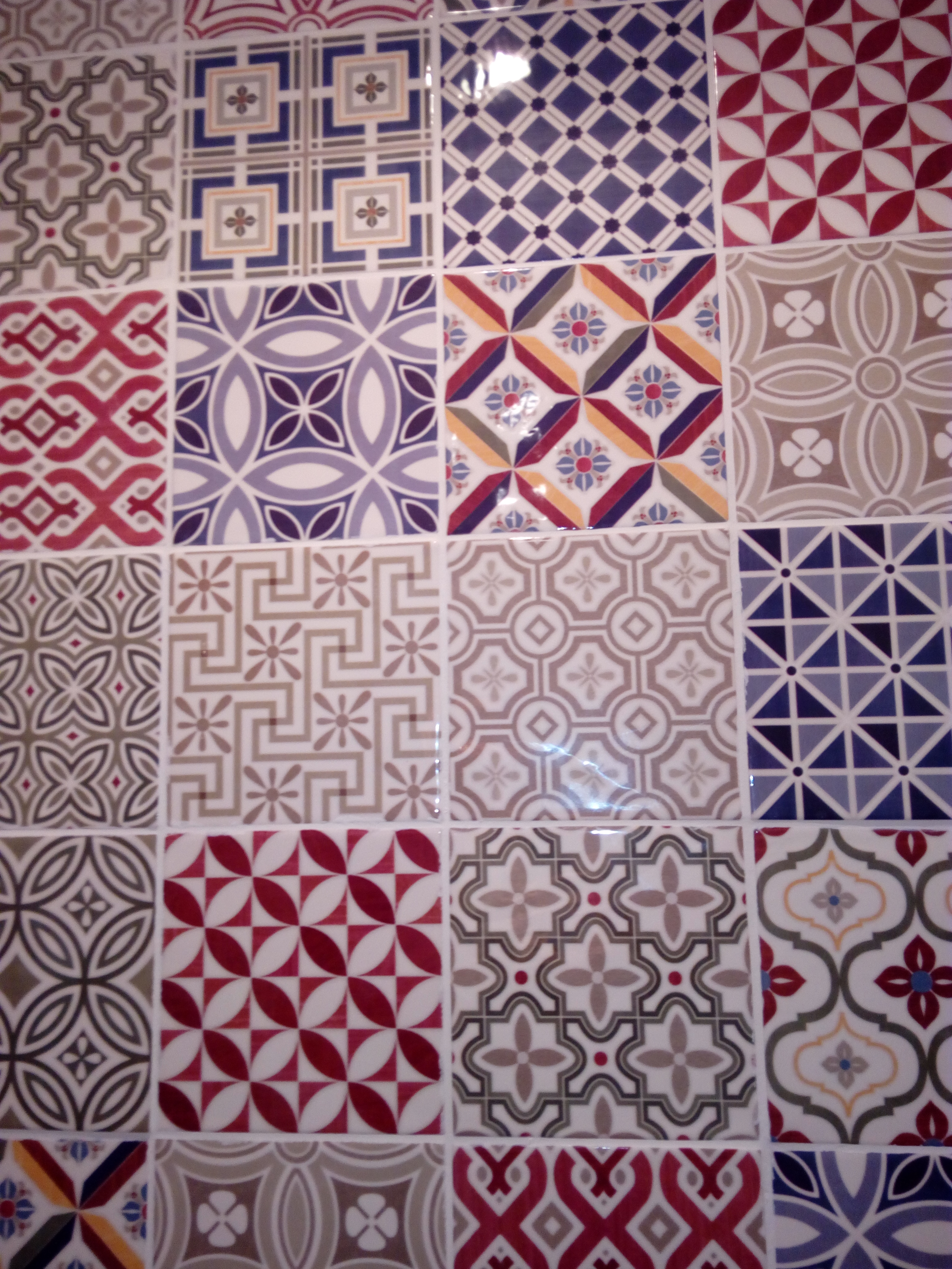

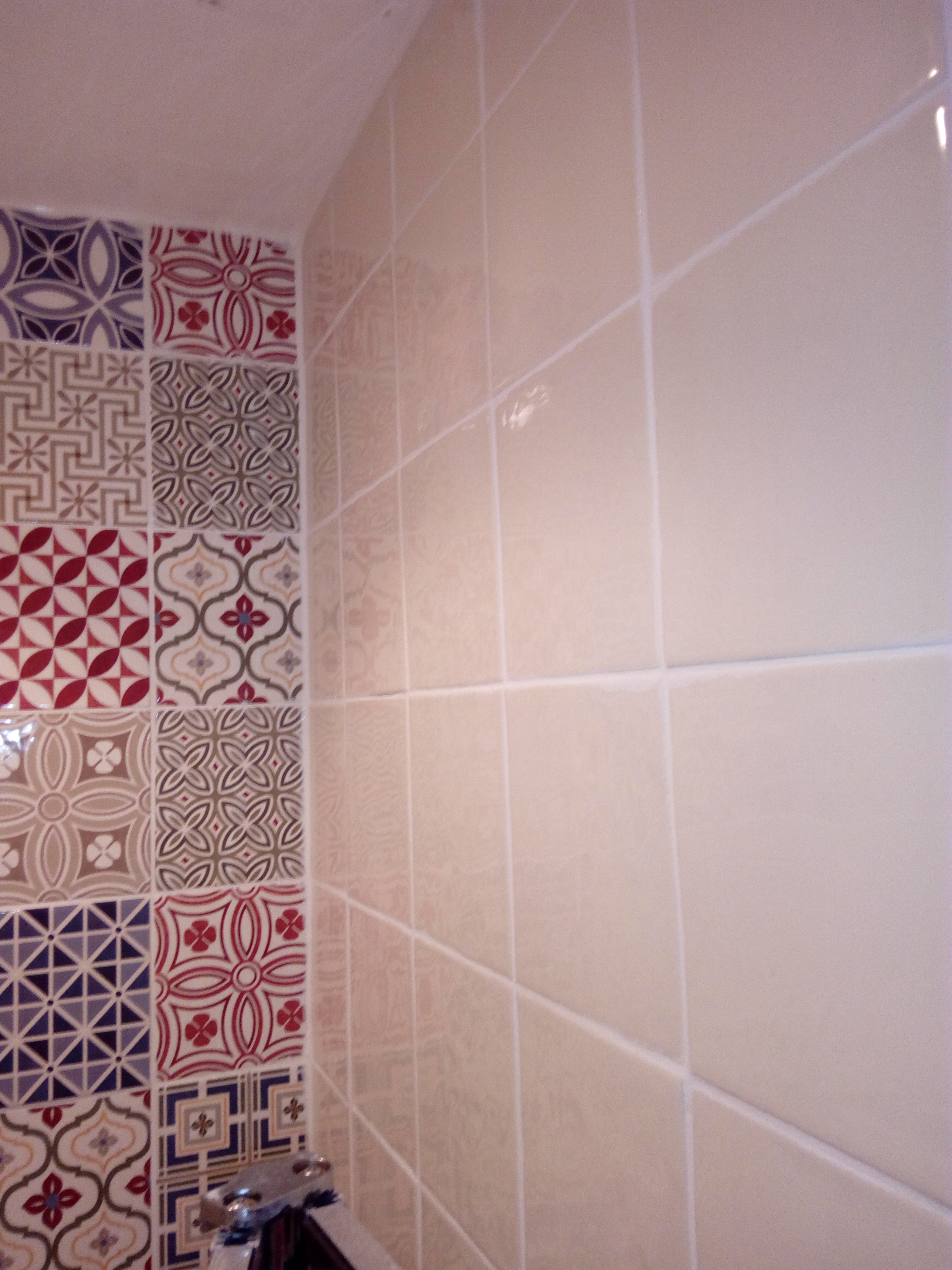

The first 5 images, I can clearly see why they're posted, the final 4?
Viewing on my phone, so images are small and it's not really apparent why you've posted them.
Is it to show the standard in general?

The cracked grout are all at tray level except those around the mixer. I can't feel any movement around the tray and suspect it was cracked just before Christmas when the 'plumber' lifted the tray to level it, but we didn't notice (or perhaps the cracks have deepened).
The final 4 images were to show the general standard - and that the problems appear to be limited to just around the tray. I had wondered if there was a solution whereby only the lower tiles & mixer could be replaced however it sounds like the job is just so poor quality it's not really viable.
