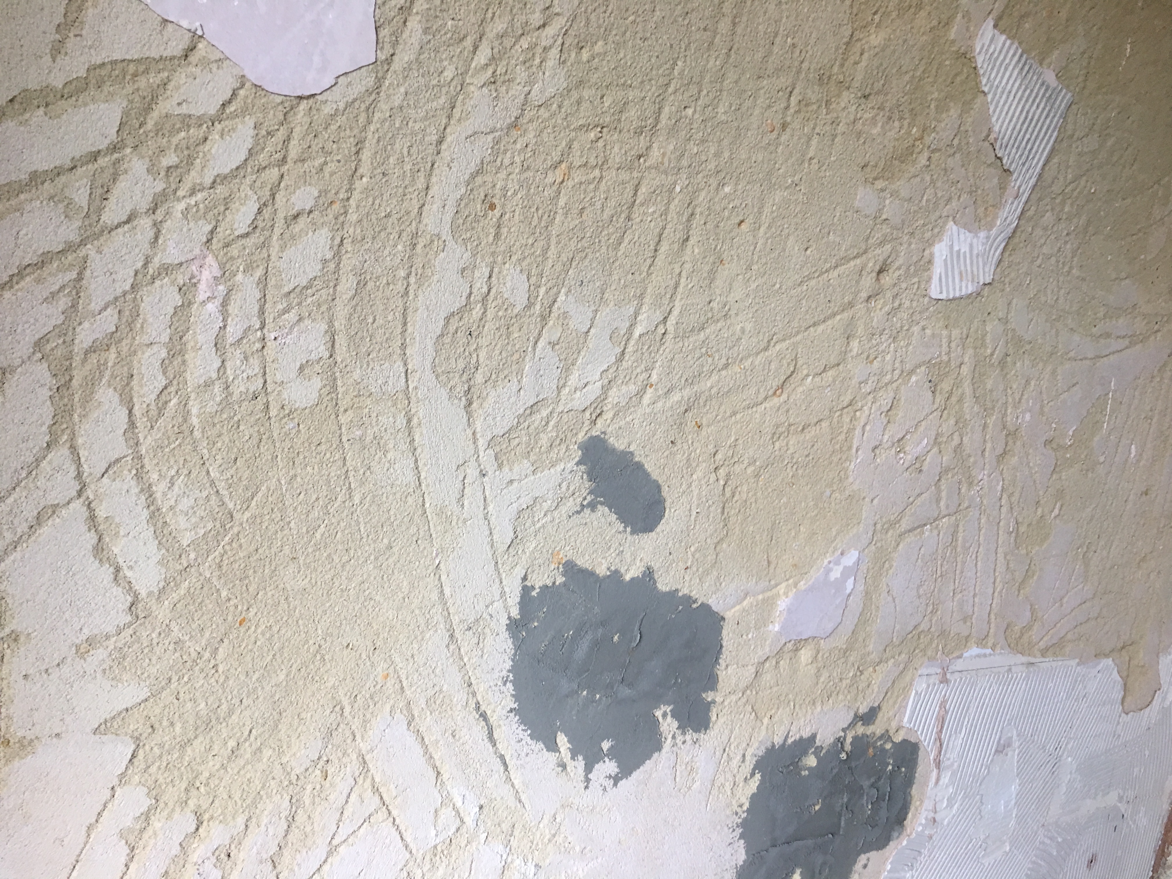

I'm in the process of tiling a bathroom with 600x300 porcelain tiles (24kg square metre) and was planning to use wedi board (well an equivalent) for the plasterboard wall but it turns out the wall isn't a stud/plasterboard wall it's a kind of cardboard waffle/honeycomb construction so there is nothing to screw the wedi board to.

Also there are a couple of outside wall where all the plaster has come of leaving a rough (bit flakey) render
I was going to board this as well but would it be safe to tile straight onto the render if it was flat enough.

Photos attached
In this circumstance (I would)
Scrape or steam off any remaining old tile adhesive and give the walls 2/3 good coats of diluted PVA, patch up any large holes and skim the wall with finish plaster.
And when the plaster is dry, prime with diluted SBR liquid and waterproof the walls to be tiled with a tanking liquid.
Not an ideal scenario regarding kgs/m2 though

What's the other side of the "cardboard" wall? Could you do anything the other side to be able to mechanically fix the wedi?
Spring toggles, normally used in plasterboard with cavity behind, they have wings which spring out behind boarding, and screw in to lock in position. Another option for fixing board , is hollow wall anchors. ( needs a setting tool though).
Sound interesting but I just wouldn't have confidence in the whole lot not falling down on one of his kids heads. I can't believe how weedy this wall is!

Yes this is the bath/hall wall. I'd be happy to tile it with lighter tiles... well if the surface was tided up a bit.
i came across this once but i was only fitting light tiles and got away with it.but during a search for a remedy i came across a post which said to carefully cut the inside gyproc and remove it and the honeycomb there is a 35mm stud top and bottom to build a new stud frame puting glue on the framework to stabalise the hall side. and when the hall is getting redecorated again screws can be screwed in from the hall side.probably be a big job but might be helpfull to you.
Thanks for the suggestion scooby I don't think it's an option for this job but I'll keep it in mind for next time

That wall is called paramount board. Essentially it is a cardboard waffle sandwiched between two 12.5mm pb sheets. The waffle provides the strength.
My recommendation- do the job properly and remove the bathroom side pb sheet and waffle, build up a 3x2 frame within the wall space (with the CLS on its side) and re sheet with pb or tanking board.

This. Just had our bathrooms redone, and found that they also had this "cheap and quick to throw up" material. Our plumber took the top sheet off, got rid of a honeycomb where he ran new battens, screwed them from the outside and put up hardiebacker (room was being tanked in WaterGuard anyway, so cheaper than using wedi board or similar).
Your tiles are already at the limit of skim, and over when you factor in adhesive and grout.
