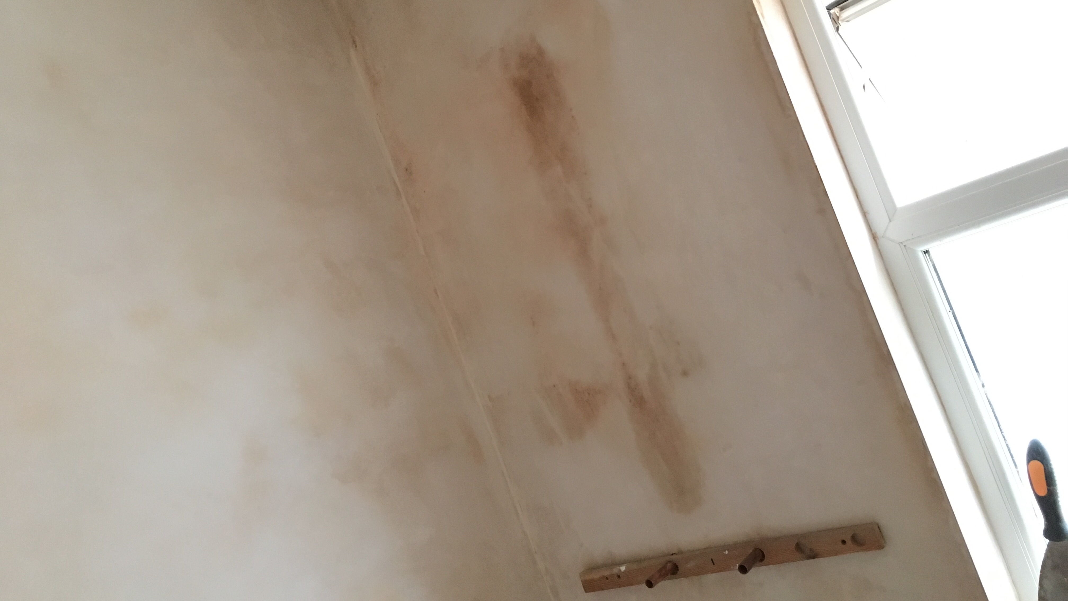

Oh well just gotta wait for plaster to dry now. This one section that was a chase that has been filled in (with bonding i assume) doesn't ever appear to get any dryer, it is on the outside wall so understandable i guess but still would be good to see even a little progress

You may have a small weep in the pipeworkinside the chase. Or has he plastered over the showerhead outlet?
