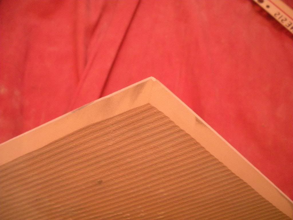

reverse the tile and put your wet cutter on the 45 degree and take the back off the tile.I would use a rapid set adhesive such as mapei kerraquick as you havent said if the tiles are porcelain or not and you havent told us the substrate which needs to be considered for weight issues also i would use a powdered adhesive for tiles that size anyway...dont use tubbed gear as it will take ages to dry if at all.
I cut a mitre on the back of the tile where the wall meets the ceiling slope just to keep the joint neat don't no if that helps you

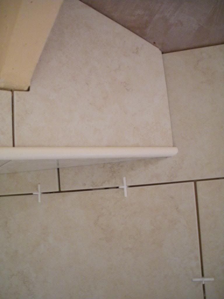

not a very good pic but same kind of problem, having to mitre the back of tile:
also these days the tiles are to thick to sit on a shower tray (with the rear lip)and they stick over the edge so you have to mitre the back away also to let the tile sit back so it does not protrude over the edge.
nice work sean :thumbsup:

the angles dont need to be perfect just as long as you take sufficient material off the back of the tile. i just run the tile through the wet cutter by hand, you get used to it and basically you can get what ever angle you want by eye.
