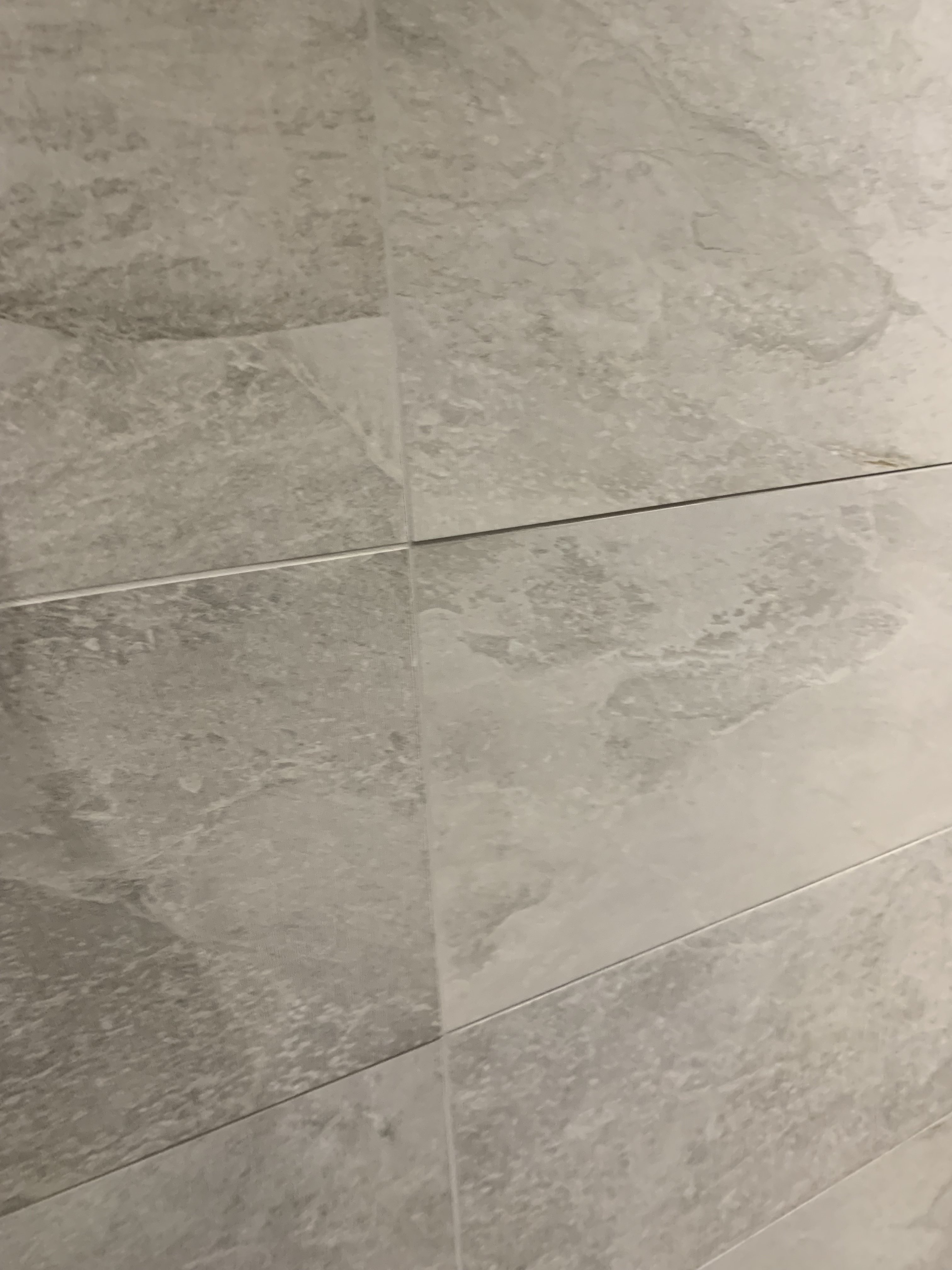

I think you're being over critical, you chose the worst grout possible for those tiles, and it's shown up in the ceiling. I've seen worse.
Are there other walls done, around a window maybe, to see what cut would have bee left on the head/sill?
That sliver (I wouldn't even call it that, I've done smaller cuts) wouldn't have looked so bad if the ceiling was level.
Simple solution, take light fitting down, over board, skim, paint, refit light. Kill 2 birds with one stone, small cut disappears and you won't notice the cocked up ceiling.
