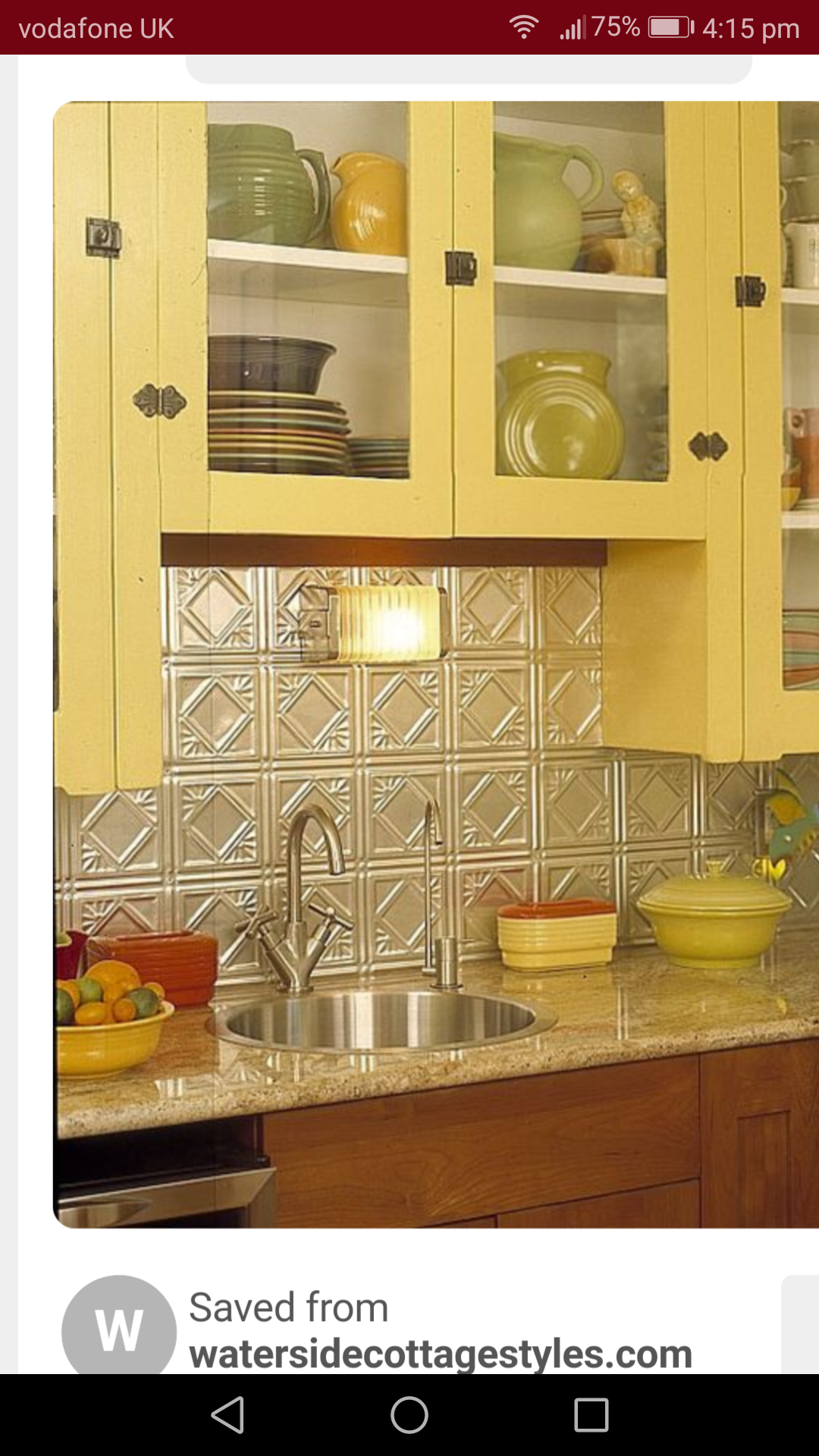

Got a customer that wants these tin tiles in her kitchen....
Has anyone fitted this kind of tile..?
If so how do you cut them, what adhesive did you use, I assume you don't grout them..?

Basically lay them out dry on the floor, and pre cut with tin snips to the areas measurements, and then stick em. Various methods suggested :D
But at worse I’d say prime backs with a grit primer, and stick with an S2. Like sticking to metal.
