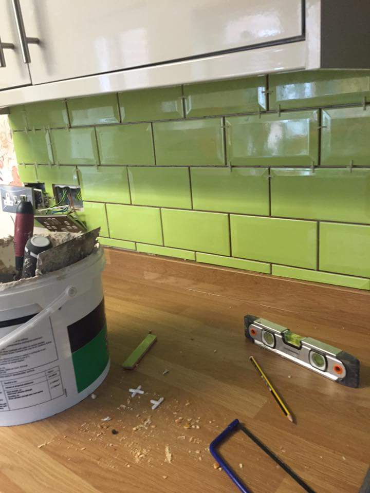

Andy Allen
18,308
1,318
Gloucester
Like this..
