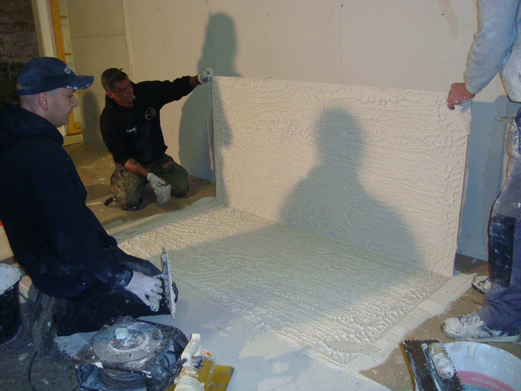

This is a training method employed by @Ray TT @ Porcel-Thin
at his training days to set thin porcelain, here's an example.
Here we were experimenting with different adhesives, trying to improve coverage.

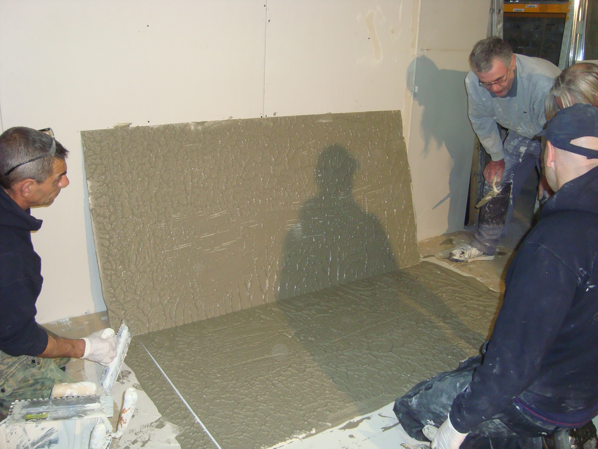

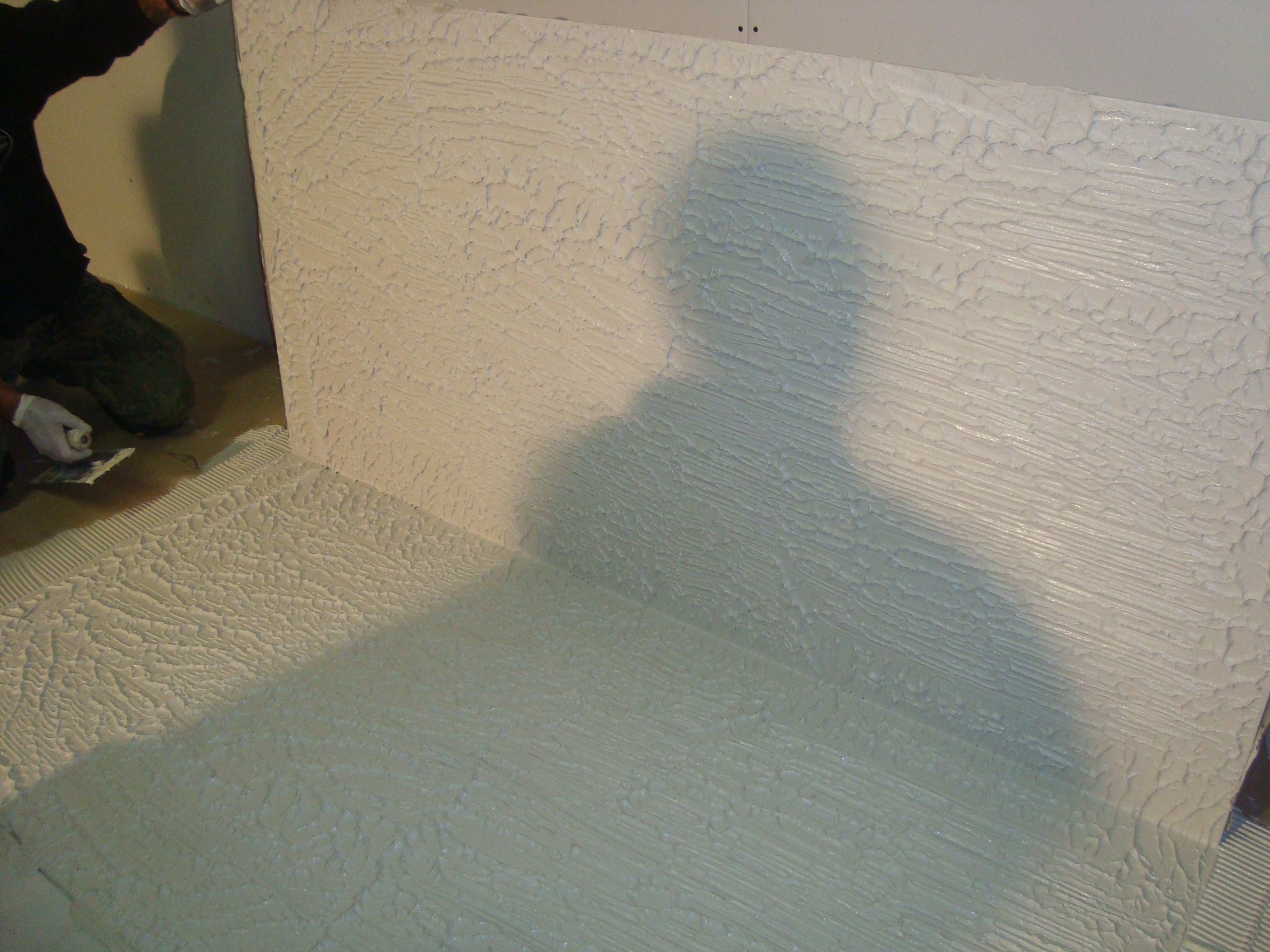

And below were examples of different adhesives used.
As u can see the third example in grey barely achieved 80%
But ALL were trowled in a single direction.
