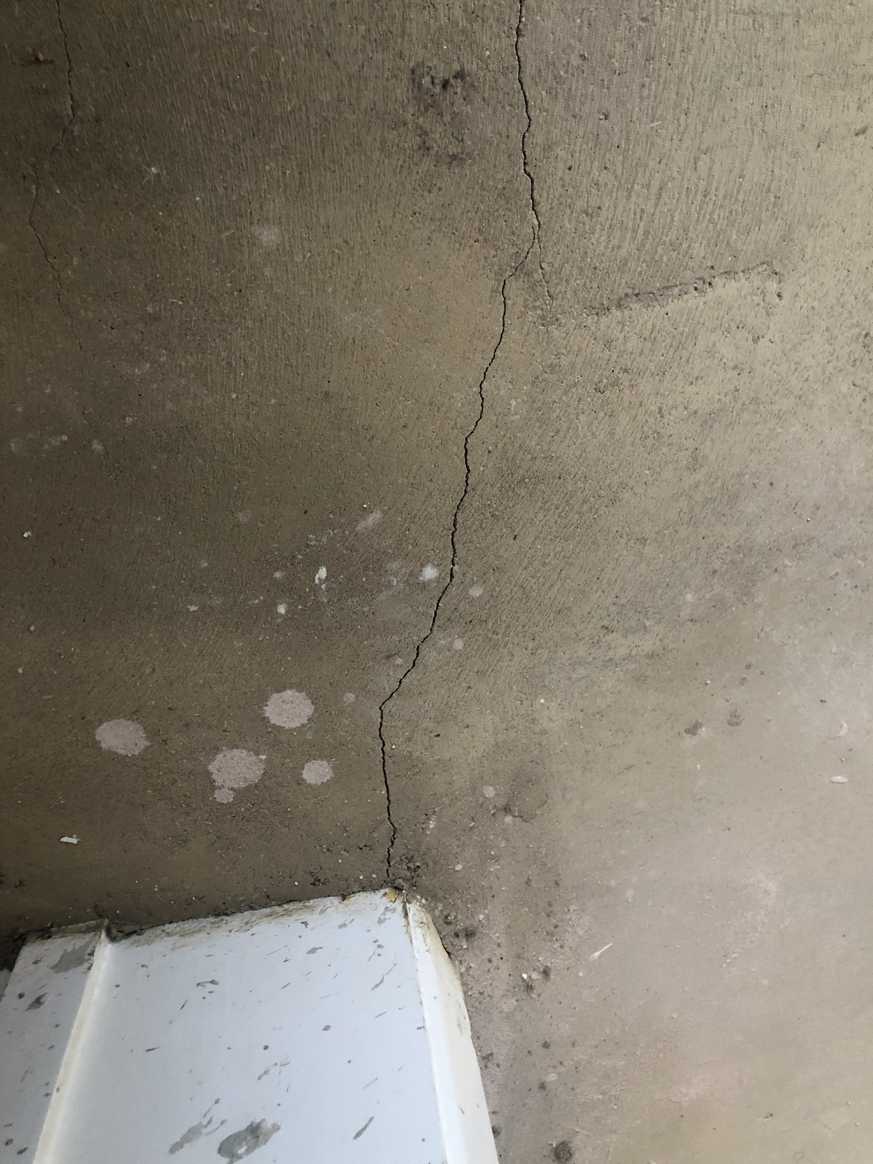

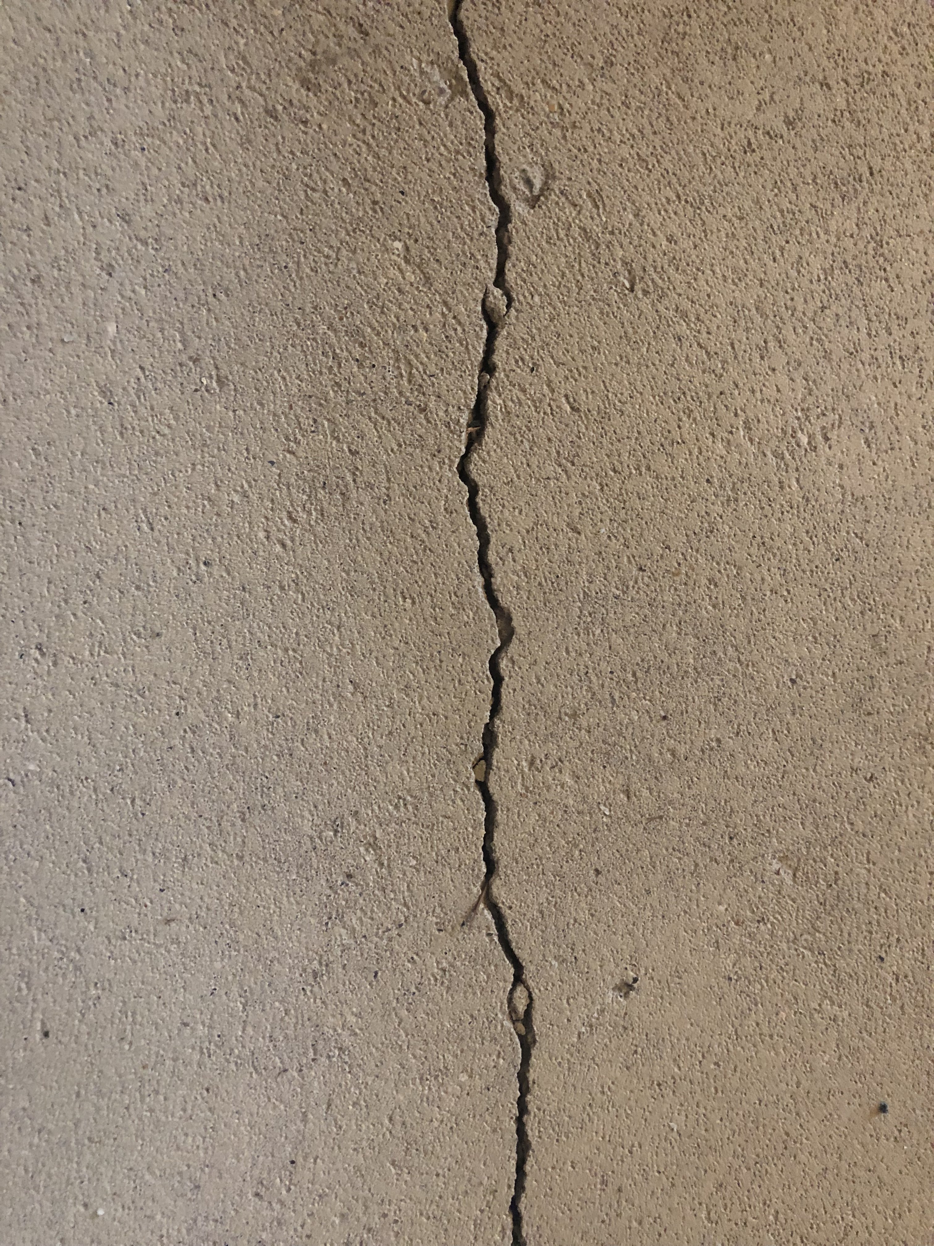

Attaching the pics of cracks below
They are quite prominent near door areas. The screed is 70 mm

That crack needs investigating. If you have more like that, something has been done incorrectly I suspect.
Especially if you haven't ran the heating yet.
That could be shrinkage (too thick of a screed and dried too quick?) but could be wrong stuff used maybe too.
It's out of my league. But that's not a nice new fresh screed on top of UFH. Somethings gone wrong.
I wouldn't cover that up yet until you know why it has cracked so badly.
I've never seen a screed crack like that before and I've seen a fair few new screeds when UFH is involved. Usually get a little near where pipes come out the floor for radiators and things like that. But never a huge crack.
You got a photo of the floor from further away to put that picture into perspective? Maybe it's just a close up and doesn't look so bad when standing near it...?

Sorry I missed this picture. That puts it into perspective.
Yeah that crack is huge. And to get splashes up the wall like that, perhaps was far too wet when put in. Not sure.

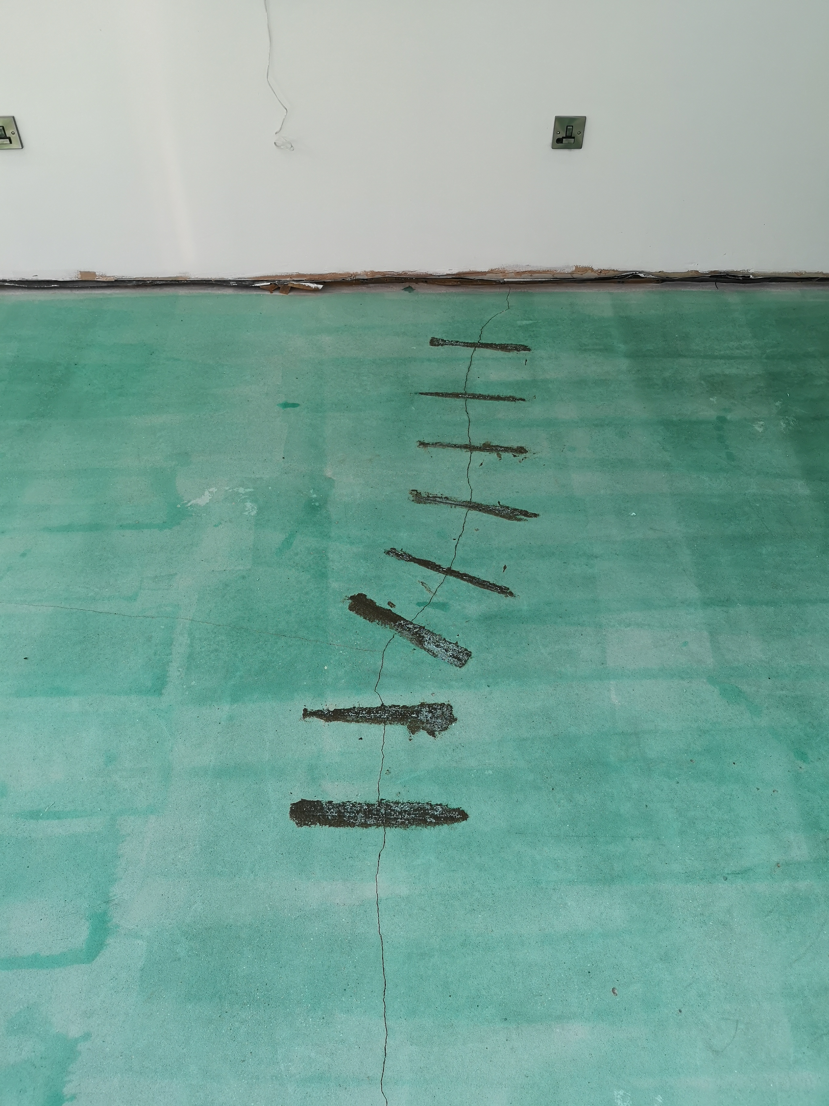

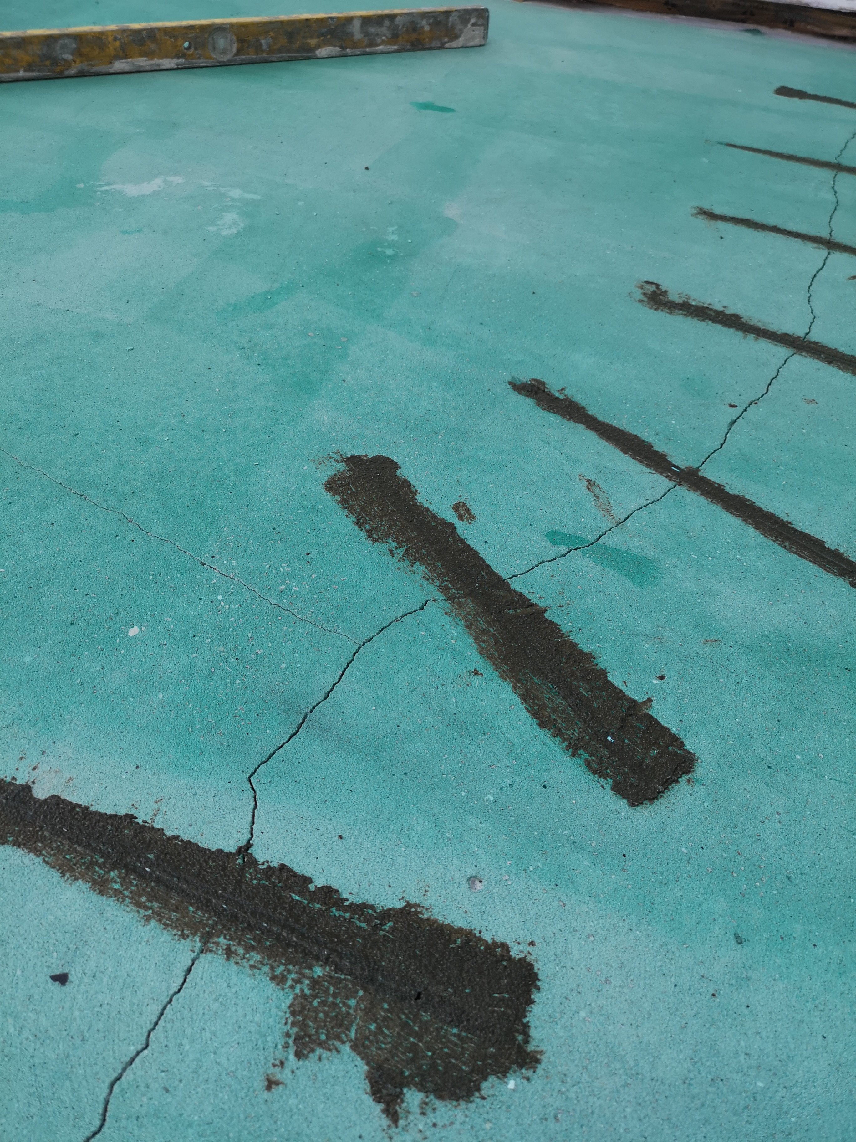

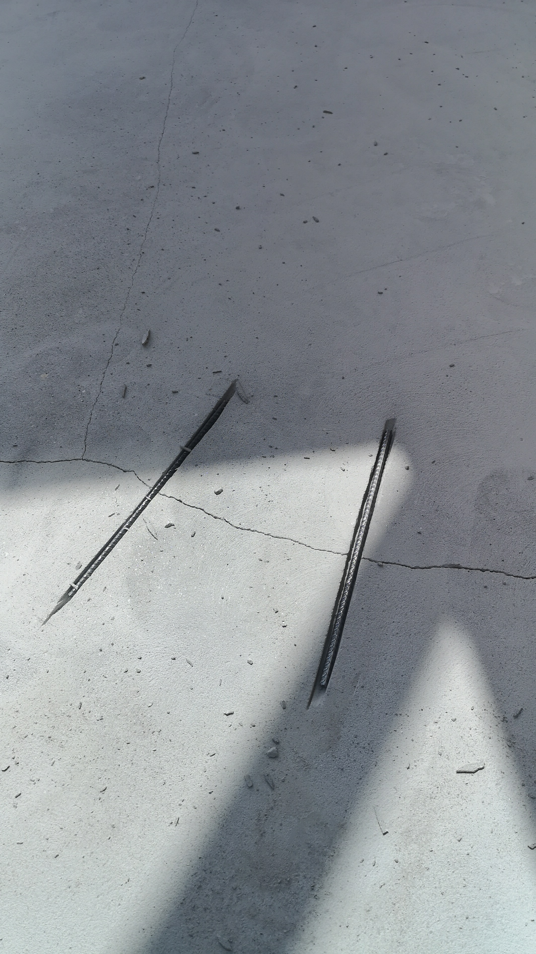

I've seen cracks like that often and it's not the end of the world. It's more than likely shrinkage. Commission your ufh correctly and see what the floor looks like after that. You can carry out a resin repair and reinforce with rebar, then fit uncoupling membrane and tile. Ditra and such like actually improve the performance of under floor heating as the channels in the mat help dissipate the heat evenly. Here is a repair I did on a crack last month

I wouldn't like to fit to a reinforced floor that's been retro reinforced.
Not that I even fit to any floor mind.
But if I did, I'd want another layer of something over it I think. Hide the cracks. Even if just from my own eyes lol
View attachment 109635 View attachment 109636 View attachment 109637 View attachment 109638
That reminds me of a carpenters fix when they make tables out of split tree trunks and use a sort of >< shaped bit of wood to join the spits up. Table top ends up looking awesome and is stronger than without any crack in.
