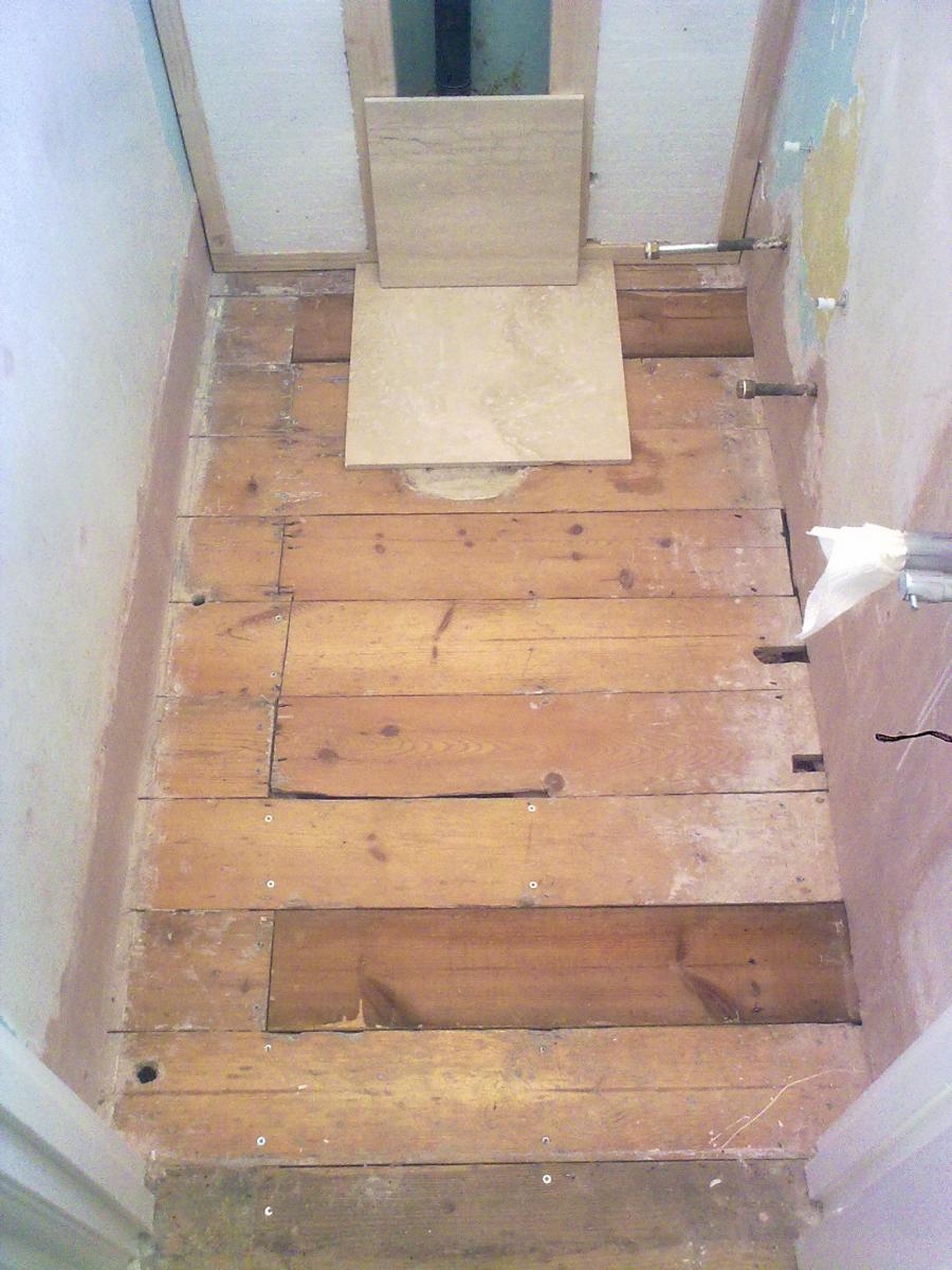

Any pics of the floor in question?
The tiles at the back are laying loose just for viewing/orienting. The main joist runs down the centre and the others are 12" to the left & right. No movement in the floor at all.
