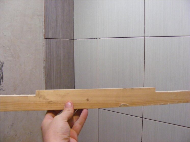

DSCF1176.jpgi made one of these to help with the hight difference, to screed to a level with rapid set, so mosaic would bed flush and easy. sorry ripped this idea from dave i think.
I think Phil Hobson was the original designer of this tool back in the 1920' s when he was an apprentice 🙂 it's not stealing anyhow, just using great ideas shared on a great forum.
Sent via Tapatalk for iPhone
Thank you so much, everyone, for your opinions and encouragement! Thank you, jwatson, for sharing the picture of the tool, that's really helpful!
