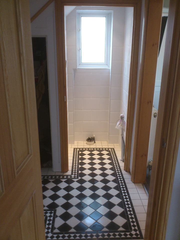

Hi fellas, got the last thread all messed up couldnt work out how to attach photos. Think it turned out well, customer well pleased which is the main thing. Heres the finished floor with downstairs loo. victorian 2.jpg

Nice job mate, but is it me or is something badly out of square there. Not being funny, but that is why we use a variable. Easy to judge when we are not on the job, sorry if I am wrong, just needed to ask.:thumbsup:

i can see what phil has picked up on. your boarder along the left hand side of the hallway seems to have drifted in around 20mm. you start off with a cut (approx 20mm) to the tips of the diagonal field tiles and then you have what looks like full diamonds towards the far end of the hall way..
good effort though mate! this aspect of tiling isn't easy to get 1st time so well done.
