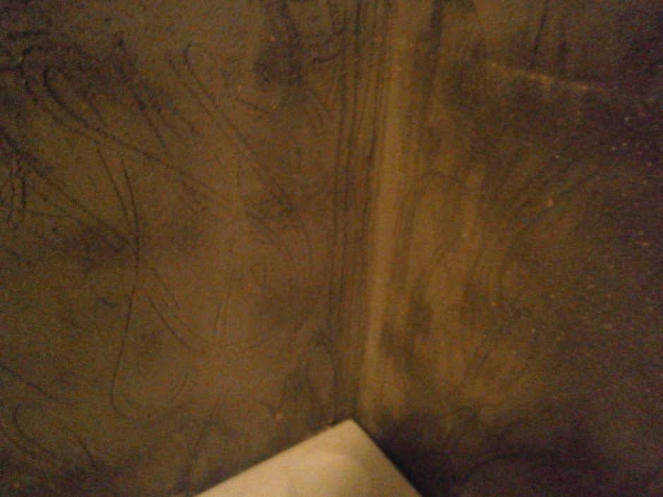

The walls were prepared as follows:
1. Plaster hacked back to bricks.
2. Bricks mechanically cleaned so no trace of plaster.
3. Cement render coat applied to all walls about 12mm thick. (fully cured)
Do I need to use any tanking system?
I cannot remember exactly what the render guys did. They were from a damp proofing company and I think they mixed sand with portland cement and added something to it. I think the additive was SBR. The finish is deliberately rough and scored.
I tested the wall to see if it was waterproof by directing shower spray over it. This did no damage but the render did absorb some water and took 24hrs to dry.
In the picture, the wall going left runs along the bath and the wall on the right is where the shower will be fixed so the head is pointing leftwards away from the right wall.
The left wall is the inner leaf of a brick cavity wall (uninsulated) and the right wall is a two brick thickness sold brick party wall with neighbour.
I think the neighbour has a shower the other side without any special tanking so some moisture may migrate into my side but you cant tell looking at it.
The tiles are 60cmX30cm X10mm glazed porcelain with 4mm Ultracolour plus grout.
Is the cement render background waterproof enough for tiles to go straight onto?

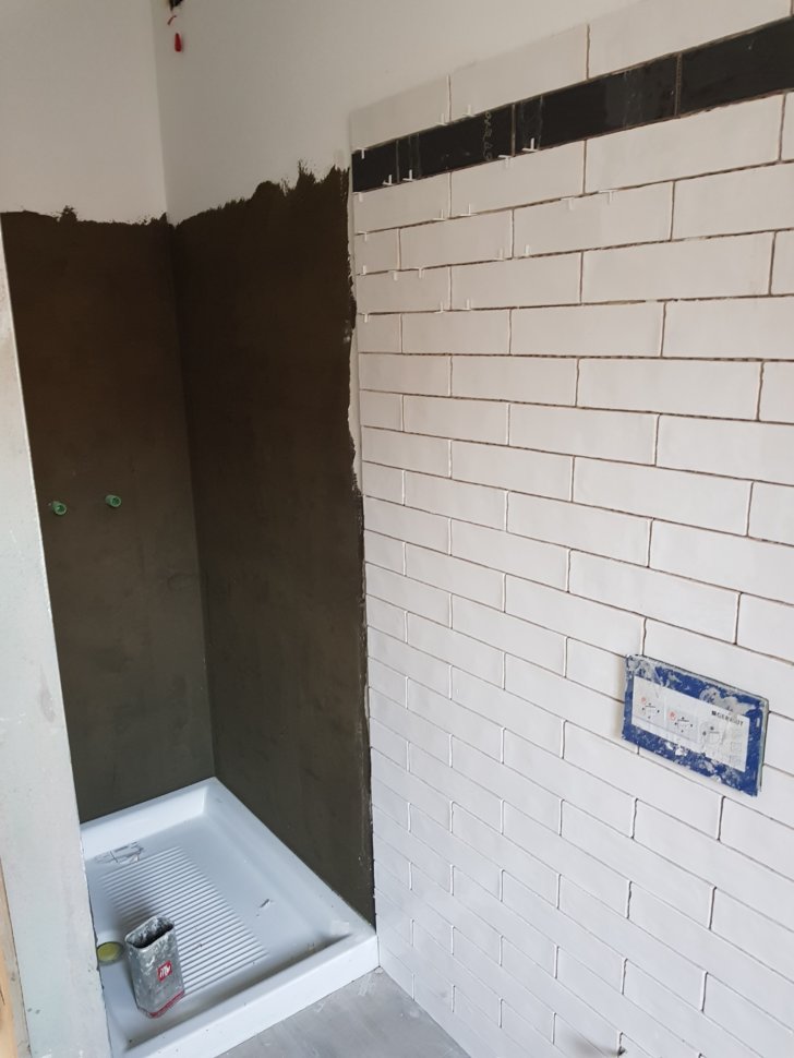

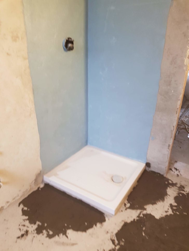

yes, you have to tanking all the walls of the shower equally,
no need for strip in the corners,
being a solid wall.
finished tiling, Silicon in the corners
between wall and shower tray.
ps. before tanking, apply Silicon between the shower tray and the wall.
here in Italy they are almost all like this.
