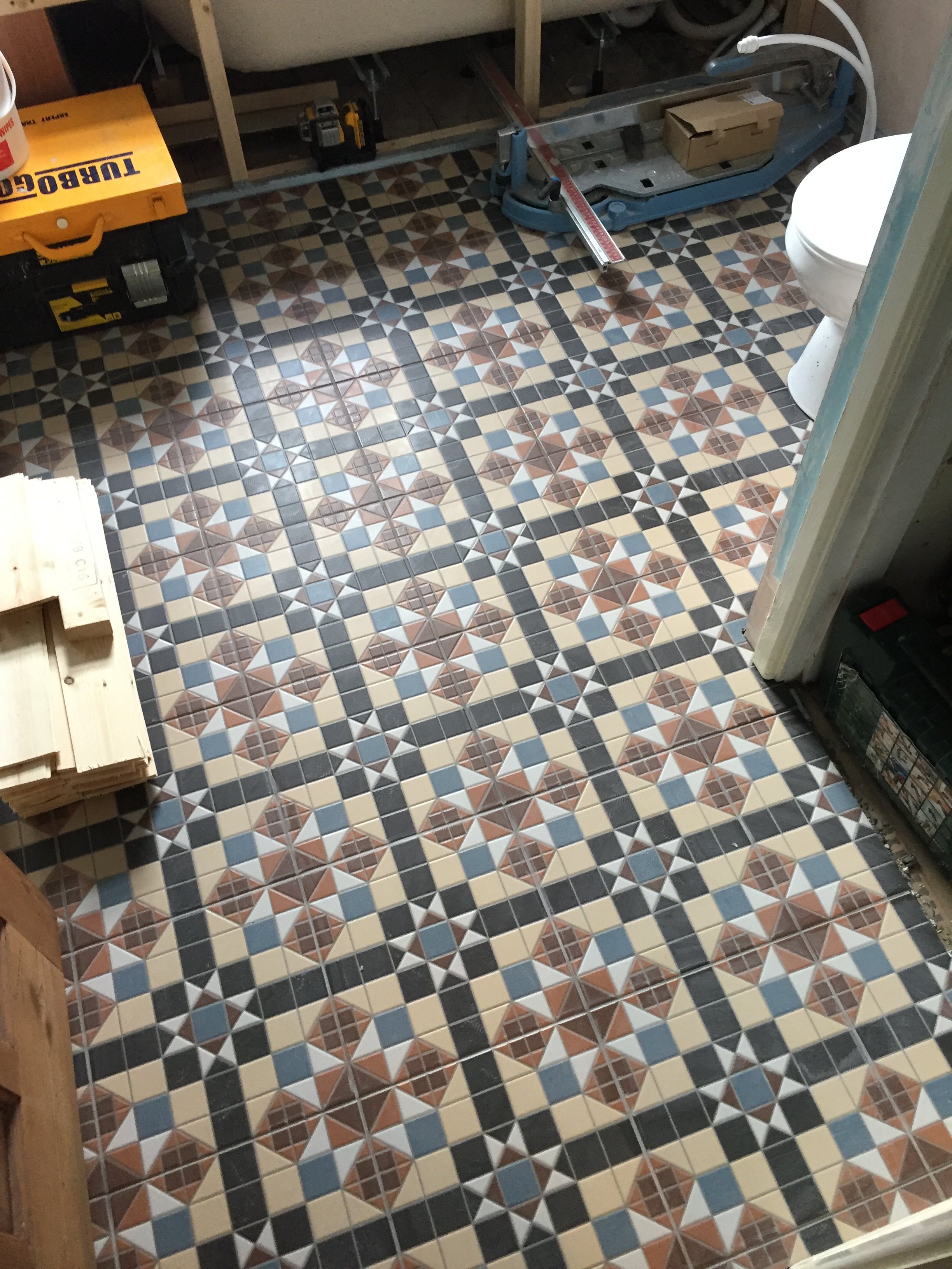

Just doing a bathroom at the moment, and used some interesting tiles that I haven't seen before, they were a bit of a pain to cut, as they have fake grout grooves in them, so couldn't score them to cut, had to angle grind every one!
I think they look quite good when down though, what do you guys reckon, and what's your guess at the cost per square metre?
btw - this pic was taken before I'd polished them off.
I know, it's a 3mm joint, didn't really want to go smaller than this. A 2mm would have been better, but really you'd need a 1mm for it to look the same!
Oh ok, I'd of been tempted to go down to match, depending on substrate.
I'm sure client was made up tho mate, nice job!

And in the background you can see the Dewalt laser that I bought, based on your recommendation! I do really like it though! Whilst on that subject, do you ever stick yours to angle beading behind plaster? I find it's right on the verge of being too heavy for the magnets to hold it. It does hold, but the slightest touch and it falls.

Topps sell a version of this tile I've used on a job with my dad and there was no way u could do a 1m joint the tiles were to badly sized
