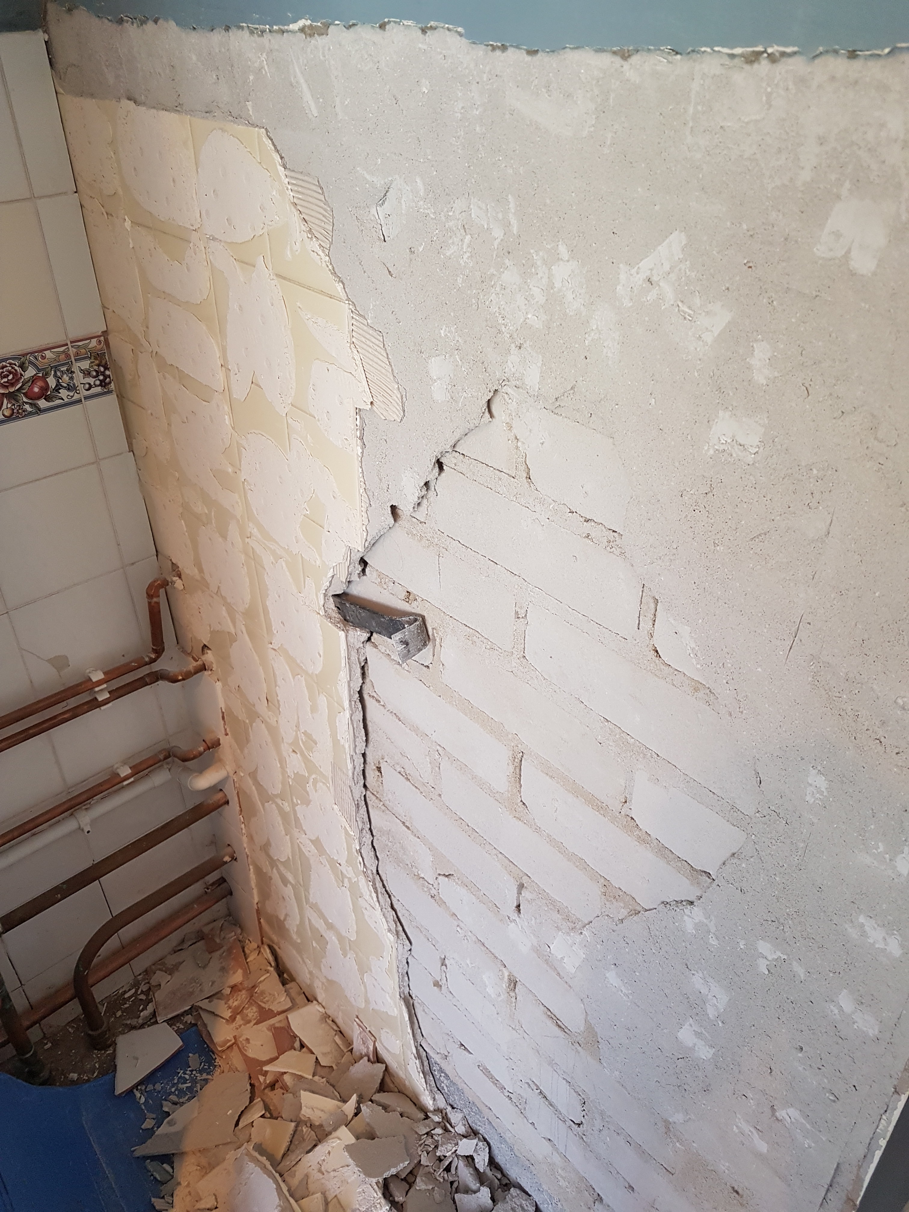

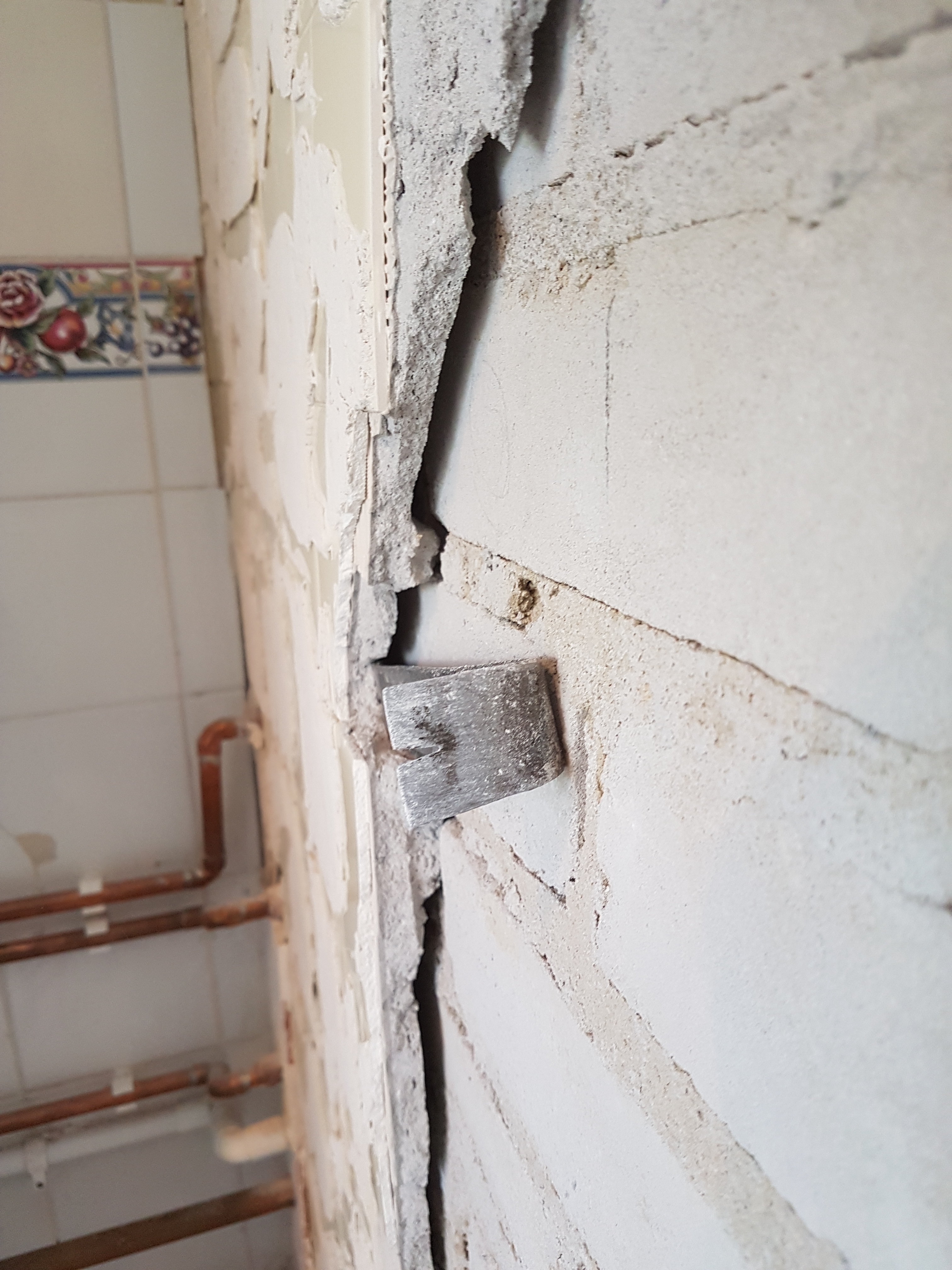

The last bathroom I did was alreadty tiled and the customer asked if I would tile over the top, (they were happy for me to do that!) but I didn't want to take a chance.
Turns out, there were already two layers of tile, the second was well stuck to the first but the first layer came off in sheets, there was more grout stuck to the plastered walls than adhesive, and there wasn't much of that!
