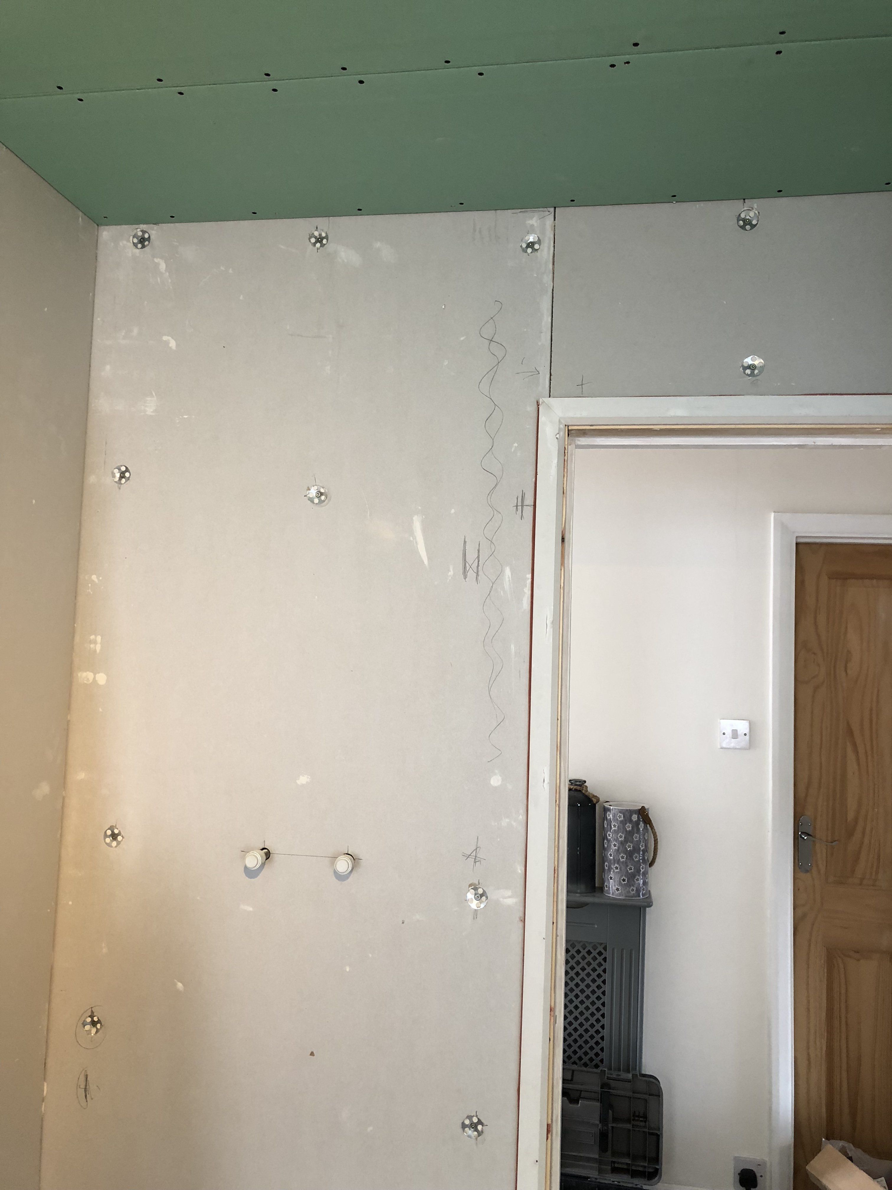

This was done on a skimmed wall. Quite a few fixings.
The washers were recessed, filled with adhesive and the wall was then tanked.
