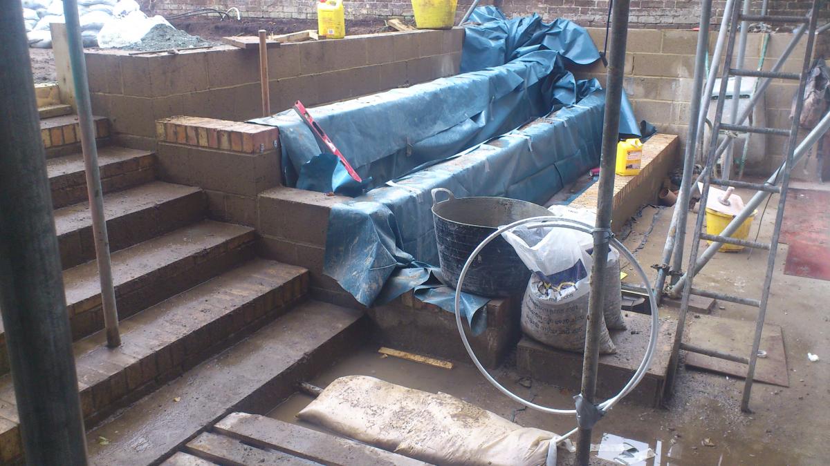

Tony I price it by the format size, and then how many I expect to get done in a day. so for instance it could be 10 stones in a day @ 900x400= 3.6m2 a day. Depends how fast you are at doing this type of work.

lynn, i think hes showing that he has a couple of 1mm yellow packers under his level and level still reads falling a bit.my eyes not that good to be fair but looks that way .Sorry I got to say something, and its this. Tony where is the water going to run off to? from what I can see there is no minimal fall on those treads. This is an exterior job yes?

looking good tony .
good to take the saw marks off front face of tread before fixing riser if they come flush to nosing from underneath.
