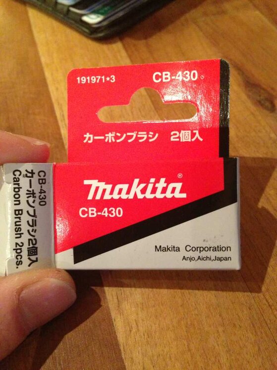

Jonny, don't bin it, mines packed in & I changed the brushes on it & it's working as good as ever now.
Pick brushes up for £5.

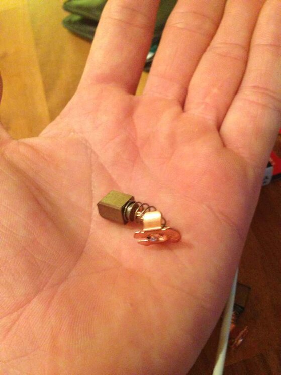

Jonny, the brushes are carbon & they wear down quickly.
There are 2 black caps on the side of the grinder, unscrew them & pop the brushes out & you will see how much they are worn.
I bought a replacement body & had my old grinder sitting in the garage for ages then saw something about brushes & swapped them over & it worked straight away.
Bought two sets for £10 through Toolchest direct. (I think)
These are new.
