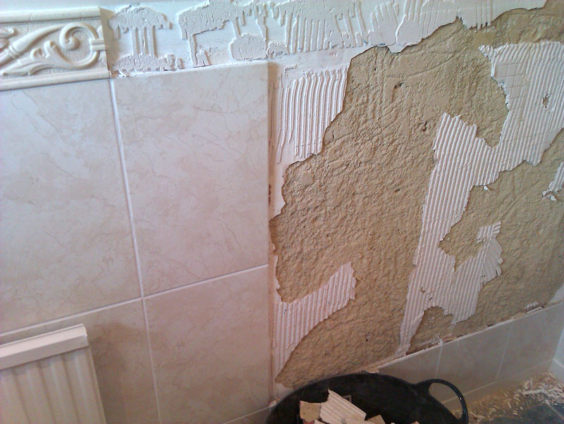

Removed old tile today and it took the skim coat (?) off the wall with the tiles, leaving the sandy brown layer, with concrete block/brick behind it.
Questions:
  1. What is the brown layer exactly?
  2. If I intend to paint one of the walls, can I just skim coat it with something, sand, prime and paint? If so, with what?
  3. For the walls I'm tiling, I assume skim coat = bad, so how about if I mechanically fix 12mm Hardiebacker and tile onto that? (12x18" travertine - heavy)
  4. Assuming Hardiebacker, do I have to get every bit of old adhesive and skim coat off or can I leave the bits that are firmly attached and apply adhesive, then hardiebacker then screws?
Thanks
Daz
I'm deffo no expert on this but it could well be a sand / cement render that has been applied to block work and then skimmed. If the skim coat has blown, then get as much off as you can. This should easily detach with the use of a scraper.
If it is sand / cement then it will be absolutely fine to tile to. Just prep it with a couple of coats of acrylic primer according to the instructions on the bottle. I would use a cement adhesive and not tubbed ready mix too :thumbsup:.
Daz
rsb123
It doesn't crumble off the wall easily, most of it is fairly solid and takes a good whack with a cold chisel to knock it off. But it's not solid as cement and I don't feel 100% comfortable attaching heavy tiles directly to it even using Mapei Keraflex Maxi. So I'm still thinking cement backer board screwed to solid wall (i.e. screws through browning into block).

If the back ground is brick or block work it would be a browning, if it was a plasterboard or a low suction (concrete or a surface coated with a pva) back ground then bonding would be applied.
MG, your talking a lime mortor background on laths and a lime finish which can be very powdery..
